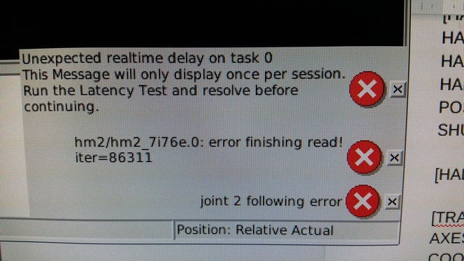

I'm new to LinuxCNC. I try to use it for an Emco Compact 5 (CNC) Latthe, where the existing electronics were destroyed.
For this, I got a Mesa 7i76e board.
In PncConf, I selected Latthe and the board and kept everything else on default, as I have no clue yet what I should look for in the wizard.
So now I have my ini and hal file.
I connected one (open-loop) stepper driver and stepper motor, just to see if it would turn while running the gcode "EMC2 AXIS", and it does! (I think it is a bit strange example gcode for the lathe configuration, but it lets me nicely try this.)

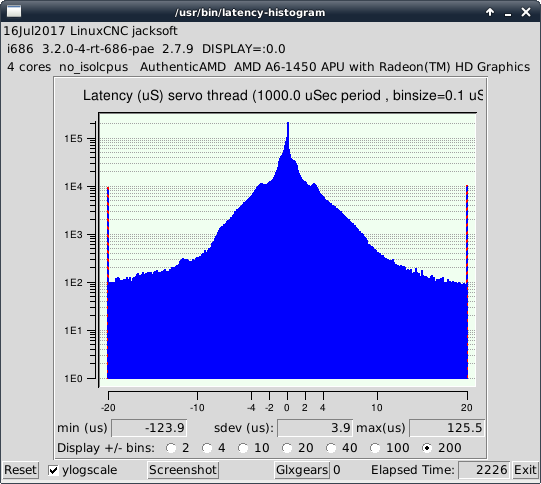

However I randomly get these errors (all four at once):
1.
Unexpected realtime delay on task 0
This message will only display once per session.
Run the latency Test and resolve before continuing.
I run it, but running that doesn't resolve it. Maybe I have to do something with the vales, but it doesn't tell what to do with each reading.
For me it not really a helpful message.
2.
hm2/hm2_7i76e.0: error finishing read!
iter=312321
Honestly, I have no clue what this tells me.
3.
Joint 0 following error
4.
Joint 2 following error
I couldn't find a solution for the joint following error. Somebody solved the same error, but didn't tell how he did it.
After this nothing works anymore, except quiting LinuxCNC.
The PC is not particular fast (A Zotac ZBOX Nano 320, AMD 1GHz)
What could be the problem of all these problems?

Jack, I had a bit of this happening when I set up my 7i76e.
These settings in my .ini file were the what was causing it for me..
Increasing these I mean
MAX_VELOCITY = 300
MAX_ACCELERATION = 1500
STEPGEN_MAXVEL = 700
STEPGEN_MAXACCEL = 2000Increasing these I mean

After testing, I quickly got the same messages, except joint 0 following error was not there, only jont 2 following error.
And of course the other two errors. They all pop-up at the same time.
Could my barebone PC be too slow?

It appears that your main issue is that your host PC has poor latency
All subsequent errors are caused by the real time delay, the "error finishing read" means that LinuxCNC sent out a request to the 7I76e to read data but nothing was returned before linuxCNC timed out the request and gave up. The
following error happens because of lack of up-to-date position feedback
Have you run a latency test or better latency-histogram on your PC?
To do this, type
latency-histogram --nobase
And run it for at least an hour or so while doing other normal computer things
Are _all_ power management options disabled in the BIOS?
This means all "cool and quiet", C-state, turbo speed options etc

After 5 minutes of running the latency test, the bold values are:
Servo thread (1ms) 78998607
Base thread (25us): 123410
Attached the ini and hal file.

The I7i76e does not seem to have a WiFi on-board, as far as I can see, and the manual doesn't talk about WiFi.
Because I didn't configure WiFi, it shouldn't be the problem, right?

This is _not_ a hal/ini file issue, this is a latency issue our your PC which can likely
be resolved by BIOS setup
Try running the latency-test or latency-histogram with the base thread disabled
as the stock base thread period will cause issues on your relatively slow PC
preventing accurate latency measurement
For the latency histogram you do this with:
for the latency test:
latency-test 1ms 1ms
- JackBerkhout

That looks OK though not great
Have you disabled all power management options in the BIOS?
Have you tried running normal PC applications, moving windows around, playing videos etc while the latency test is running?
Also what Ethernet hardware is used on your PC? (may need the results of dmesg to check)
Also as rodw mentioned ,disable any internal WIFI cards as some of those are notoriously bad for latency
(Broadcom anything is a disaster)

Thank you very much PCW!!!
Maybe I found something.
The Ethernet interface in the barebone didn't work after LinuxCNC installation, so I used a USB-to-Ethernet adapter.
I removed it and tried the Ethernet port again and it now works, probably because of updates.
Such an adapter is far from ideal, I guess.
I disabled the power options in the BIOS, but could not find the WiFi disable option.
Testing sofar, that seems to make the difference!
Kind regards,
Jack.
