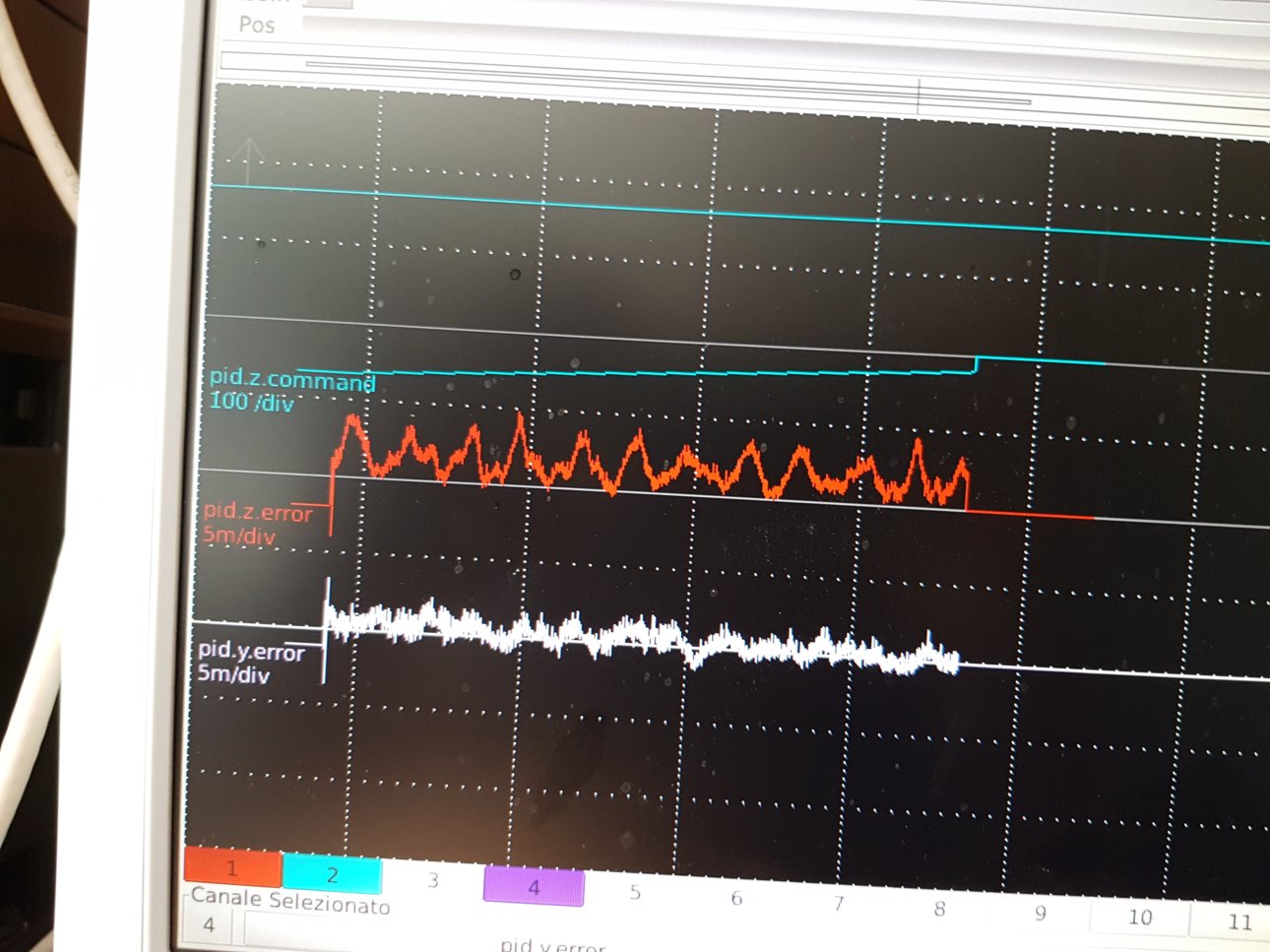

Hello
finally I mounted everything, calibrated the pid only with P, D, FF1, connected encoder -velocity to pid.n.feedbak-deriv as said Pcw.
but it seems to me even more noisy.
I was in doubt ... output scale must be 1? I saw that others put 10 but maybe for analog drives.
the error as you can see from the picture is within 0.005 mm at F200 it seems good to me.
thanks for your help
Mauro

- Posts: 19311
8 years 6 months ago #109706
What is your encoder/resolver velocity scale? If the encoder scale is positive then the velocity scale should be positive (probably +1) but if your system requires a negative velocity scale then you need a negative velocity scale too.
(I was caught out by exactly this a couple of weeks ago)
Replied by andypugh on topic 7i40hv pid
billykid wrote: connected encoder -velocity to pid.n.feedbak-deriv as said Pcw.
