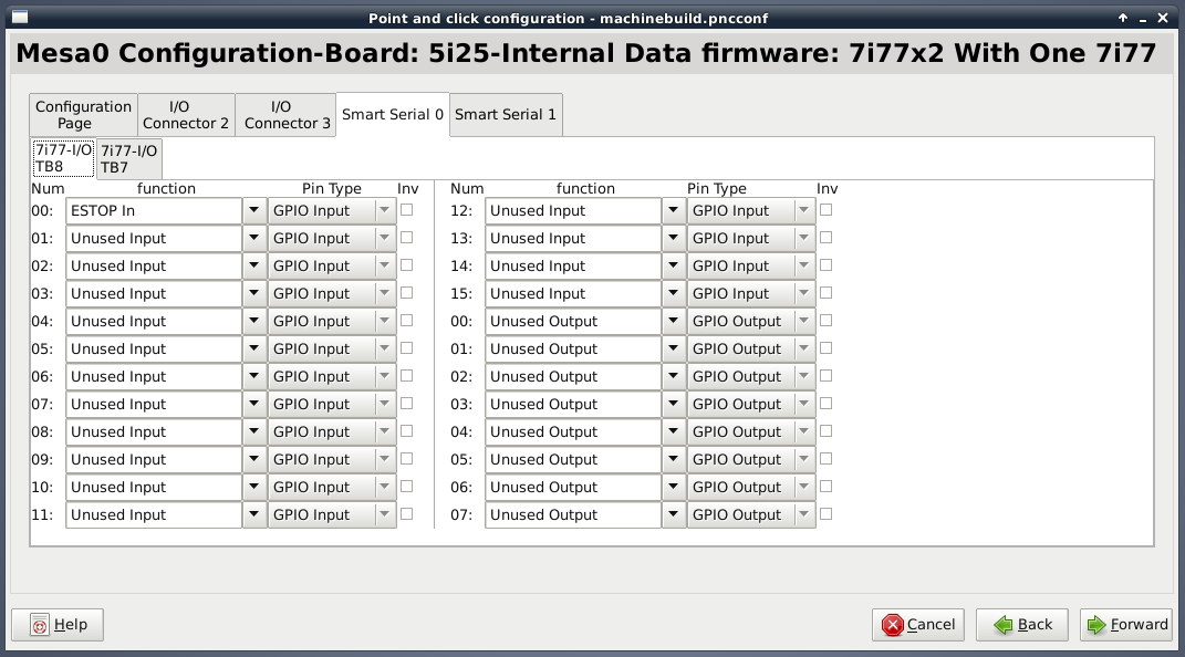

12 Oct 2017 23:01 #100289
by Lcvette
Replied by Lcvette on topic 7i77 terminal numbering question?
right but i saw a screenshot of the mesa configuration that showed them starting at 0 in the software.. I would like to keep everything from the schematic to the software the same for easy troubleshooting.. is that numbering in the software not correct?
so confused
so confused

12 Oct 2017 23:08 #100292
by Lcvette
- bevins
- Posts: 1947
- Thank you received: 338
12 Oct 2017 23:08 - 12 Oct 2017 23:11 #100293
by bevins
The pins on the board start at 1. The inputs in the software start at 0,
Look in the 7i77 manual on page 11.
TB8 pin1 => input0
TB8 pin2 => input1
Replied by bevins on topic 7i77 terminal numbering question?
so confused
TB8 pin1 => input0
TB8 pin2 => input1

12 Oct 2017 23:09 #100294
by Lcvette
Thank you wouldn't it seem to make sense to have them be the same??? lol
- bevins
- Posts: 1947
12 Oct 2017 23:14 - 12 Oct 2017 23:15 #100295
by bevins
No,what are you going to do with output 0 then?
Board terminal numbers are just that. Has nothing to do inputs outputs. Just a label so you can relate them to whatever is on those pins, so you know where to connect wires.
