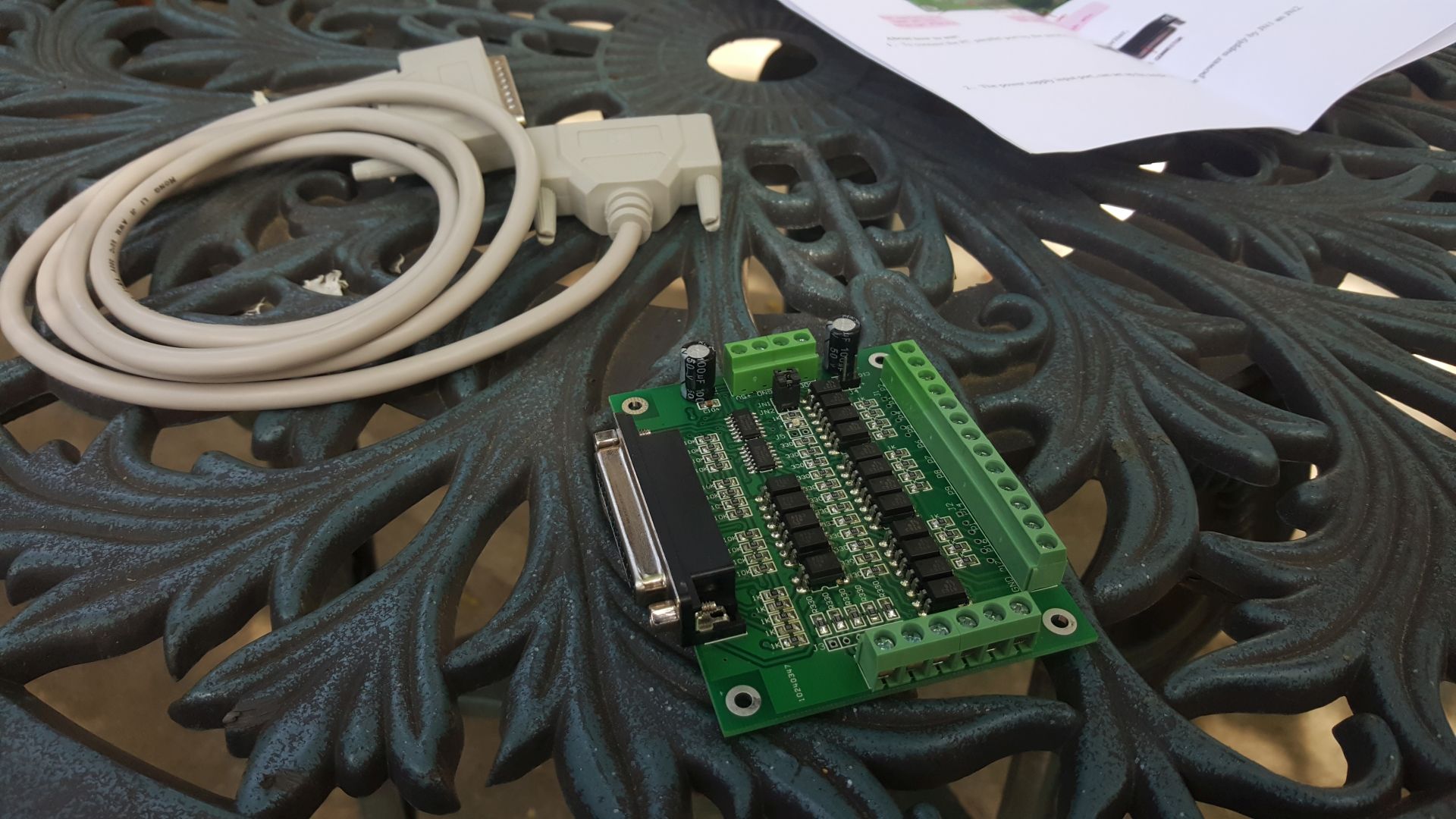

I was looking for a parallel port optoisolator /optocoupler card, and found this one ebay.com for something like $20.
The (Photo below) card came in a few weeks, packet delivery from China.
The card came in an envelope protected fairly with few layers of bubble-wrap. Included with it were a 1 meter parallel cable, and a 2 page color instruction. There is a bit of inscrutable Chinese/English about the power supply, but I think I will get it sorted out. I suspect that it does require +5v to run. Oddly, I may power it from a modified USB cable : |
Without the DB25, the board measures 70mm x 90mm. The mounting holes are 60mm x 80mm, and will accept a 3mm screw.
The card has 12 outputs and 5 inputs, which appears to match LinuxCNC.
The screw terminals and DB-25 connector are unremarkable.
There appears to be 17 opto-isolators. I am not sure what the extras are for. I would rather the optos are socketed, rather than surface mounted as they are.
There are 2 Schmidt trigger chips, which appear for cleaning up the digital signals.
It may be a few weeks before I get a computer going to test it, but I will follow up on it here.

Powering them from a USB is a nice idea, i always do that.
Those BOB are fairly slow as they use cheap optoisolators so in some cases you might be better of without it.
There are 17 optos as it needs 12 outputs and 5 inputs and all of them are isolated.
You are correct about the Schmidt triggers.

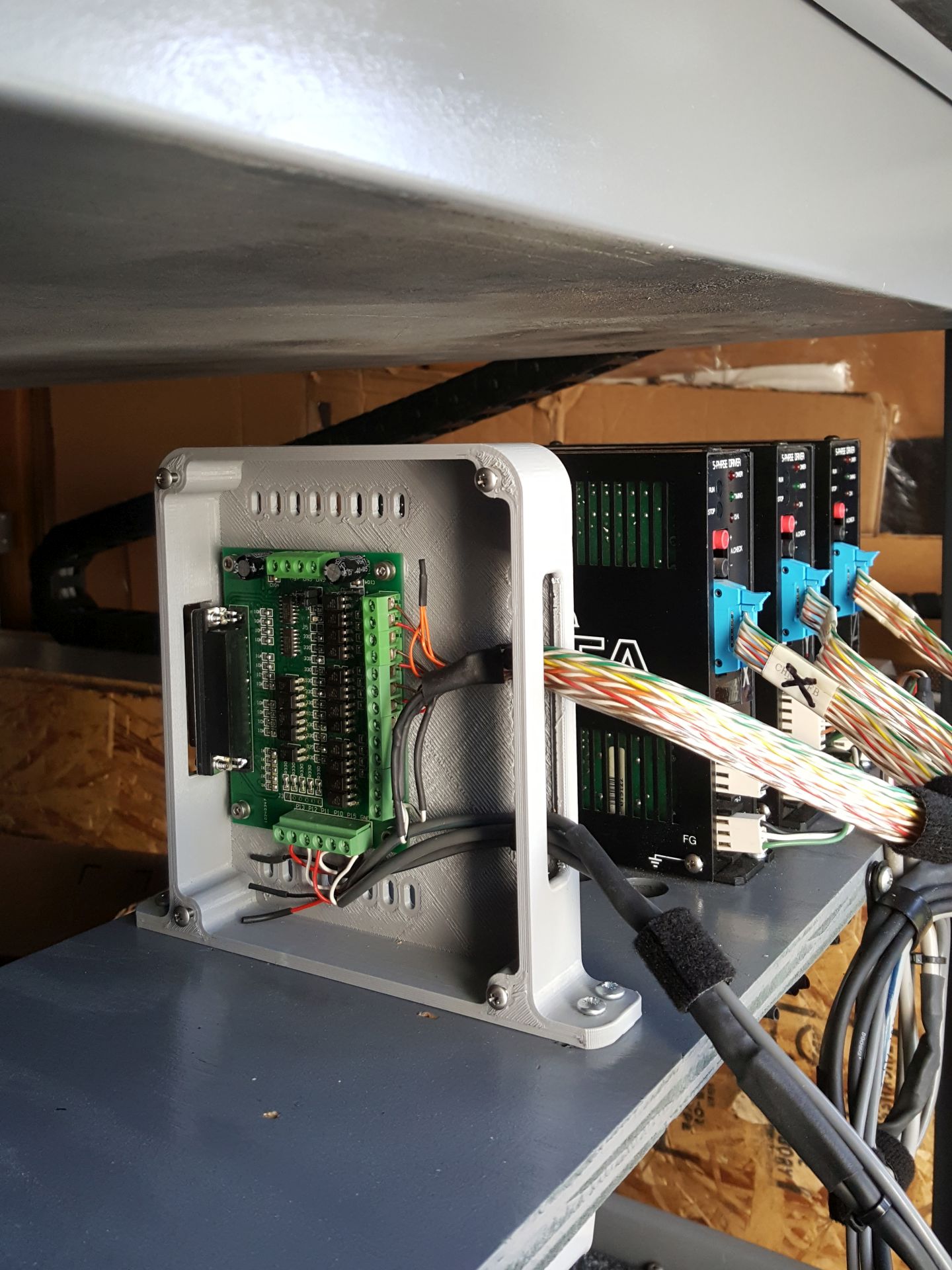

I drew up a 3D printed enclosure for the board. If the board works okay, I will upload the stl file to thingiverse. If it doesn't I wouldn't want to encourage anyone.
Anyway, the box is simple. It just protects the board, and gives a lot of places to ziptie wires in place so they are strain-relieved. That's what all those little slots (and the ones you can't see) are all about. The cover is printing, now.
I am still hopeful that this board will be fast enough for my machine. I only have a long-style Nema23-sized 5-phase y-axis motor to move a 3+ foot wide gantry, so I don't expect blazing performance to begin with. The motor can move the gantry at reasonable speeds and acceleration, but even with smooth acceleration at high acceleration rates, I can stall it. I left a space for an A axis. One never knows.
I used my RDL Adruino stepper utility to test the access and move it around for working on it.
Looking forward to all the axis moving at once : )

Now, I someone might give me a laptop with parallel port on it, so I'm going to try that.
No, the chains were takeout. This machine is made from scrap wafer-fabrication parts. Even the wire is used : )
Though a lot of the linear stuff is NHK : )
The chain was made from two segments. I didn't have enough links for the small one, but I found 10 links on ebay for $5. : )
I will post a current pic of it this weekend.
