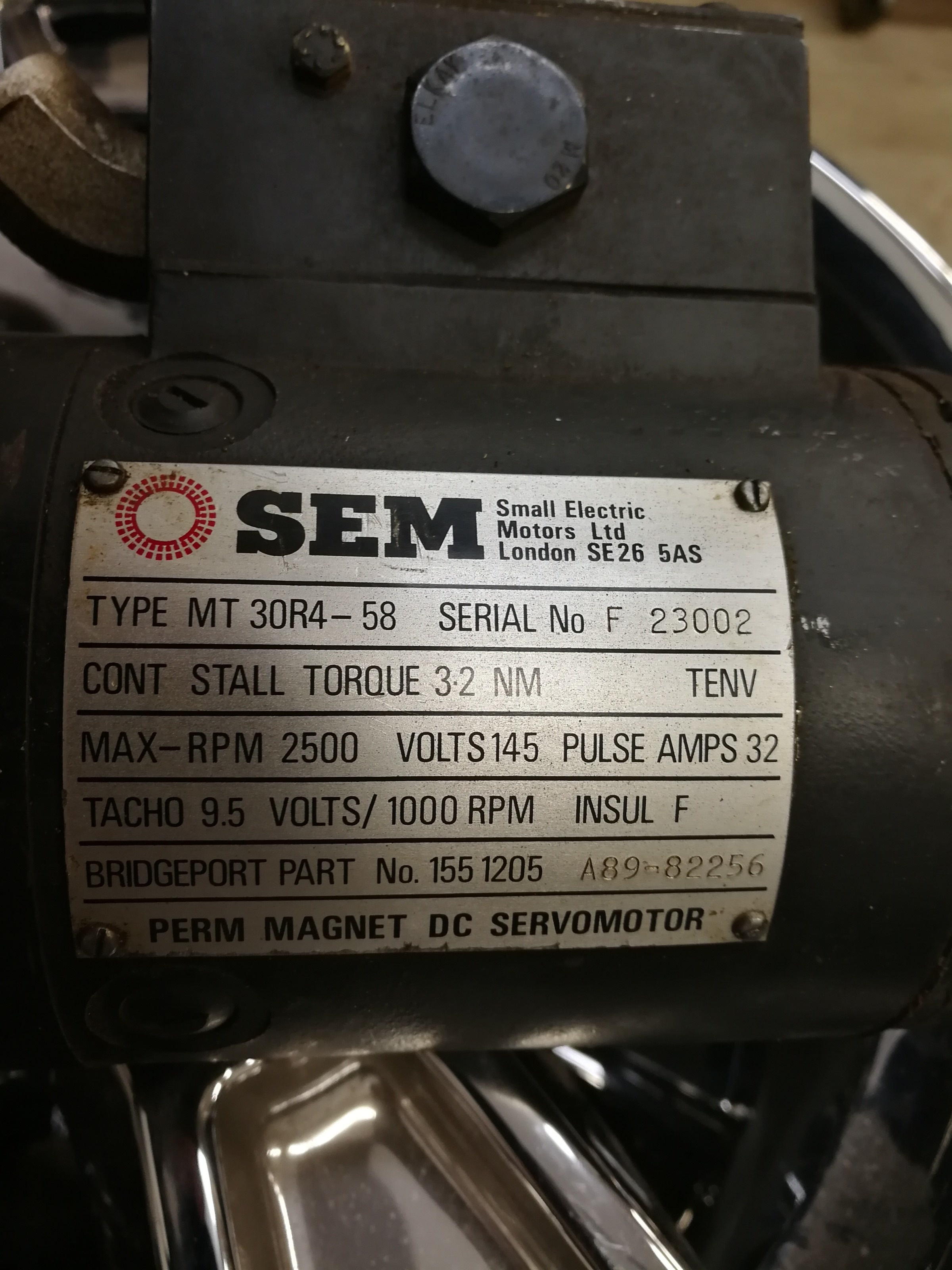

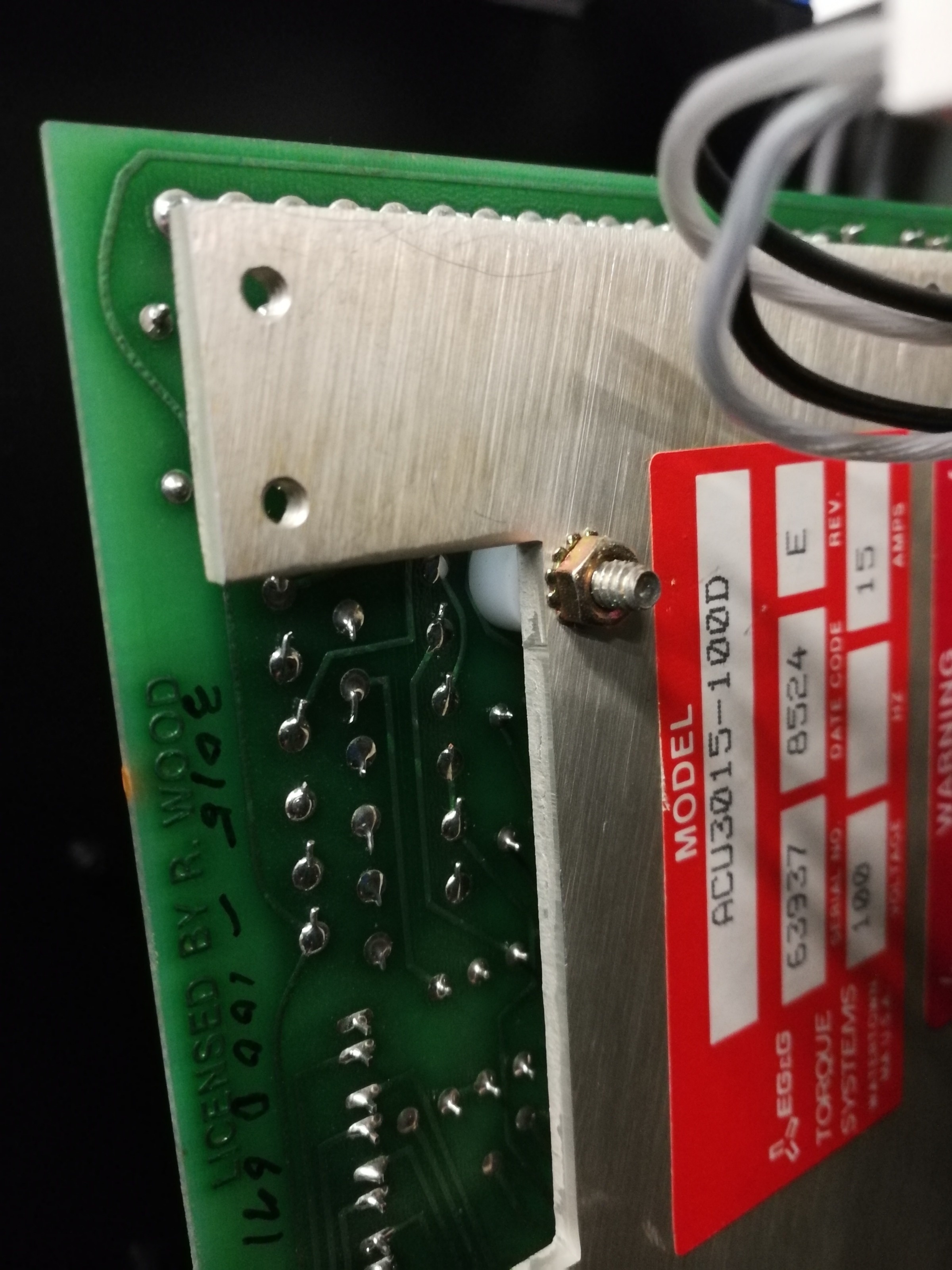

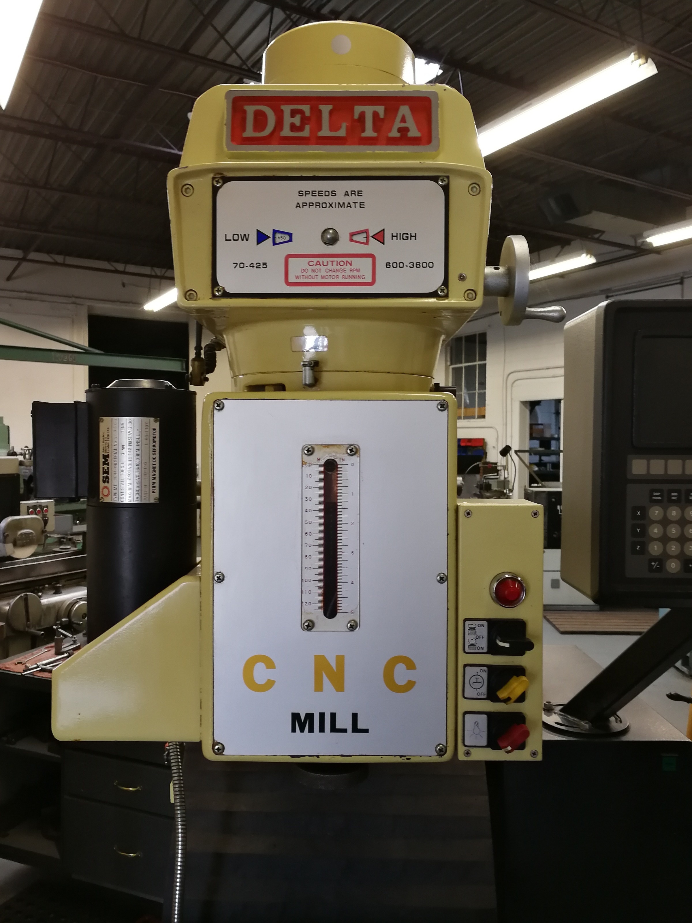

Hi guy's, I was hoping someone could help me out, I just purchased an 80's Delta Vh-3600 cnc knee mill and the controller is bad. It is an Anilam Crusader M. I want to run Linuxcnc on it but I want to reuse the SEM servo motors type MT30m4-59 and the drives that are EG&G Torque Systems servo drive model ACU3015-100D, the servos are DC brushed 142 volts and 2400 rpm. My question is can I make these drives work with the Mesa 5i25 and the 7i77 cards. Any help would be greatly appreciated.

Replied by PCW on topic EG&G Torque Systems servo drive model ACU3015-100D
Probably, AFAIK those are standard analog velocity mode servo drives,
so if the drives are OK a 7I77 should drive them.
Do you have any documentation on the drives?

Thanks for the reply PCW, I don't have any documentation for the drives, do you know if I would need to install encoders on the servos, I'm pretty new to this stuff.

I just checked and the mill does have the linear scales on X and Y but I don't know if there is something on the Z axis. How would the linear scales work using the Mesa boards, do you have any idea.
They should be normal quadrature encoders so connect directly to the 7I77
