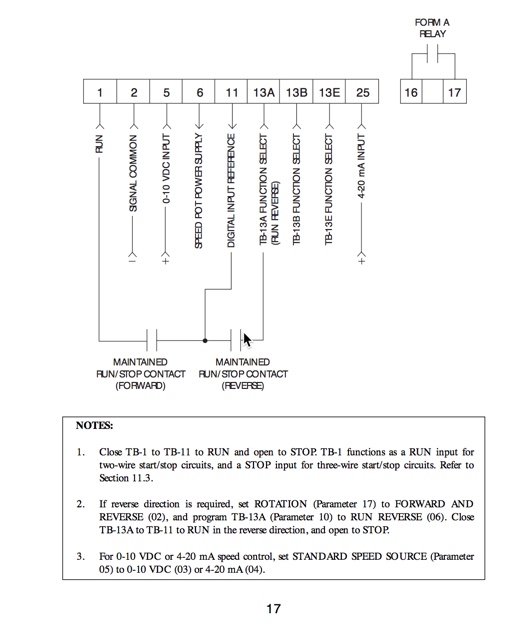

I'm converting a CNC Masters Baron Mill... I have the steppers wired but am confused on how to wire the spindle to the 7i76 board...
With the CNC Master's control board it used the first six pins.. Here's the wiring diagram from the manual
Any help wiring the tb4 pins to the VFD would be a huge help...
thanks
thanks

ok... I tried this wiring :
Tb4 - leeson
1 - 2
6 - 1
3 - 5
2 - 11
7 - 13a
If I enable the spindle in LinuxCNC I get nothing... so I tried jumping pins 1 to 11 on the leeson and I get forward motion... If I jumper 1, 11 and 13a I get reverse... now I need to figure out what to do next... not sure how to configure LinuxCNC to do this...

I would wire it like this:
Note that unless you can program the VFDs pin 13 to be a direction pin rather than "run reverse",
an external relay may be needed to get bidirectional control.
Also I am assuming that the digital input reference is a positive voltage. if its ground and the run input is a positive voltage you will have to reverse TB4 pins 5 and 6
Code:
7I76 LEESON FUNCTION
TB4.1 2 ANALOG COMMON-
TB4.2 5 ANALOG SPEED CONTROL VOLTAGE
TB4.3 6 ANALOG VOLTAGE SUPPLY (+10V)
TB4.5 1 SPINDLE ENABLE - (RUN)
TB4.6 11 SPINDLE ENABLE +
Last edit: 8 years 4 months ago by PCW.

Hi buffcleb,
I also use a 7i76 on my machine, but i have a different VFD.
The spindle enable and direction on the 7i76 are open-collector outputs,
not sure but i think you have to connect TB4 Pin 5 and6 to VFD pin 1 and 11,
and for reverse TB4 7 and 8 to VFD 13a and 11

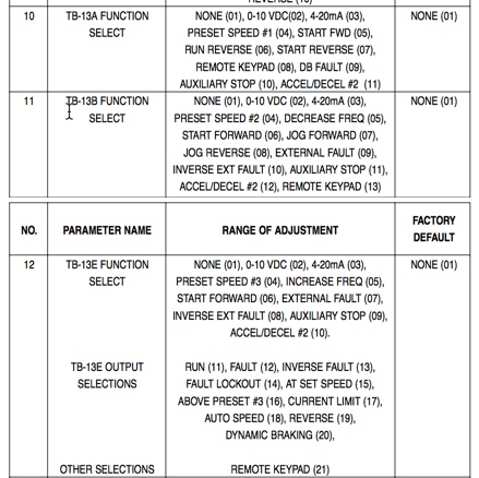

This worked... thank you... tested it to full rpm and verified it with one of those laser meters... Here are the programable functions on the VFD...
None of those seem to be a direction... so I'm going to have to figure something out...
Replied by buffcleb on topic 7i76 spindle wiring to a Leeson Speed Master VFD
PCW wrote: I would wire it like this:
Code:7I76 LEESON FUNCTION TB4.1 2 ANALOG COMMON- TB4.2 5 ANALOG SPEED CONTROL VOLTAGE TB4.3 6 ANALOG VOLTAGE SUPPLY (+10V) TB4.5 1 SPINDLE ENABLE - (RUN) TB4.6 11 SPINDLE ENABLE +
Also I am assuming that the digital input reference is a positive voltage. [strike]if its ground and the run input is a positive voltage you will have to reverse TB4 pins 5 and 6[/strike]
