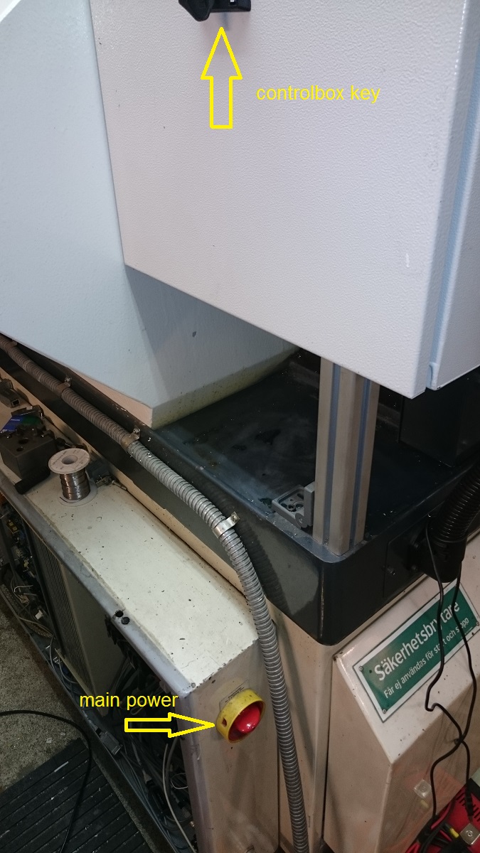

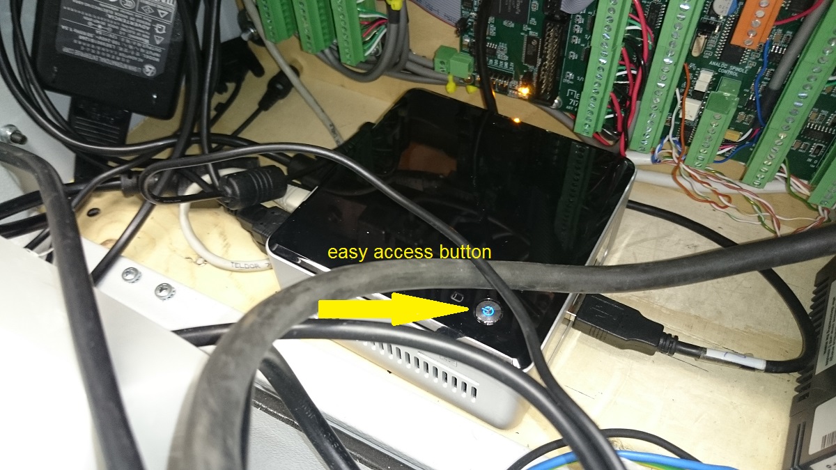

As in subject, is this possible?
Need to fix a way to start the PC as it is inside a control cabinet. Earlier PC I soldered wires to the start switch but this NUC5PPYH is like Fort Nox = can not find a way to lift out the motherboard.
Same with the BRIX but there I managed to solder cables to start switch.

Did a search for WOL on that type of NUC and it seems not to be the case.
I will go to do this manually, just open the door to the cabinet at the same time I switch on the main power to the lathe, no big issue just convenient to have remote start.

03 Jul 2018 13:14 #113337
by tecno
Replied by tecno on topic Can 7i76e perform a Wake on LAN to my NUC?
- yrsiddhapura
- Posts: 134
- Thank you received: 5
29 Sep 2018 03:20 #118170
by yrsiddhapura
Replied by yrsiddhapura on topic Can 7i76e perform a Wake on LAN to my NUC?
It may help you.
www.intel.in/content/www/in/en/support/a...007309/mini-pcs.html
That's what i had plane for my project. To wire up external power switch to Intel NUC and use NO element and connected it to CNC ON push button.
