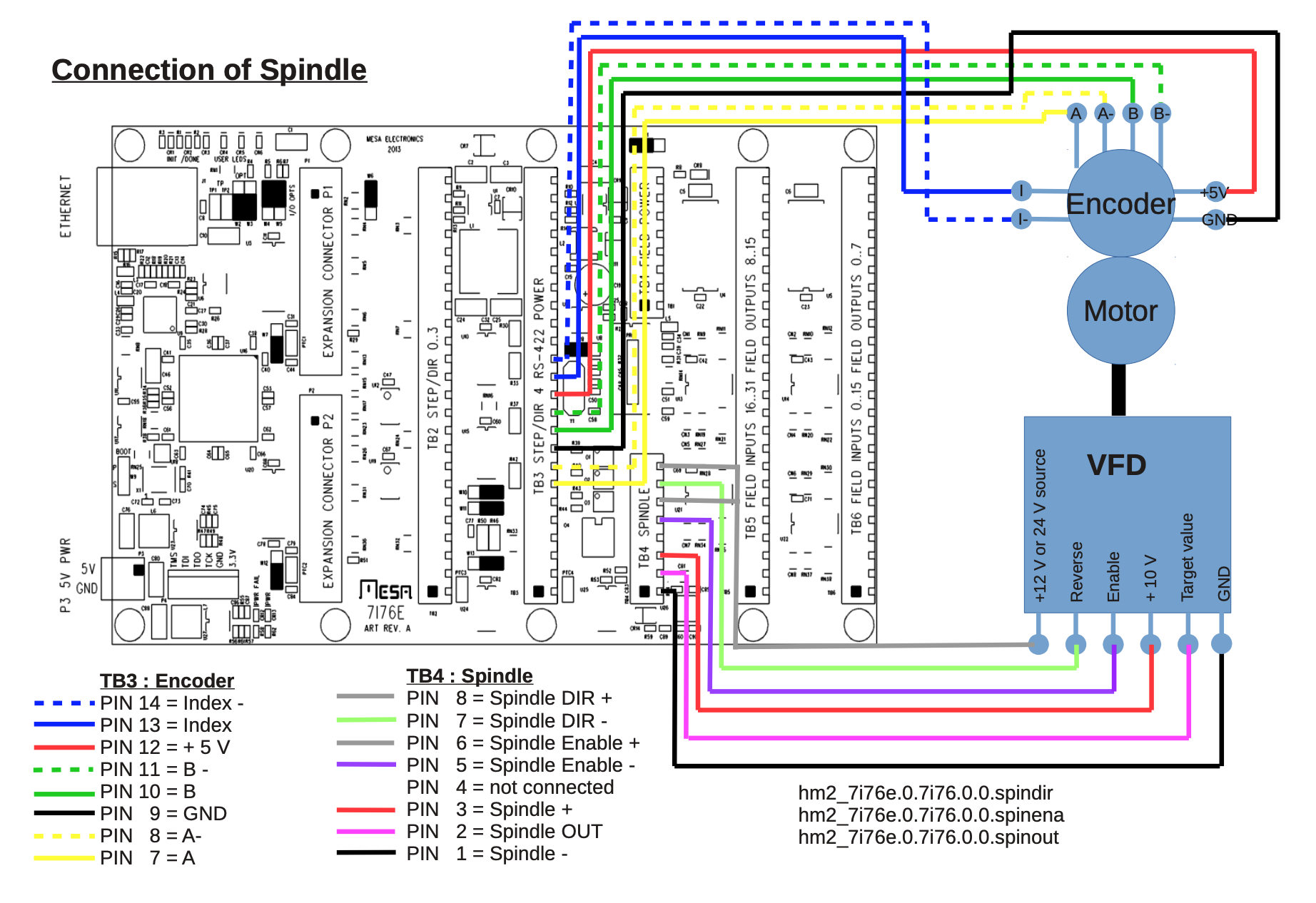

2.2kw VFD Spindle wiring to Mesa 7i76e

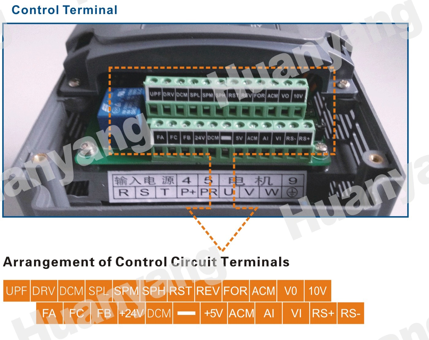

+10 to Pin 3
VI to pin 2
ACM to Pin 1
FOR to Pin 6
REV to Pin 8
DCM to Pins 7 and 5
Then Configure the VFD
PD001 = 1
PD002 = 1
PD044 = 1
PD045 = 5
VI to pin 2
ACM to Pin 1
FOR to Pin 6
REV to Pin 8
DCM to Pins 7 and 5
PD001 = 1
PD002 = 1
PD044 = 1
PD045 = 5

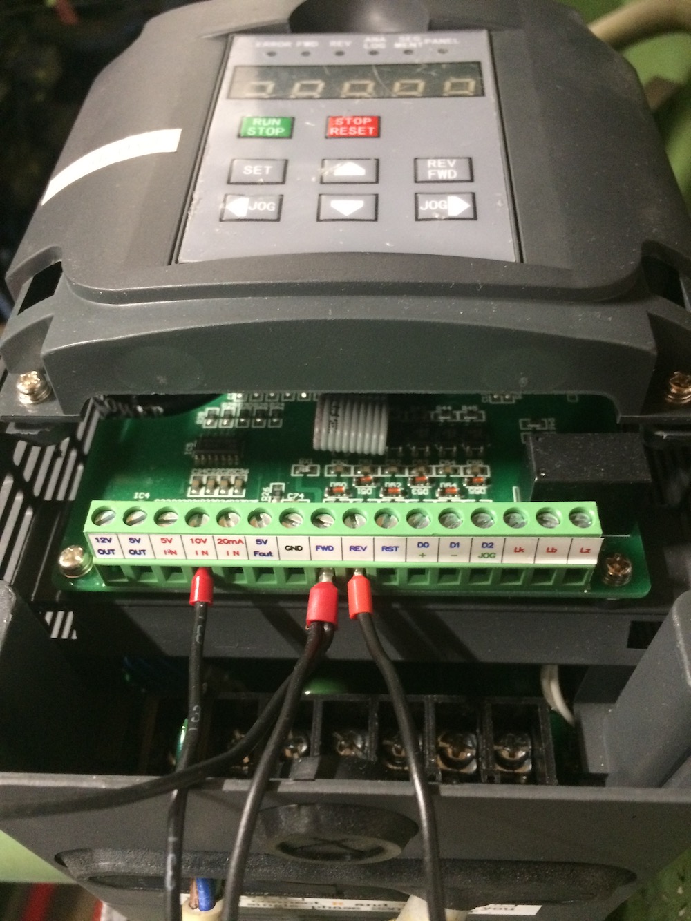

- Marki123
- Posts: 48
28 Feb 2021 13:53 #200418
by Marki123
Replied by Marki123 on topic 2.2kw VFD Spindle wiring to Mesa 7i76e
Hi, i have a HY02D223B Ver.2 i think. Did anyone have an idea how to connect them right to the 7i76e? Or would it be better to only work with the RS485 Modbus

- Hakan
- Posts: 1317
- Thank you received: 453
28 Feb 2021 20:45 #200461
by Hakan
Replied by Hakan on topic 2.2kw VFD Spindle wiring to Mesa 7i76e
I agree on Modbus. But it seems from a quick search that the "ver 2" is a clone that lacks Modbus www.kronosrobotics.com/hy02d223b-vfd-type-2
Follow Andy's wiring a few posts back,
where Andy has ACM and DCM you have only GND,
and you have +12V instead of +10
