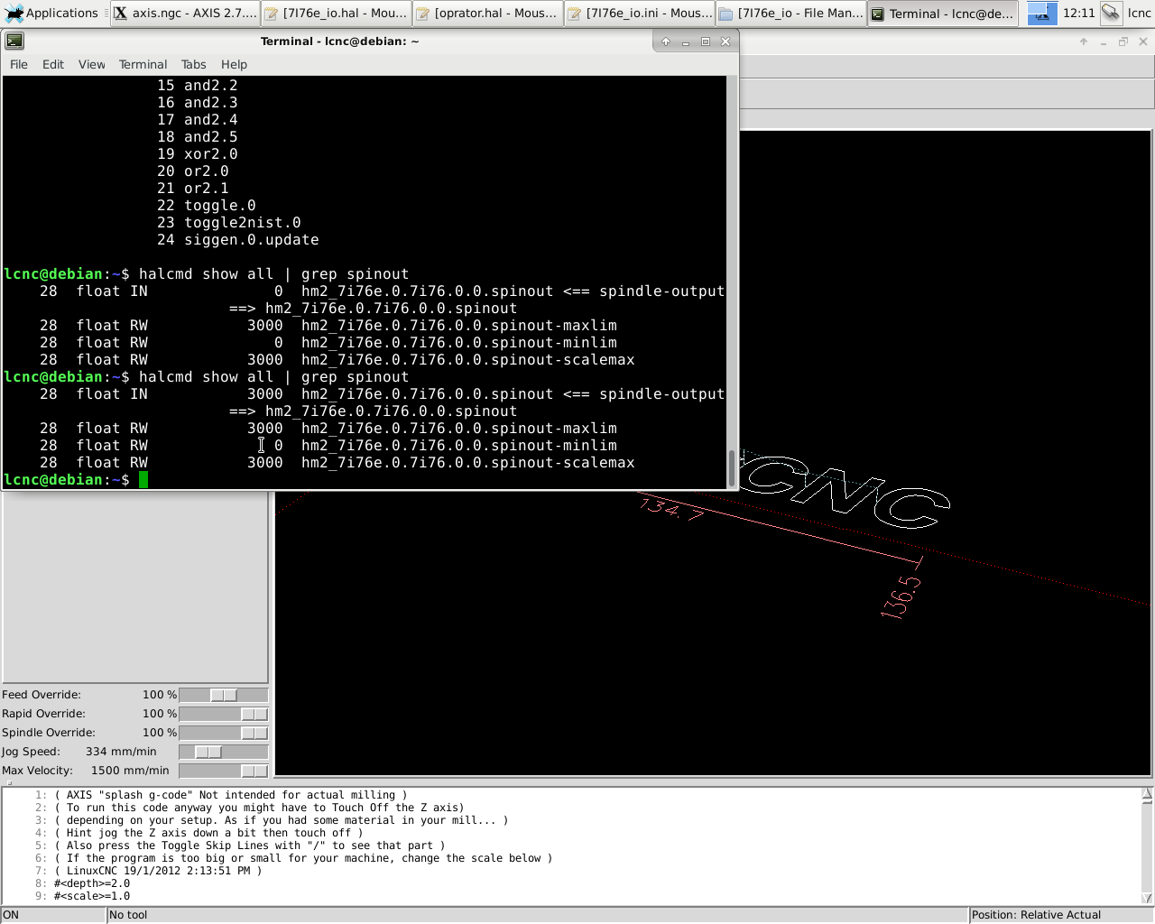

13 Feb 2019 14:17 #126343
Replied by PCW on topic Need Help for mesa 7i76e setup with linuxcnc
Did you measure the +10V? (pin 3)
If you have 10V on TB4 pin 3, and 0V on TB4 pin 1
and hm2_7i76e.0.7i76.0.0.spinout = hm2_7i76e.0.7i76.0.0.maxscale
and hm2_7i76e.0.7i76.0.0.spinout_scalemax = hm2_7i76e.0.7i76.0.0.maxscale
Then the output should be 10V
If the voltage on TB4 pin 3 is not 10V the output should be the voltage on TB4 pin3
You can check these values when LinuxCNC is running with this command (ib a terminal window):
halcmd show all | grep spinout

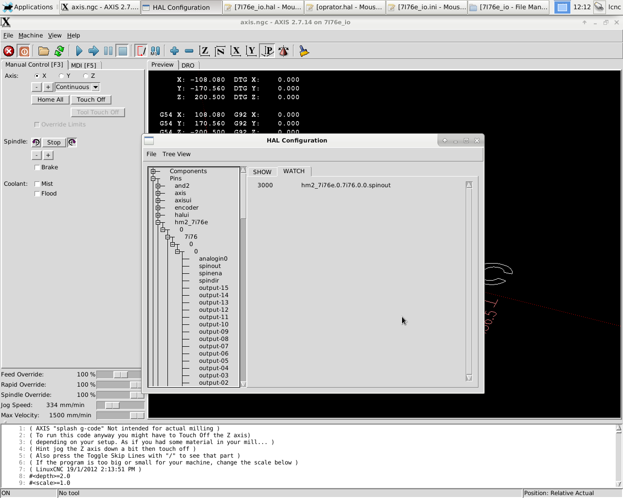

23 Feb 2019 07:52 #126990
by yrsiddhapura
Replied by yrsiddhapura on topic Need Help for mesa 7i76e setup with linuxcnc
Dear PCW
as following your instructions i had measure the +10V on pin3 of tb4 its shows 10.69V and still output on pin 2 is 7.69 to 7.99V(vary) here i m posting screen shots of command(You suggested) executed and HAL and INI files
And m also not able to set analogue in to spindle override i have programmed it in 'oprator.hal" (at very bottom)file could you help on this too actually it my very first project with linuxcnc.
regards,
yagnesh

- Posts: 18086
- Thank you received: 5321
23 Feb 2019 14:46 #127005
If you have ~10V on TB4.3, 0V on TB4.1 and LinuxCNC is commanding full scale, sounds like the 7I76E Analog output circuit has failed or been damaged somehow.
Did you measure 10.69 at TB4.3 when the output was ~7V?
I have seen cases where the VFD potentiometer power supply will not
supply the ~5 mA that the 7I76E analog circuit requires at full scale
