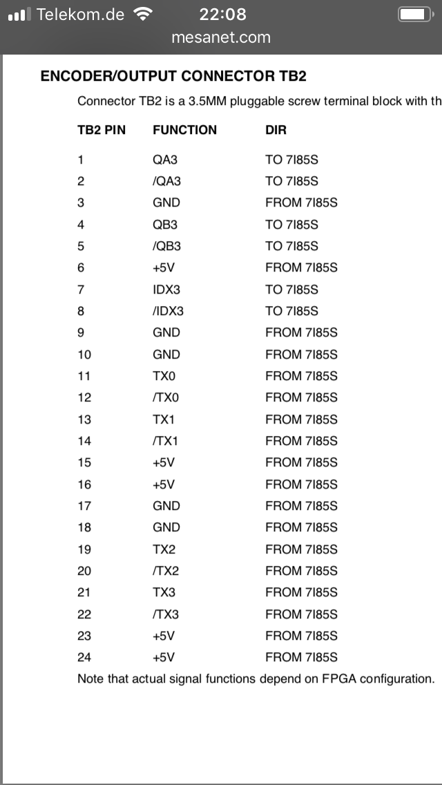

Hi Guys,
I have a 7i76e connected with 5 axes. Now it would be nice to have an A-axis. Can I connect the over my 7I85s? The description says that you can also 4 differential step + dir. Does anyone know which bitfile is needed and on which pins then the axes are to be found?
Thank you Christian

You want to use:
7i76e_7i76x1_7i85sx1D.bit
firmware for that combination.
This will give you a combined total of 9 step/dir channels and 5 encoder channels

- Posts: 18118
- Thank you received: 5336
19 Mar 2019 16:33 - 19 Mar 2019 16:50 #129005
Replied by PCW on topic 7i76e axis extension
The manual cannot really show the actual step/dir pins since they are dependent
on the firmware (they might be PWM pins etc)
You can determine the actual wiring by looking at the firmware pinout
(via mesaflash's readhmid command), but in this particular case, its pretty
straighforward:
7I76 --> Stepgens 0 through 4
7I85S:
TX0 = stepgen 5 step
TX1 = stepgen 5 dir
TX2 = stepgen 6 step
TX3 = stepgen 6 dir
etc

- chris@cnc
- Posts: 529
- Thank you received: 140
19 Mar 2019 16:40 #129007
by chris@cnc
Replied by chris@cnc on topic 7i76e axis extension
That explains a lot. I will try tomorrow. Thank you for your quick support. Greetings Christian
