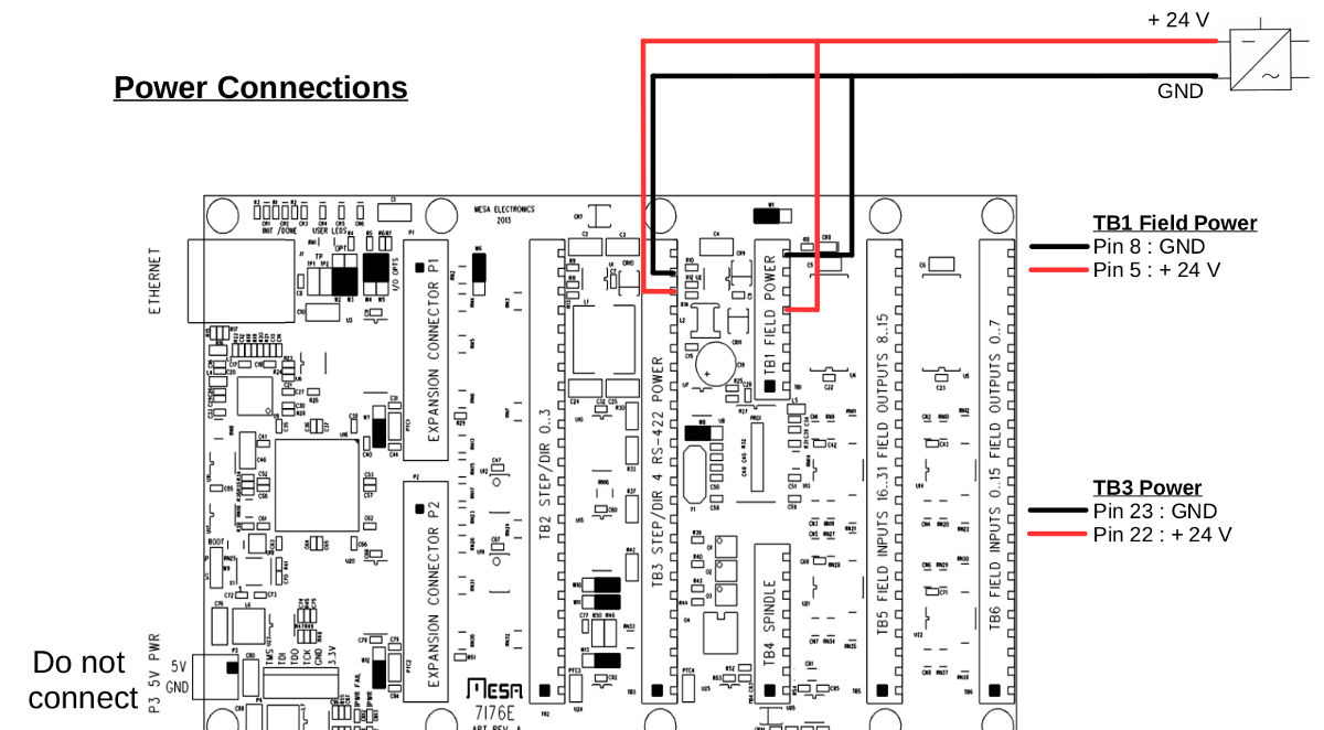

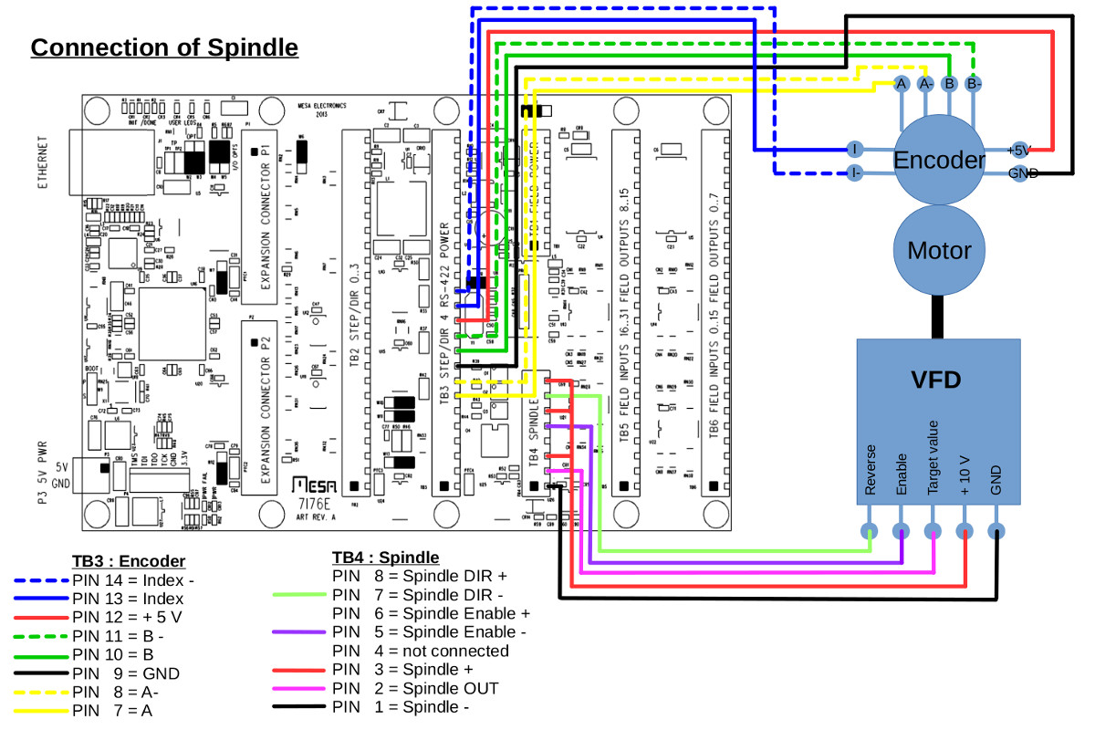

So, i did this before, but to make this more clear i have this question.
With my new servo spindle motor drive i got verious pins to use.
Two of them are for 0-10v analog controll. The pins called AS+ and AS-.
As far my knowledge goes, i assume that the driver does not 'give' 10v
Question
Is true that the Spindle+ Spindle OUT and Spindle- are a opencollector?
If so, that meens that i have to add 10V tot the Spindle+ from a external power source?
While im here, is it true if i connect my 24v on TB1 and on the TB3 Pin 23 and 22, that i don't need a external 5v power source?
25 Apr 2019 13:41 #131849 by pl7i92
Replied by pl7i92 on topic Spindle pins Mesa 7i76e + power source
hi
yes and yes
A: only 24V no 5V needed
B you need the external 10V
i added 2 images

25 Apr 2019 14:06 #131853 by Erikcnc
Replied by Erikcnc on topic Spindle pins Mesa 7i76e + power source
Thanks!
So where do i leave the ground from the 10v power source? on Pin 1 where also AS- from the servo driver goes to?
25 Apr 2019 17:30 #131872 by Mike_Eitel
Replied by Mike_Eitel on topic Spindle pins Mesa 7i76e + power source
STOP
The drawing is wrong!
There must not be a connection between annalog 10V pin the digital pins. This drawing is not actually.
Mike
The following user(s) said Thank You: Erikcnc

25 Apr 2019 17:56 #131873 by Erikcnc
STOP
Mike
Now I see that it's a different version then I have. Dir+ and Enable+ should be connected to a 12 or 24v power source right?
25 Apr 2019 18:31 #131874 by Mike_Eitel
Yes
