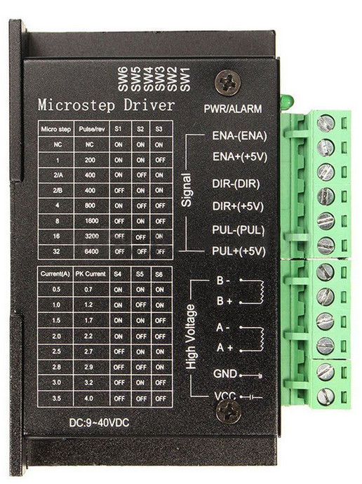

Anyone know where I can find legit tb6600s? It appears that most the sellers are actually sending the TB67S109AFTG chip and calling it tb6600.

Do those TB6600 self destruct or was it only the "all in one blue board" setups ?
10 May 2019 15:11 #133366 by pl7i92
Replied by pl7i92 on topic Driver Wiring DM320T
if you tell us here what mashine type MILL LATHe Printer Plasma ... you got
what size and what material you try to operate/mashine
it woudt be more to your benefit as we all here already do work with those mashines and know what you need
YOU got the best Controller as you can get and struggle on Driver lowest level
THE BEST STEPPERDRIVER you can GET is the REAL DM566 from Leadshine
if you need more Volts use the DM880
if it is Standard go for DM542H
all othars are tb6600
if you are in Europa -> BEST BUY
www.ebay.de/itm/Schrittmotor-Steuerung-S...-TB6600/302752862381
The design is called a LowRider2. Will be modifying the design to use a plasma torch. It's a relatively super simple and light gantry, from what I can tell, so I think that's why it gets away with these small motors. Will certainly just be a hobby machine.
Here's a slow moving example, I believe controlled by marlin on a 3d printer board:
4'x4' table. The torch handles up to about 1/2".
Between the seller and 2x price point I just figured those drivers were a step up from the tb6600 knock offs I find.
Thank you for that run down, great to know! I'm not looking for the best. We'll try the tb6600 knockoffs for a while. I know I splurged on the mesa but didn't want to roll the dice and waste too much time locating an old computer with a parallel port, the mesa seems to work on the old computer I already have. And I figured the mesa to be upgrade proof for a while. Mesa + thcad was still about the same or cheaper than other thc options I looked at alone.

For the record, per some some conversations with mesa, I'm switching gears and going with a 7i96 to save even a little more cash since I don't believe I could use all the io of the 7i76.
I'm looking forward to plasmac. I've already been tinkering with it. I feel like the thcad configuration is the last piece of the conceptual puzzle for me. If anyone were to write a layman's configuration walk through for the thcad I for one would most certainly buy them a beer or six. By the time I get this machine running I'm think I may have to put together a step-by-every-single-tiny-step build log just focusing on linuxcnc for the benefit of other newbies.
I decided not to place the order for the DM320T and ordered some more TB6600s. Or rather what someone is calling TB6600, we'll see.
