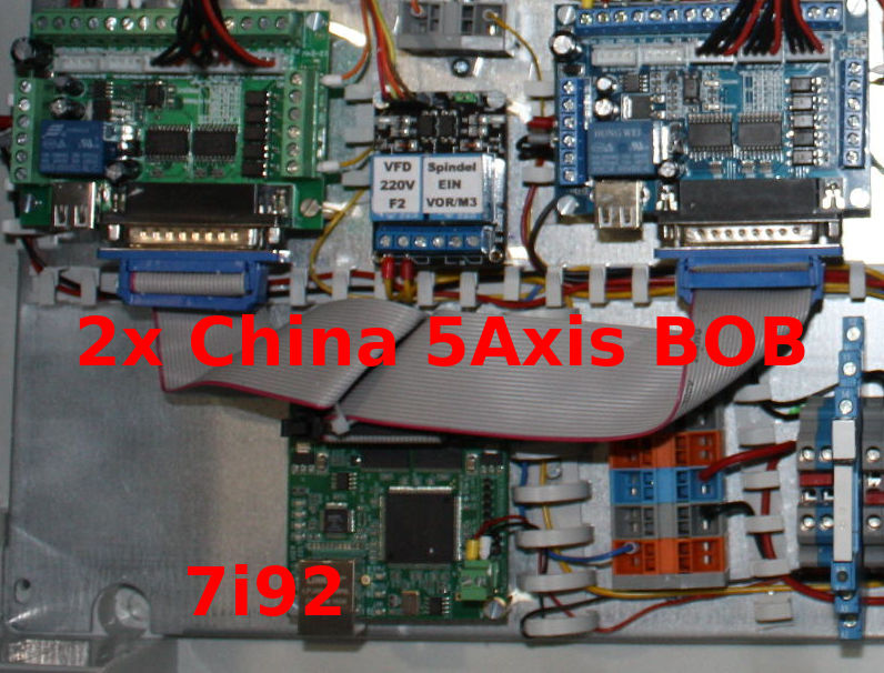

09 Aug 2019 17:52 #141803 by pl7i92
Replied by pl7i92 on topic Mesa Card Basics
and on a ethernet upgrade like 7i92 to china mach 5axis bob
loadrt hm2_eth board_ip=192.168.1.121 config="num_stepgens=3, num_encoders=0, num_pwmgens=1"
setp   hm2_7i92.0.stepgen.00.dirsetup        [JOINT_0]DIRSETUP
setp   hm2_7i92.0.stepgen.00.dirhold         [JOINT_0]DIRHOLD
setp   hm2_7i92.0.stepgen.00.steplen         [JOINT_0]STEPLEN
setp   hm2_7i92.0.stepgen.00.stepspace       [JOINT_0]STEPSPACE
setp   hm2_7i92.0.stepgen.00.position-scale  [JOINT_0]STEP_SCALE
setp   hm2_7i92.0.stepgen.00.step_type        0
setp   hm2_7i92.0.stepgen.00.control-type     0
setp   hm2_7i92.0.stepgen.00.maxaccel        [JOINT_0]MAX_ACCELERATION
setp   hm2_7i92.0.stepgen.00.maxvel          [JOINT_0]MAX_VELOCITY
net x-pos-fb     joint.0.motor-pos-fb   <=  hm2_7i92.0.stepgen.00.position-fb
net x-pos-cmd    joint.0.motor-pos-cmd  =>  hm2_7i92.0.stepgen.00.position-cmd
net x-enable     joint.0.amp-enable-out =>  hm2_7i92.0.stepgen.00.enable

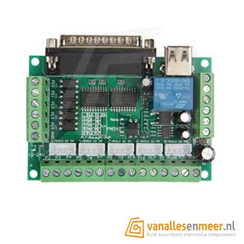

23 Nov 2023 10:26 #286315 by Robbin
Replied by Robbin on topic Mesa Card Basics
Hello there,
i am a new user of linuxcnc, recently i purchased a Mesa 7i92T card to go with the two 5 Axis Chinese bobs i already had for the plasma machine that it needs to control.
i am bit confused and can't find my answer anywhere.
are the step/dir outputs also capable of being an input? or do i need a different bob for all the end stop/switches etc.?
cheers, Robbin
  • Cant do this anymore bye all
  • Cant do this anymore bye all's Avatar
  • Offline
  • Platinum Member
  • Platinum Member
23 Nov 2023 11:14 #286318 by Cant do this anymore bye all
Replied by Cant do this anymore bye all on topic Mesa Card Basics
Any IO pins that aren't used for a specific purpose revert to IO pins.
Just be sure that the second BoB you get supports changing the 8 pit port to either input or output, other wise you'll be stuck with 12 outputs & 5 inputs per card.
Something such as this is a example:
cnc4pc.com/bi-directional-parallel-port-card.html
This is one I have, unfortunately out os stock:
www.homanndesigns.com/index.php?main_pag...nqrjh2mun1b5lp4aubc2
23 Nov 2023 11:18 #286319 by Robbin
This is the one i have, probably not suitable for what i want?
