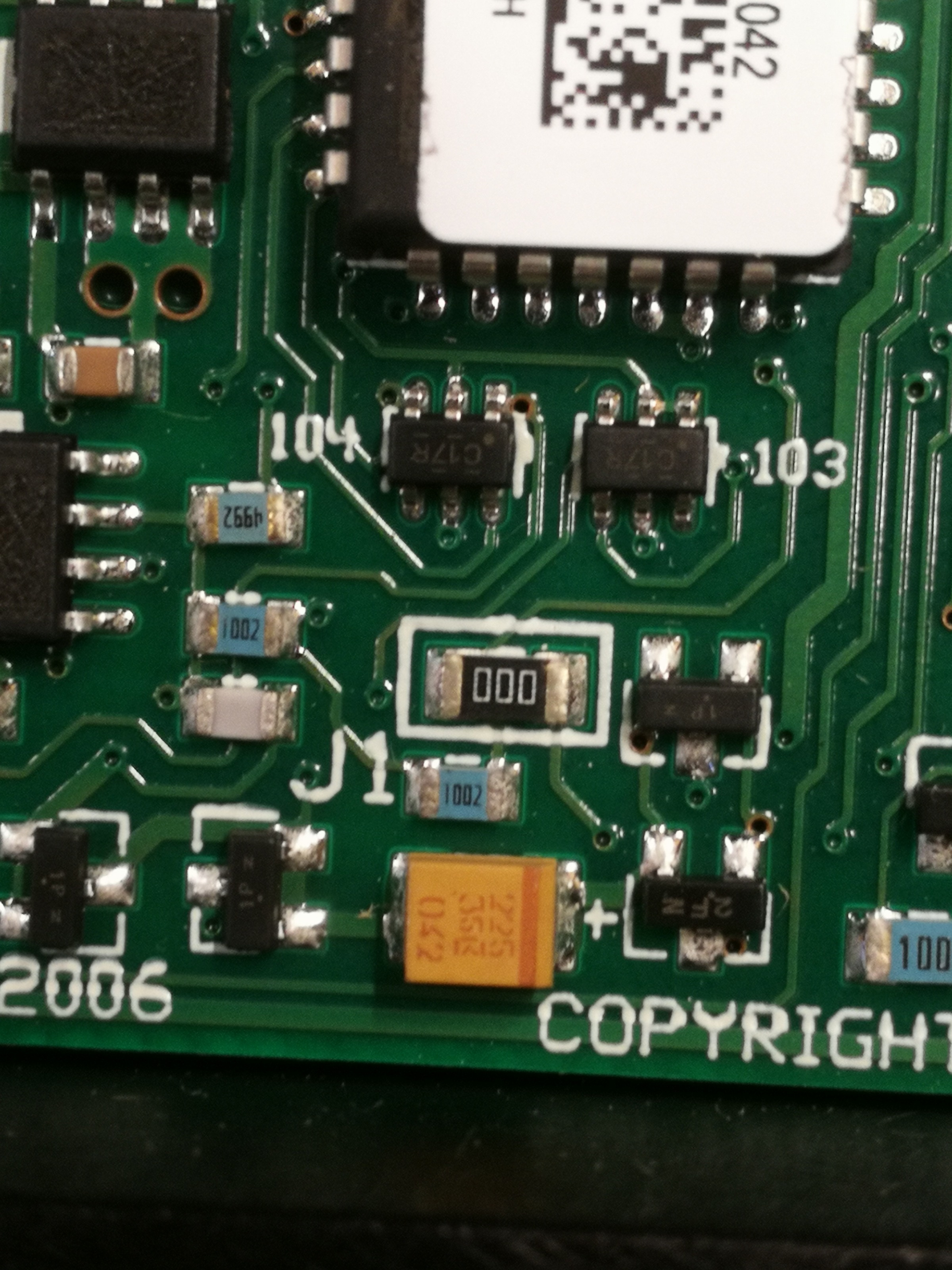

Ok so I've been told if I remove J1 off of the servo drive it will reverse the inhibit.
I have found the marking on the board and just want to make sure I'm removing the right one. In the picture there is a 000 and a 1002, I think it's the 1002 but hopefully someone else can verify this for me. Also what is the best way to remove it if anyone has done this before.
Thanks Mike
Thanks Mike
- Posts: 22037
- Thank you received: 7505
11 Apr 2020 08:43 #163611
Replied by tommylight on topic AMC drive J1 removal.
It should be the 000 from the markings and since it's resistance is 0. The 1002 is a 1KOhm resistor so removing it is not adviseable.

You did say to try a 1KOhm resistor between the inhibit and signal ground but I only have 2.7k resistor will that work or is that to much.

If it does not work with a 2.7K, try two in parallel, or 3 or even 4.
This was the easiest solution, try it.You did say to try a 1KOhm resistor between the inhibit and signal ground but I only have 2.7k resistor will that work or is that to much.

I tried it and it worked, the drive was not enabled, now where do I wire the enable from the 7i77 to on the drive? Do I still go to inhibit?

11 Apr 2020 21:21 #163709
Did it work with one only ?
Yes.
