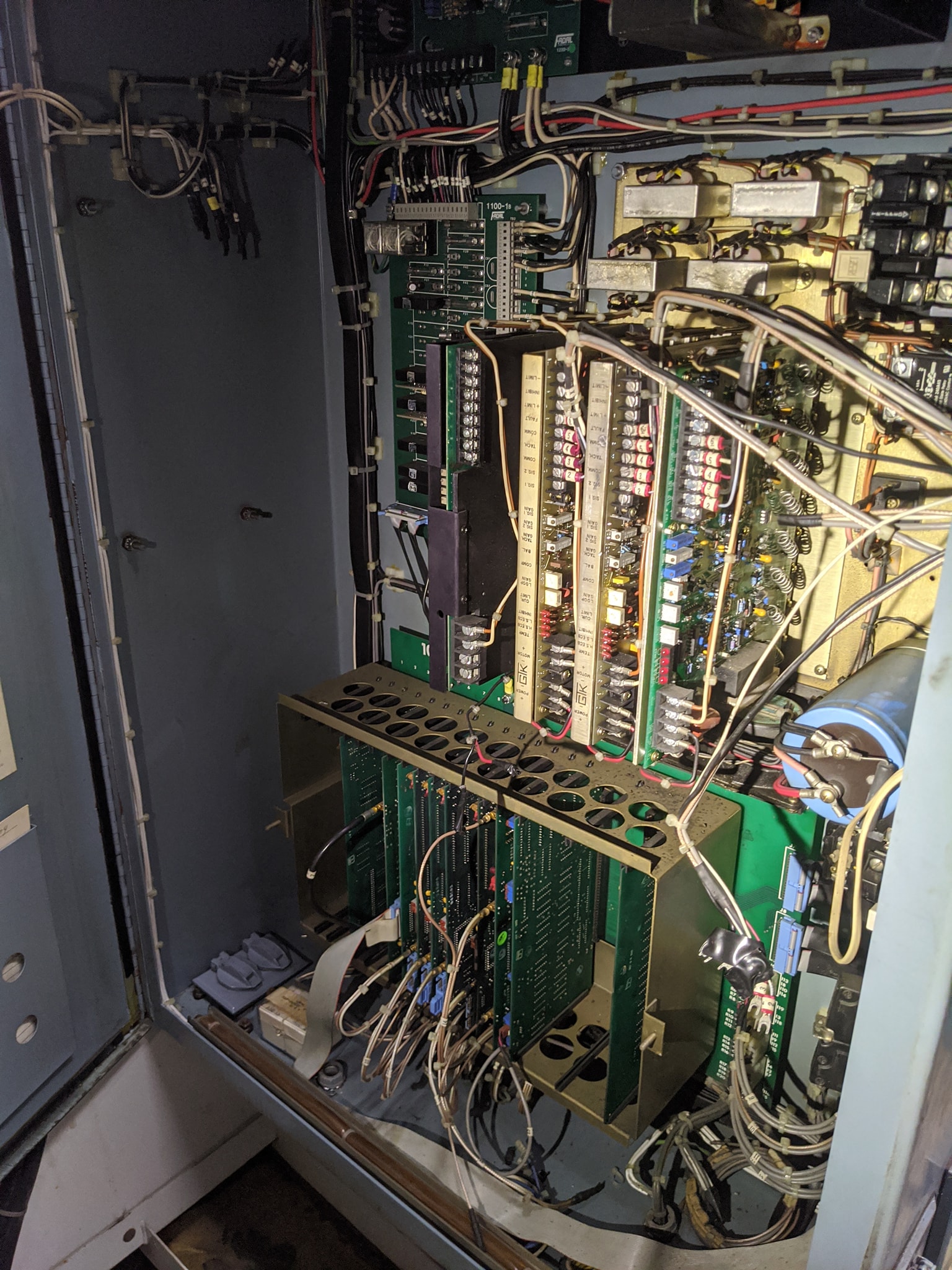

The machine requires these connections:
~24 digital outputs (driving mostly active low logic SSR inputs)
~20 digital inputs 0-5v
3x resolver inputs for X, Y, Z and possibly a resolver for the spindle? Or I could put encoder. It has none currently.
4x analog outputs for X,Y,Z,Spindle (can I use one of the 7i49 output for spindle?)

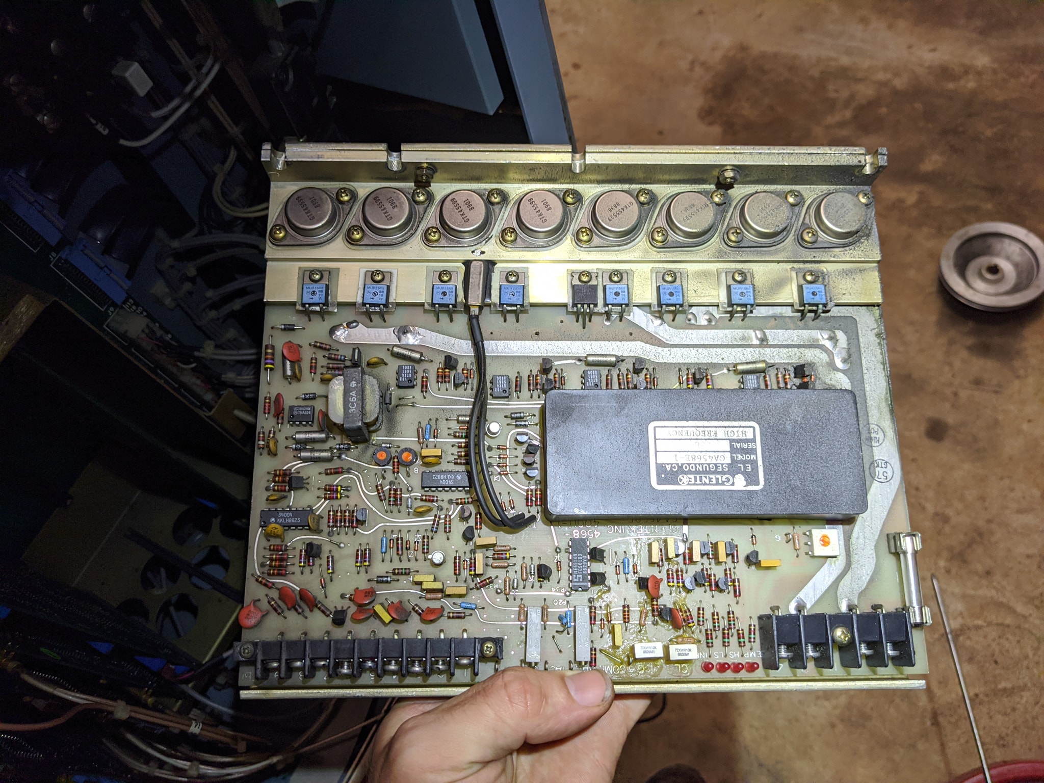

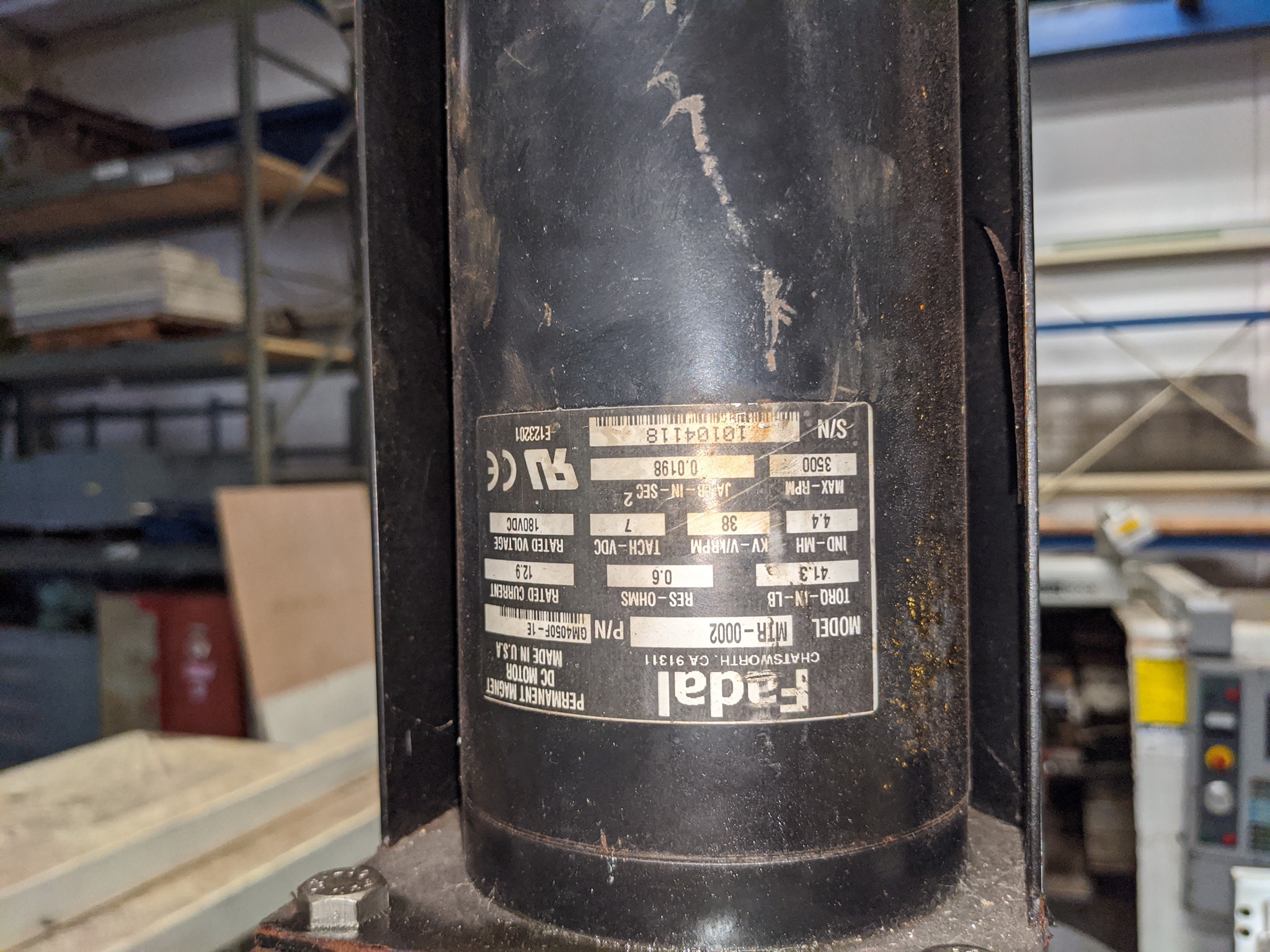

Two of the brushed DC servos look like they were replaced sometime fairly recently but the Y motor may still be original and needs new bearings in motor / resolver I believe. I checked brushes they are fine.
The DC drives are velocity control with analog generator tachometer feedback from the servos. Two of the drives look like originals and two are newer types (4th axis drive is mounted but I have no 4th axis mechanism currently so this can function as spare).
Everything works as machine is currently under power and moves with the original Fadal CNC88 control. I have thought about replacing with new brushless AC servos but it seems like a waste when the drives and motors still function. If I was to replace them I would go with Panasonic A6 1.5KW AC servos/drives which include 23bit encoders, I have experience tuning these servos.

I am still wondering if it makes sense to spend the 20-50 hours to program and tune LinuxCNC around these 30 year old DC servos with resolvers and 30 year old DC drives or if I should spend the $$ now and replace all motors with 130 frame AC servos?
I am worried I will go through that process and then something will fail in the drives / motors and the cost of repairs would be such that replacing with new AC servo is less expensive. Also the acceleration and accuracy with 23 bit encoder AC servos would likely be better.
I was thinking of going with 1.5kw Panasonic ones that are $800 each but will consider other options. Reliability is the main thing I am after and would like the system to last at least 10 years with minimum maintenance.

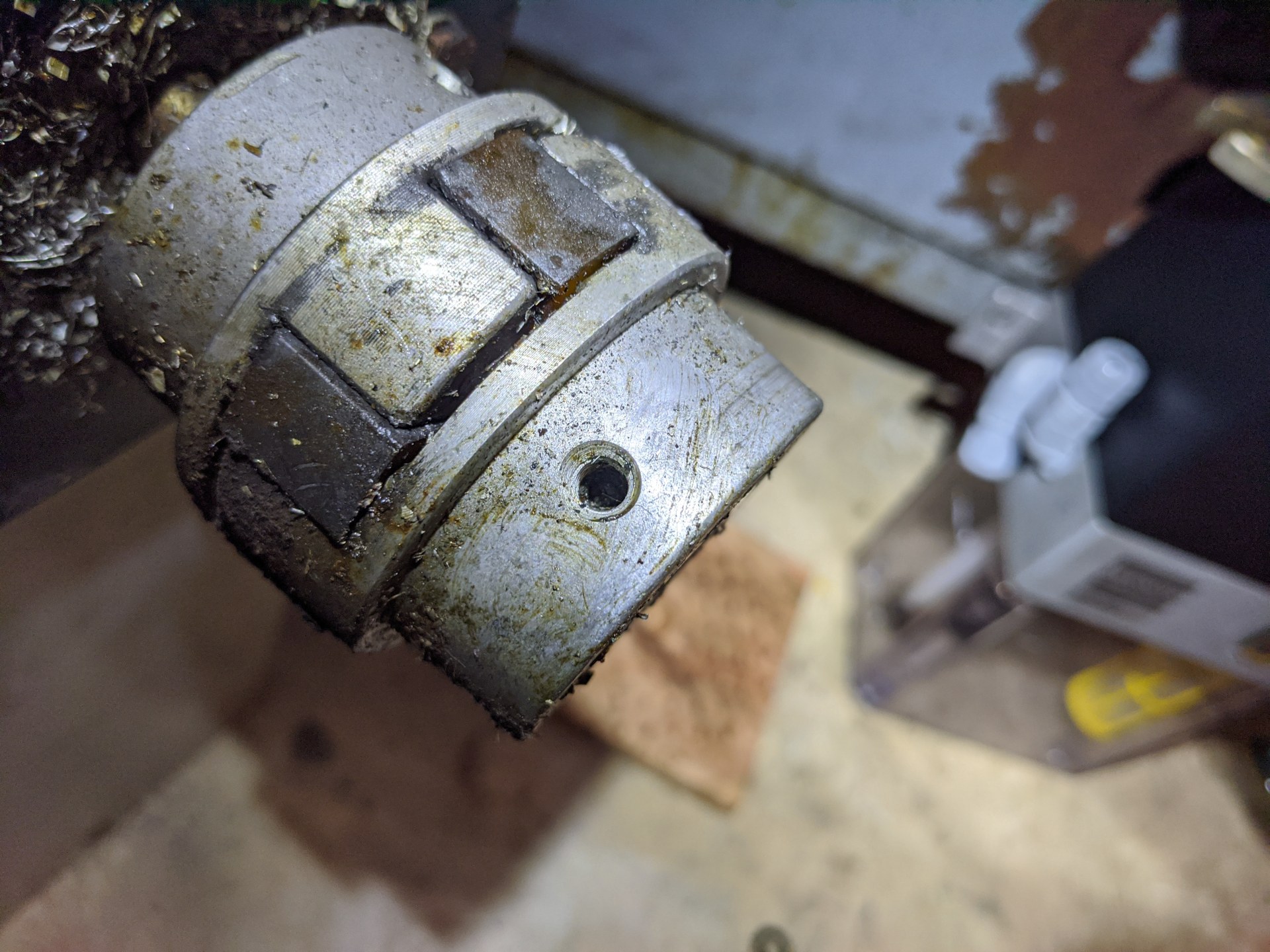

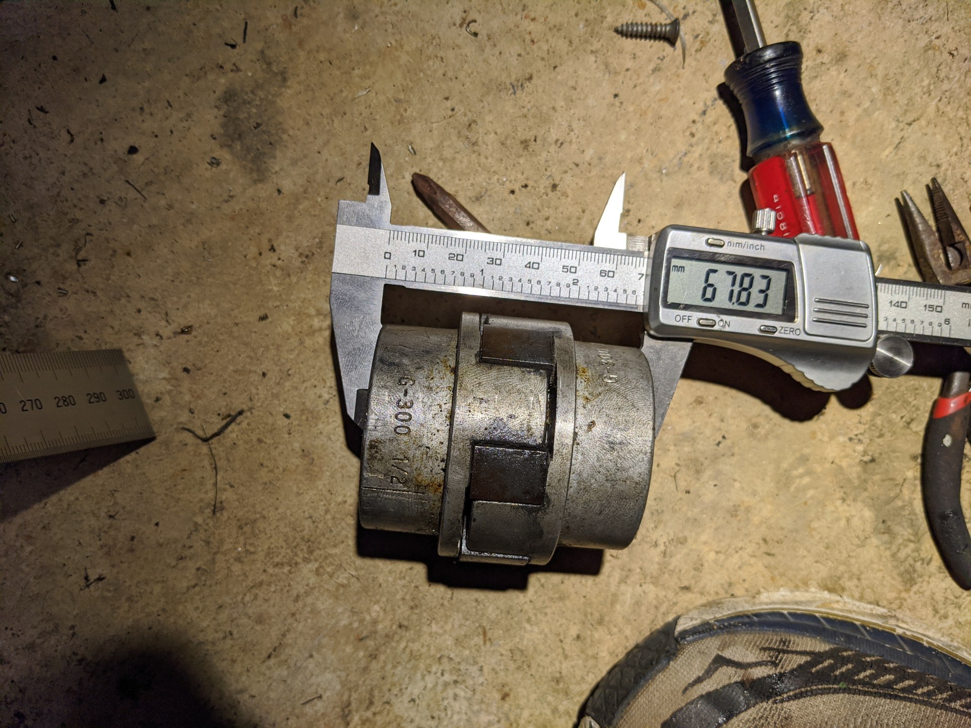

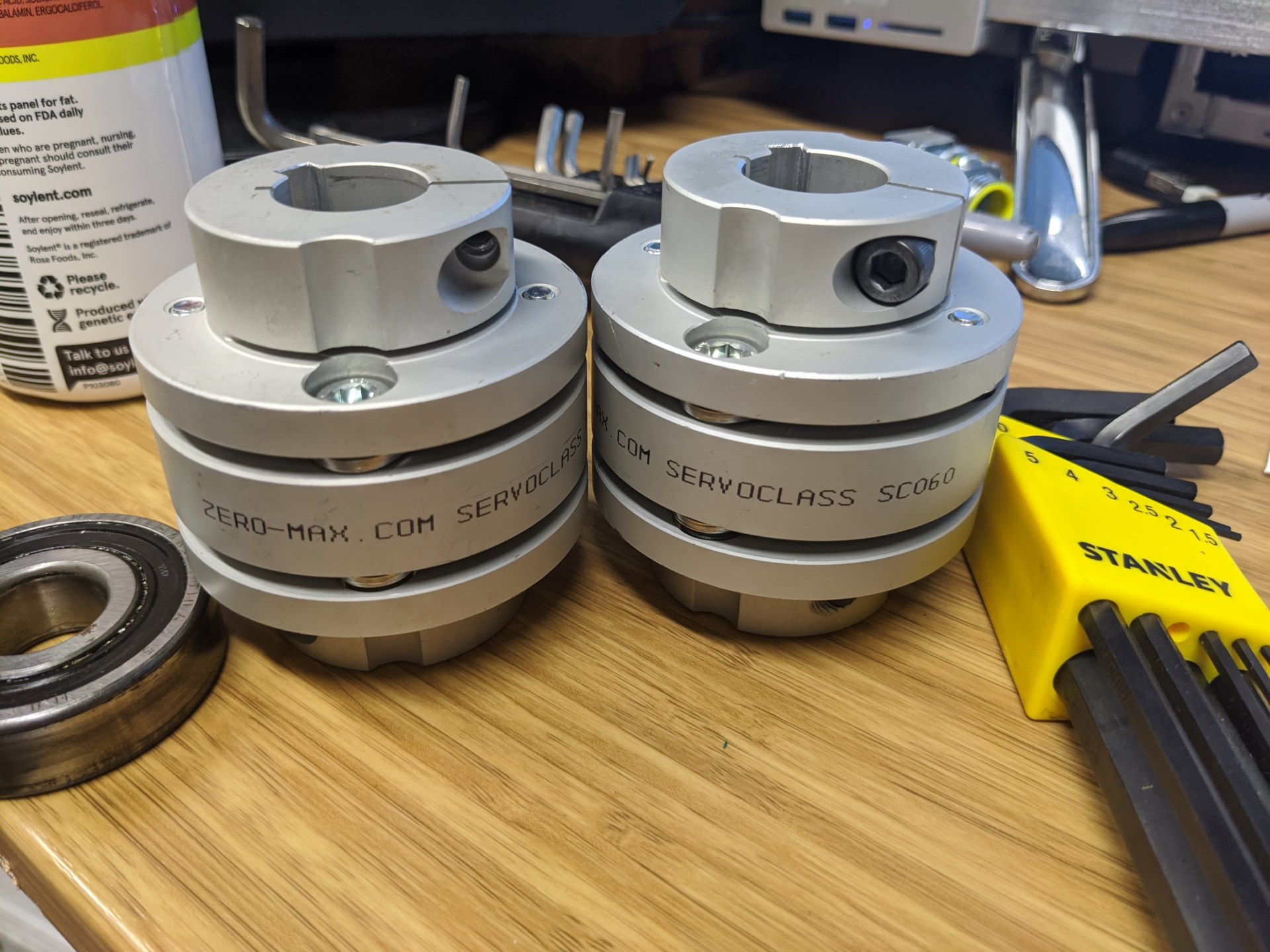

I just got in some new(used from ebay!) motor couplings that should be way better than the original rubber jaw type that weren't even attached to the ball screw properly with loose set screw, they just slid off the ball screw shaft when I unbolted the motor haha! These couplings are rated for 60Nm torque and the current DC servos put out ~20Nm peak and 5Nm continuous so should be okay.

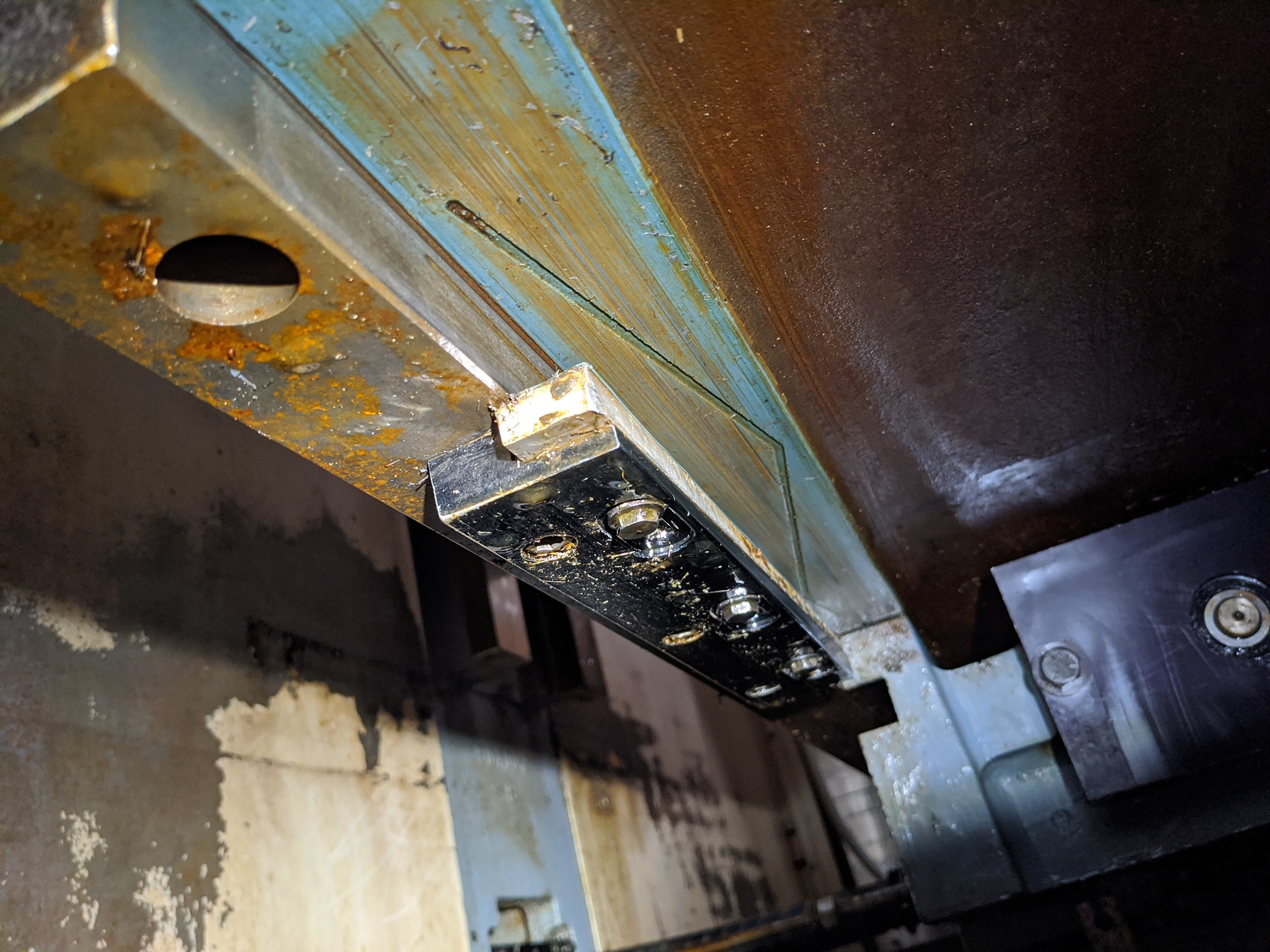

The Fadal machines actually have no homing or end stop switches at all! They instead have alignment pointers on all 3 axis - and as long as you shut down the machine at home position or jogged it close to those markers and then issued the CS command it would use the absolute nature of the resolvers to find its home position without any other sensors - neat and dead simple system.
Judging by what you've done with your lathe sounds like I could duplicate this and not need to add any new homing switches which was something I wondered about.
Is there an easy way for me to do this same setup that Fadal used with the alignment markers on LinuxCNC? Maybe I would have to write a python routine to find some absolute reference value from the resolver? I believe the resolver position must be less than +/- 90 degrees of the resolver reference position for this to work. By "reference" I mean some arbitrarily chosen position on the resolver as it is by nature absolute, not an actual reference like on an encoder.
