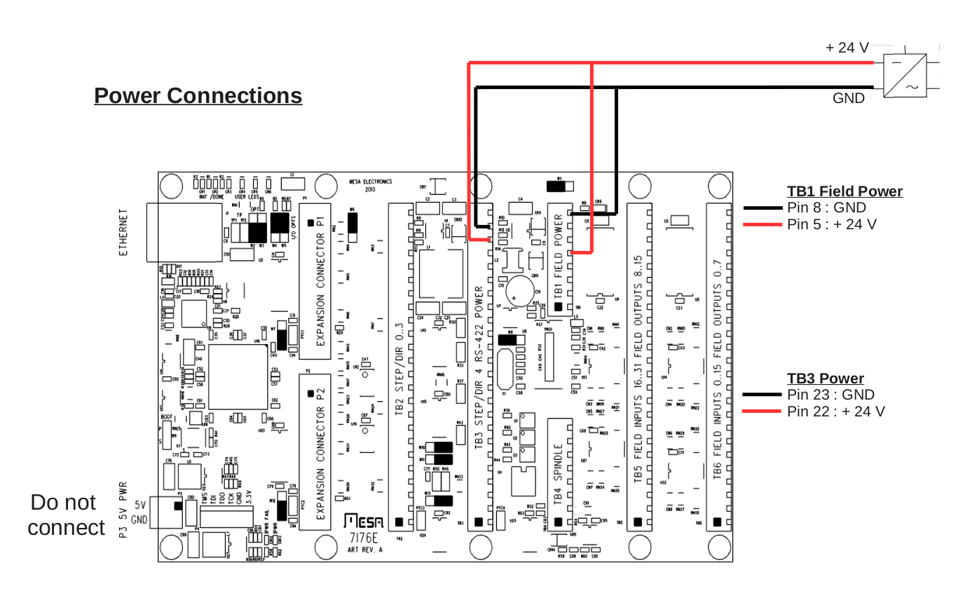

Mesa 7I76e - Two power supplies or one? was created by txtrone
I noticed the 7I76e can be powered using both 24v and 5v ... is that recommended? I have it powered using 5v only at the moment, nothing besides my PC connected. Just curious what the normal setup is? I will be using this card for a plasma table.

You can use 5V and 24V or a single 24V supply.
There is also the option of using separate field and FPGA logic power
if you want isolation between the FPGA section and the field I/O section

If using 24v only, should I use the same 24v PS to provide power to the TB1 field power AND TB3? Or do I need to somehow separate that incoming power? Or have it coming from two sources?

Normally I would just use one power supply unless you want the field
I/O section to be isolated for noise reasons.

Ok, but does the one power supply need to connect at both TB1 and TB3? The way that the 'Anschluss' drawing shows? Or am I misreading the schematic? Relevant portion attached.
Thanks!
Replied by txtrone on topic Mesa 7I76e - Two power supplies or one?
Thanks!

Yes you would need to connect to TB1 (Field Power) and TB3 (unregulated logic power for the FPGA side)

Thanks! I flipped the switch and no smoke!
