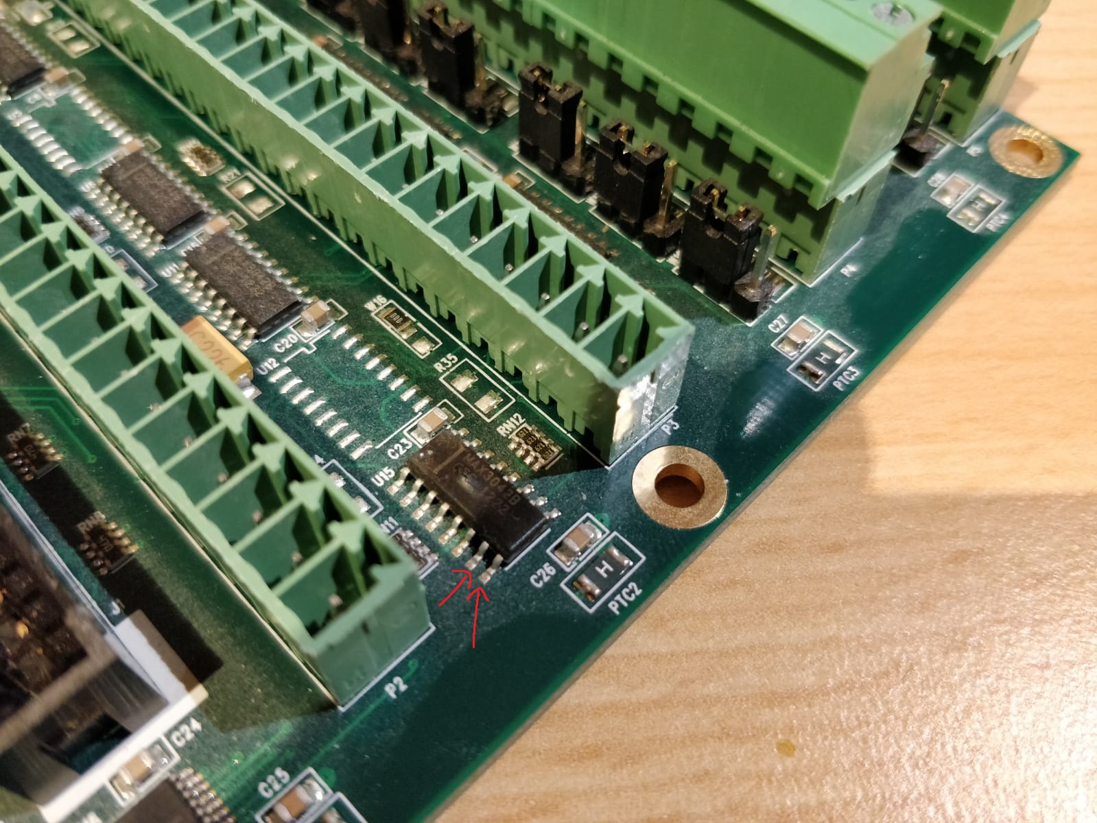

hello,
i accidentally destroyed an ic and already have replaced it but when measuring continuity with my multimeter i saw that two pins have a connection (most likely on the board because i have ordered 2 ics and the other new one doesnt have a connection on these pins). There are 3 other same ics on the 7i52s and none of them has connection on these pins thats why im asking. Maybe there could be another component broken? Right now i dont want to connect the board to my 7i80 if i dont know if this is supposed to be or not.
i have uploaded a picture showing those pins.
11 Nov 2020 14:50 #189003 by PCW
That's correct, U15 pins 7,8,15 are grounded
8 is chip ground, 7 and 15 are unused inputs
4,12,16 are 5V
The following user(s) said Thank You: 3D-Master
11 Nov 2020 14:54 #189004 by 3D-Master
Replied by 3D-Master on topic 7i52s replaced ic pin continuity question
Okay thank you!
