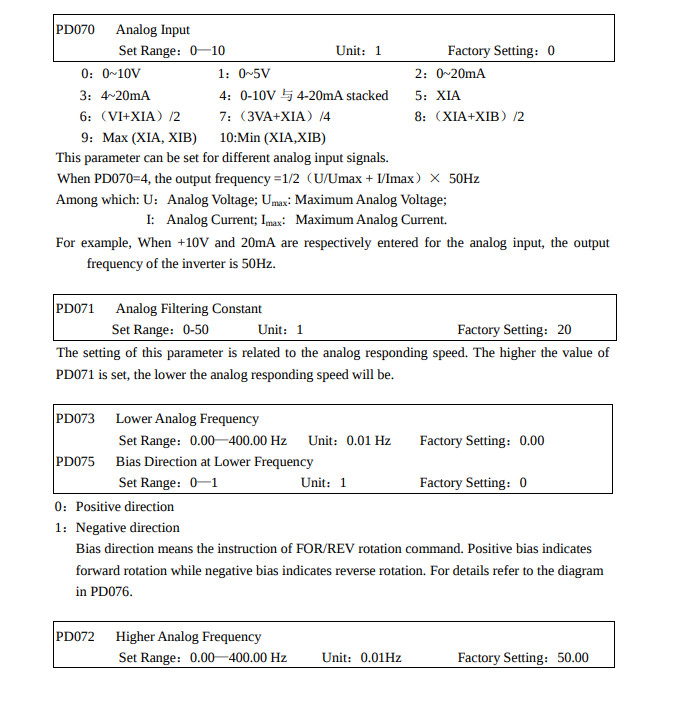

I think PCW is right that it is likely a noise/EMI issue. I have this connected with unshielded cable for testing. The shielded cable arrives tomorrow, so I'll see if that helps, then I'll look for other sources of EMI.
I was not aware of motor slip. I will read up on that, thanks.
Thanks for those suggestions. I tried adjusting PD71 through the full range and it had no effect on the spindle speed. I may try PD159 after going down the EMI route.Try Parameter PD71 or PD159 to adjust target speed. Any VDF should compensate this kind of Problem only Parameter are Different. Or increase P of your VFD. Something must be happened.
