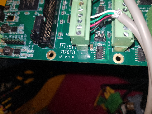

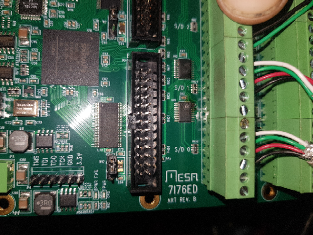

Hi Guys,
I think I have just fried my 7i76ED.
I am still in the wiring / setup stage, and was just wiring up the Z limit switches.
I powered the board up, and it started smoking. I powered down ASAP, but looks like I have done some permanent damage.
Looks like a couple of ICs have burn marks, but I'm not sure what they are. They apear to be labelled U24 and U19.
I am still not 100% sure where the short was. The only difference from last working was I had wired Z limit switches - 1 wire to input and the other to field power.
The only other possibility is that the shielding on 1 of my cables accidentally touched the board and shorted everything out.
Does anyone in AUSTRALIA have a 7i76ED or 7i76ED board I could buy off them ASAP?

06 Jan 2021 11:06 #194202 by tommylight
Replied by tommylight on topic HELP - I just fried a 7i76ED
Before you get the new card, do check the wiring, again and again, make shure everything is OK before plugging the new one.
To much stuff burnt there but i did not have time to check what exactly.

06 Jan 2021 14:14 #194227 by Todd Zuercher
Replied by Todd Zuercher on topic HELP - I just fried a 7i76ED
Looks like some high voltage wire or something touched and shorted to the screw for TB2-pin6. (That or you really made hamburger out of it with a screwdriver.)
06 Jan 2021 16:27 #194243 by PCW
Replied by PCW on topic HELP - I just fried a 7i76ED
Yeah it looks like a high voltage (well 12V or more) got connected to the
7I76Es 5V rail

06 Jan 2021 19:29 #194267 by htdave
Replied by htdave on topic HELP - I just fried a 7i76ED
7I76Es 5V rail
I hadn't noticed the mark on TB2-6. I just had a look at it, and it is only the top of the screw that is discoloured. Underneath looks brand new.
The only wiring change I had made was wiring in Z limit switches. These are an NC microswitch. I had them wired from 24V to TB6-14 and TB6-15. Should I have had them wired to 5V instead of 24V?
The other possibility is that the shield cable from one of my cables shorted out some pins on an IC - I will be insulating the ends of all cables before plugging the new board back in.
