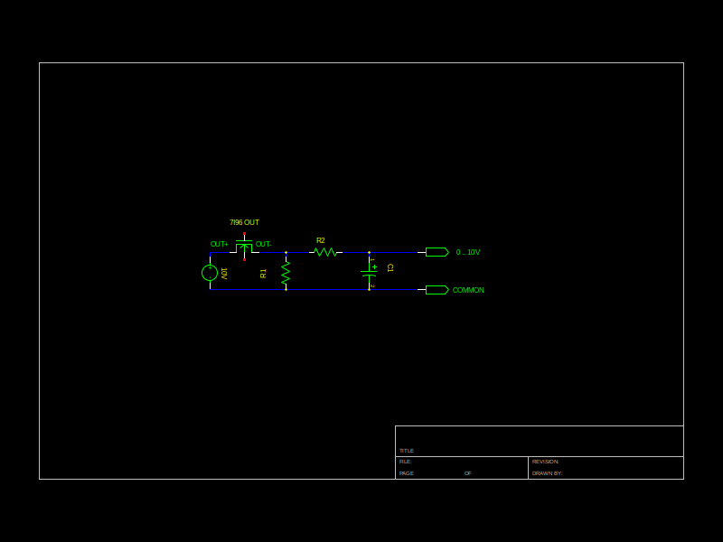

Hello
I have a CnC working but with a potentiometer to control the spindle speed.
The Spindle is connected to a Power supply whitcgh accept a 0-10V control.
I would like to control the spindle speed with the 7i96 mesa card.
I have the 7i96 tool installed (latest version).
I have connected the Spindle On cable to Ouput 0
I have connected the Spindle 0-10V cable to Ouput 1
I have configured this Output with Spindle On and Sindle CW in the 7i96 Tools
I have read my "old" ini file but the Spindle documentation is not so helpfull
In the Spindle type it is not obvious wich one I have to select...
Did someone have a link on a page where there are some advice or explanation how to configure it?
Many thanks

I am not sure to understand the wiring around the 7i96 Out +/- and the 10V.
I need an external 10V supply ?

If your drive supplies 10V then that can be used.
Depending on how much current the drives 10V can supply
you may need to adjust the resistor/capacitor values

I used one of these with my 7i96. Worked fine.
www.ebay.com/itm/PWM-To-Voltage-Converte...7:g:YFEAAOSw7Cdfybce

Thanks for the electronics part. I will by this module.
But what about the configuration part?
I was wondering, the On/Off of the spindle was a Wire.
Should I put the Output to High to simulate the short circuit ? or is it more complicate?

Did you look at the schematics I posted? I am running a VFD, so the VFD enable, start and direction are all controlled directly by the 7i96, and the analog speed input is a PWM output from the 7i96, changed to a 0-10V analog signal by that little widget, and then input to the VFD.
Mark
Mark

I have received my small board to convert PWM to 0-10V.
It look likes yours.
It has also a 5V / 24V PMW selector.
Did the Mesa card Output send 5V or 24V ?
