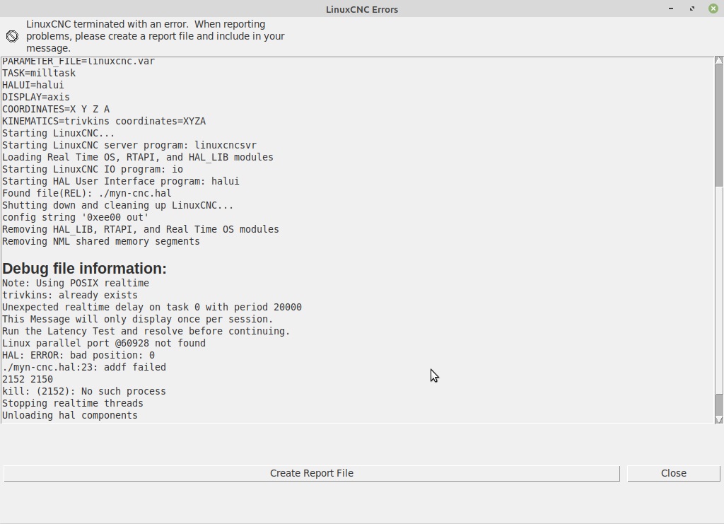

I am desperately trying to install an external parallel card.
My computer does not have an internal parallel port, so I inserted an external card
This card has a "mcs9865" chip.
The instruction "lspci -v" gives this;
02:04.0 Parallel controller: MosChip Semiconductor Technology Ltd. PCI 9865 Multi-I/O Controller (prog-if 03 [IEEE1284])
Subsystem: Device a000:2000
Flags: bus master, medium devsel, latency 32, IRQ 5
I/O ports at ef00
I/O ports at ee00
Memory at fdefe000 (32-bit, non-prefetchable) [size=4K]
Memory at fdefd000 (32-bit, non-prefetchable) [size=4K]
Capabilities: <access denied>
Kernel modules: parport_pc
I have tried with;
loadrt hal_parport cfg="0 out"
loadrt hal_parport cfg="0"
loadrt hal_parport cfg="0xef00 out"
loadrt hal_parport cfg="0xef00"
loadrt hal_parport cfg="0xee00 out"
loadrt hal_parport cfg="0xee00"
but when i start the cnc i get the debug info
"Linux parallel port xxxxx not found"
Anyone any idea how I can fix it?

- Posts: 18091
- Thank you received: 5323
08 Mar 2021 14:51 #201432
Replied by PCW on topic Install parallel port
I think "Linux parallel port xxxxx not found" is just a warning
LinuxCNC may still work if you provide the actual card address
(since the actual card access is direct to hardware)

- guido-52
- Posts: 25
08 Mar 2021 18:14 #201455
by guido-52
Replied by guido-52 on topic Install parallel port
Hi PCW,
I don't understand, How do I provide the current address?
Isn't that with
"loadrt hal_parport cfg =" 0xef00 out "in my hal file?
According to "lspci -v" the card has two addresses
ef00 / ee00
Returns the error;
Linux parallel port @61184 not found
"loadrt hal_parport cfg =" 0xee00 out "in my hal file
Returns the error;
Linux parallel port @60928 not found
Where the numbers are of course the decimal form of the hex address
What am I doing wrong?
Isn't that with
ef00 / ee00
Returns the error;
Returns the error;
- Posts: 18091
08 Mar 2021 18:32 #201461
Is the error fatal?
I think it just means LinuxCNC did not find a
parallel port driver (which should not be necessary
unless the hardware is so non-standard that it requires
a custom driver to enable normal operation)
- Thank you received: 4654
08 Mar 2021 19:23 #201473
Replied by andypugh on topic Install parallel port
I just tried loading hal_parport on a machine that definitely has a parallel port and one that definitely doesn't.
The error message appears on both. Both also create all the HAL pins.
It seems that the only way to tell if it has found the parallel port is to test the port.
This isn't as odd as it seems. The LinuxCNC driver just sends and reads data to a port address, it has no way to tell if anything is listening.
- guido-52
- Posts: 25
09 Mar 2021 09:20 #201528
by guido-52
When I try to launch the cnc it just won't start up instead I get an error screen.
I had a working system, but linuxcnc indicated that the computer were too slow.
That is why I moved the hdd to a faster computer, without a parallel port and plugged one into a free pci port.
I have two parallel cards, both give the same error.
