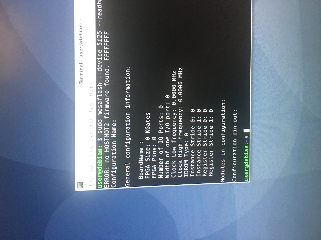

20 Mar 2021 20:12 #203026
by silden
Replied by silden on topic 6I25 --recover
Hi PCW,
I just tried it again and it doesn’t work.
It goes through the steps, but the card still shows no firmware installed.
Please see the attached screenshots for reference.
- Posts: 18111
- Thank you received: 5330
20 Mar 2021 20:15 #203027
Replied by PCW on topic 6I25 --recover
And that's with the distributed fallback.bit and the 6I25 jumped for 33 MHz?
