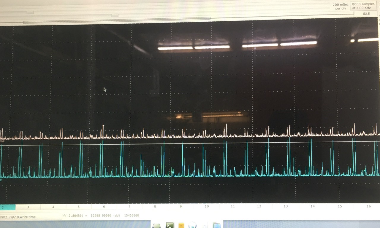

Hi All,
I’m trying to figure out what is causing the read and write spikes of my 7i92, 7i76 and 7i85 setup.
The machine doesn’t throw errors, but feels sluggish at times.
the “baseline” read time is like 280000 and the write time is 9000. The consistent spikes are 2-3 times higher on read and 5-10 higher on write.
I added the read request and tx/rx-usec 0 without much of a change to n spikes.
I tried this on two machines with similar results.
one is a NUC10 i3 the other a intel G4620.
What is causing these spikes?

Replied by PCW on topic 7I92 read and write latency spikes
Probably LinuxCNC GUI Graphic updates (since they seem to happen at 10 Hz)
You may be able to reduce the spikes by disabling any video power saving
Also, as long as you don't overrun the servo thread time these spikes
are basically harmless (especially if you use the DPLL to sample
critical feedback values like encoder and step generator positions)

14 Mar 2021 12:52 #202233
by silden
Replied by silden on topic 7I92 read and write latency spikes
I will check the GFX settings.
I compared the baseline read and write times of both machines and found that the only reason they are different is the different clock speeds. They take about 1000,000 clock cycles on both CPUs. Thats odd to me because the two CPU should take about the same time to crunch the numbers and output the data to LinuxCNC, due the raw speed of the CPUs.
What would be the read and write times of a PCIe solution?

14 Mar 2021 12:58 #202235
The difference is because the times are in CPU clock cycles
PCI/PCIE typically have shorter latency since they don't use as much OS code and memory (perhaps resulting in cache misses), but unless you need better than a 1 KHz servo thread or you have real time issues (can't meet a 1 KHz deadline), the latency spikes are harmless
