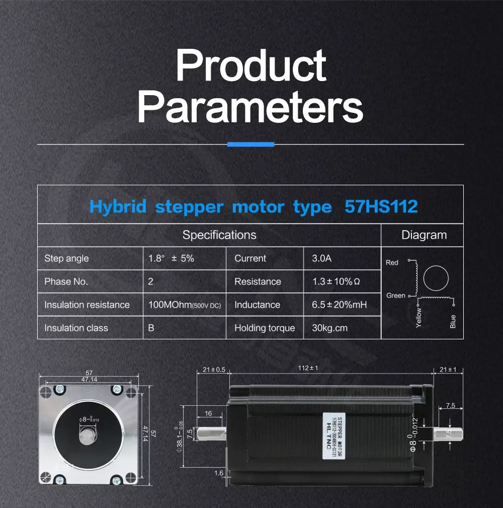

I run them on 36 volt after all the manual says 42v peak. 36v recommended.
I attached the data sheets for steppers drivers and power supply.
As I said Stepper Motors don’t get hot only the drivers I run them on 3A rms.

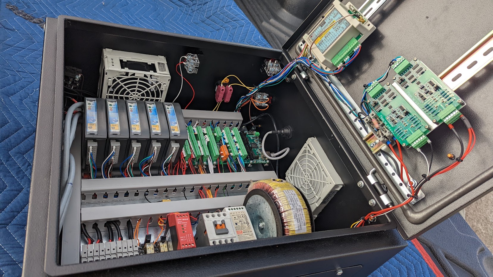

Today was a hot day ambient temperature was about 40 degrees Celsius
And the controlbox was switched on all day.
So when I cut a long cut suddenly one of the drivers got hot and shut down. So the tandem axis pulled skew and messed up the whole thing I was cutting.
My control box has no forced cooling would forced cooling help prevent this problem
Or could it be that the driver is damaged?

I have mine at 2A in a shop that gets to 55 degree C in the summer (around 0 right now) and had no issues with them, but i would venture a guess that the one faulting has the chip not laying flat on the cooler, so open it and check if the board/chip are flat and the thermal pad is in place.
Mind you, as a general prevention i did open all of them and also added thermal paste between the chip and pad and heatsink and pad.
All on closed enclosures with no fans.

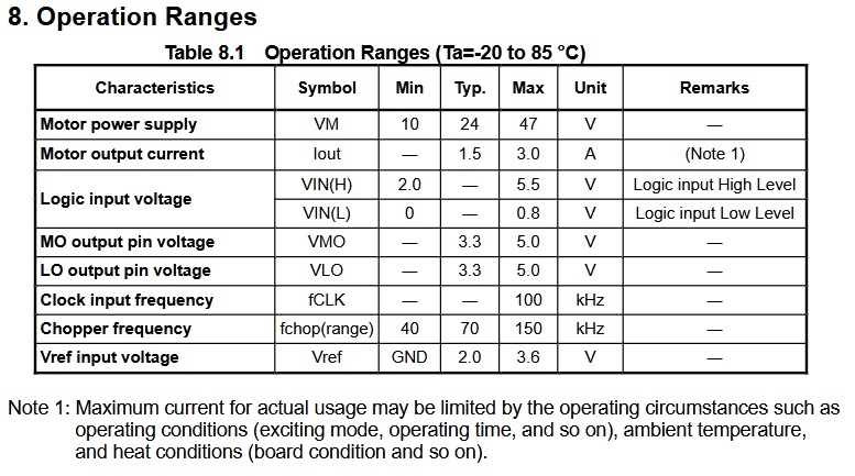

A lot of the "TB 6600" drivers actually use a S109AFTG, why the vendors keep advertising the wrong chip and printing false technical data on the devices, I do not really understand. The box says 1/32 microstepping (?), so it is not a TB6600 (which only goes up to 1/16th)
For small motors S109AFTG is O.K.. for bigger motors I would not use them. ( TB6600 I would not use, no matter what motor
As per the data sheet 3A is asking for trouble it is more like 1.5A. The 4A that everybody states (false, as fraud or due to ignorance remains a secret) is the Absolute Max. Rating. (magic smoke boundary?)
