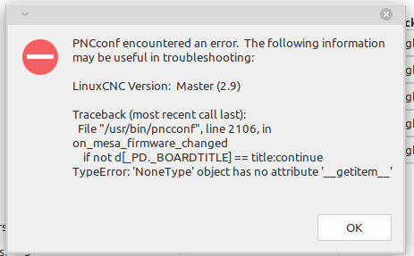

22 Apr 2021 01:39 #206755
by spumco
Replied by spumco on topic Help please - trying to get started
- Posts: 17940
- Thank you received: 5255
22 Apr 2021 01:54 #206756
Replied by PCW on topic Help please - trying to get started
I don't think board discovery has ever worked
I would just setup using the stock firmware choice
