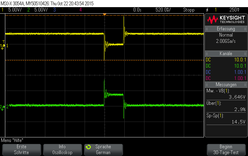

We are also searching for a failure of one "ISL32174 EIBZ" - we lost this part of the mesa card on stepgen2/3, while commissioning the servos. We use inverters from cs-lab (simdrive 400W) with standard differential ttl optocoupler inputs... we have checked the cabling several times, have done an analysis with differential probes on all lines (see screenshot) and we can not find any "physical" problem. Perhaps you have a clue...

23 Jun 2021 13:33 #212741
Replied by PCW on topic 7C80 + 7i74 and 7i84
It actually sounds a bit like a defective RPI4, At least I have never seen this issue
or heard of it from another customer, and have at least a year of uptime on my test system.
If the step/dir outputs do not swing a full 5V when unloaded, the driver chip has been damaged. This can occur if the outputs accidentally contact something with a voltage outside the 0 to 5V range. A max3042 is a replacement (ISL32174s are hard to find currently)
