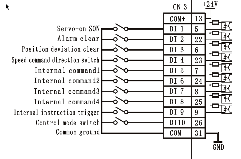

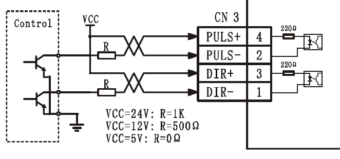

Hello,
I have a mesa 7i76e board and I want to connect it to a Lichuan B2 Servodriver in Step/Dir (Positioning Mode)...as a Spindle.
I connected the pins 1,2,3, and 4 to the Step/Dir Connections of the MesaCard. (like its said in Documentation)
but nothing happens if I try to turn the Spindle....
I think I also have to connect the pin 5 to the mesacard to enable the Servodrive.
But what pin on mesacard can I use to connect to pin5 (Servo-on / SON)
Thanks a lot for your help
Greetings Olli

For the active low spindle enable, I would use the 7I76E spindle enable output:
7I76E DRIVE
6 ENA+ --> 5 SERVO-ON
5 ENA- --> 31 COM
7I76E DRIVE
5 ENA- --> 31 COM

- Posts: 18103
- Thank you received: 5326
06 Oct 2021 16:59 #222379
Replied by PCW on topic Cabling a 7i76e to a Lichuan B2 Servodriver
When hm2_7i76e.0.7i76.0.0.spinena is true, the ENA+ and ENA- pins on the
7I76E should be connected. You should be able to verify this with halshow and an Ohmmeter

But the motor doesn't turn if I try to ...
Tomorrow I will check if I did all the settings in the servodriver right and the cabling:
I connected:
Servodriverside to /i76e
Pulse+ to Step+
Pulse- to Step-
Dir+ to Dir+
Dir- to Dir-
Thanks a lot
