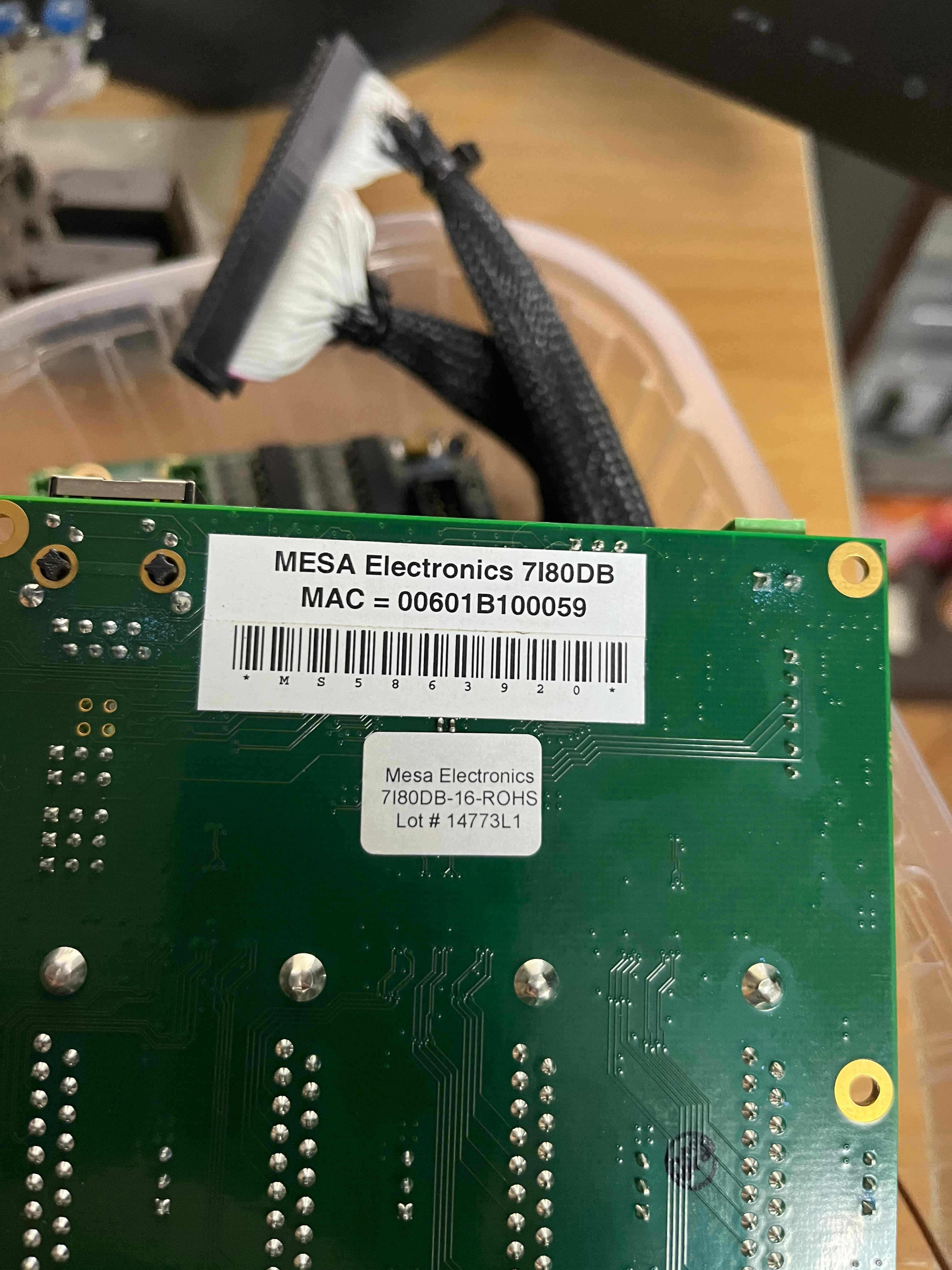

I went crazy with a 7i80 that did not want to start, I had to turn it off and on several times to be detected and then work, this with a nuc i3 with bad latency.
i got an i7 pc with very good latency and i got the error like Rod.
usual linux19 mx system with qtplasmac and no other network connection. I have tried three network cables with no changes. after this I took a 5i23 that I had in a drawer and it works up to 8 khz we hope the plasma does not burn it ... but it is without hf I am confident.

If you have that much trouble, it's likely a bad or damaged 7I80.
What model was it? (there are some 7I80s that had bad
EEPROMs so would not have valid MAC addresses when cold)

Thanks Peter, now I use the 5i23, then if the 7i80 works I will need to do something else. I don't lack time
it is a 7i80db 16 I had asked for the hd but the seller has seen fit to give me what he had ...

Replied by PCW on topic 7i96 Error finishing read.
Yeah that's a early 7I80DB so likely has a Microchip 93C46
which it turns out is faulty at low temperatures (at least it does not
work reliably with the Ethernet chip and low temperatures)
