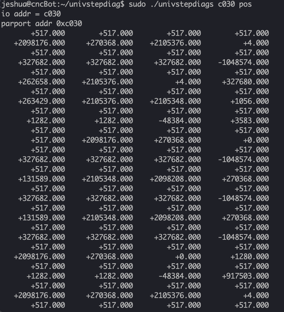

I hadn't powered up my machine in a couple years. I've verified functional encoders for my Y and Z axes, but the X is not working properly.
I've traced the wires, and everything so far seems to check out. If I manually move the encoder, the value will only go one way. Eg it will only get larger, but if I swap the encoder A and B signals, it will only get smaller. The encoder checks out on one of the functional axes. I guess that may indicate that only one of the channels is being seen by the board or Gecko?
If I run univstepdiag pos, all the axes largely look the same to me. I'm not sure what I am looking for.

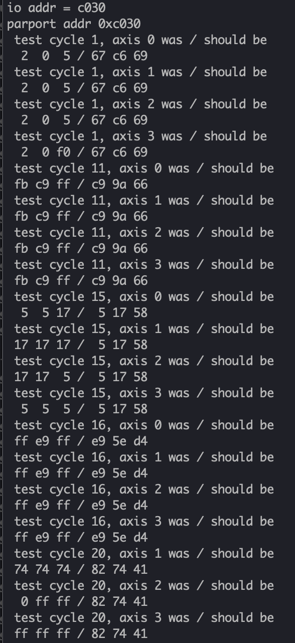

Here is the output from commtest, again not sure if this looks right or not.

15 Apr 2022 20:43 #240340 by jmelson
The commtest output shows bad/no communication between computer and USC board.
First, when you power the USC on, make sure the "load fail" red LED flashes for a fraction of a second and then goes out. Then, make sure the parallel port is set for EPP mode. It may be necessary to run the pcisetup program to set the port to EPP mode, but that is slightly complicated with PCI plugin cards at different addresses.
I think the address you should specify in pcisetup for the c030 parport is bc30 (or maybe bc2e). This is only needed for the diagnostic, LinuxCNC already knows how to set the port for EPP mode.

15 Apr 2022 21:13 #240344 by 3DTOPO
Thanks Jon. Red light flashes then goes out and the LED beside it goes green.
In the past, if the parallel port wasn't in EPP mode, I couldn't even get the diagnostics to see the card. But I tried both:
sudo pcisetup bc30
sudo pcisetup bc2e
And it looks like commtest is failing miserably still:
sudo ./univstepdiags c030 commtest:
test cycle 999, axis 1 was / should be
ff ff ff / 1 96 17
test cycle 999, axis 2 was / should be
ff ff ff / 1 96 17
test cycle 999, axis 3 was / should be
ff ff ff / 1 96 17
1000 test cycles, 3996 errors

15 Apr 2022 23:26 #240355 by 3DTOPO
My bad! I quit out of Axis and it works as expected:
io addr = c030
parport addr 0xc030
1000 test cycles, 0 errors

The pos printed messages makes sense now. But I can only get the X pos to go in one direction only (depending on encoder signals A/B switched).
jeshua@cncBot:~$ sudo univstepdiag/univstepdiags c030 pos
io addr = c030
parport addr 0xc030
+497.000 +517.000 +517.000 +517.000
