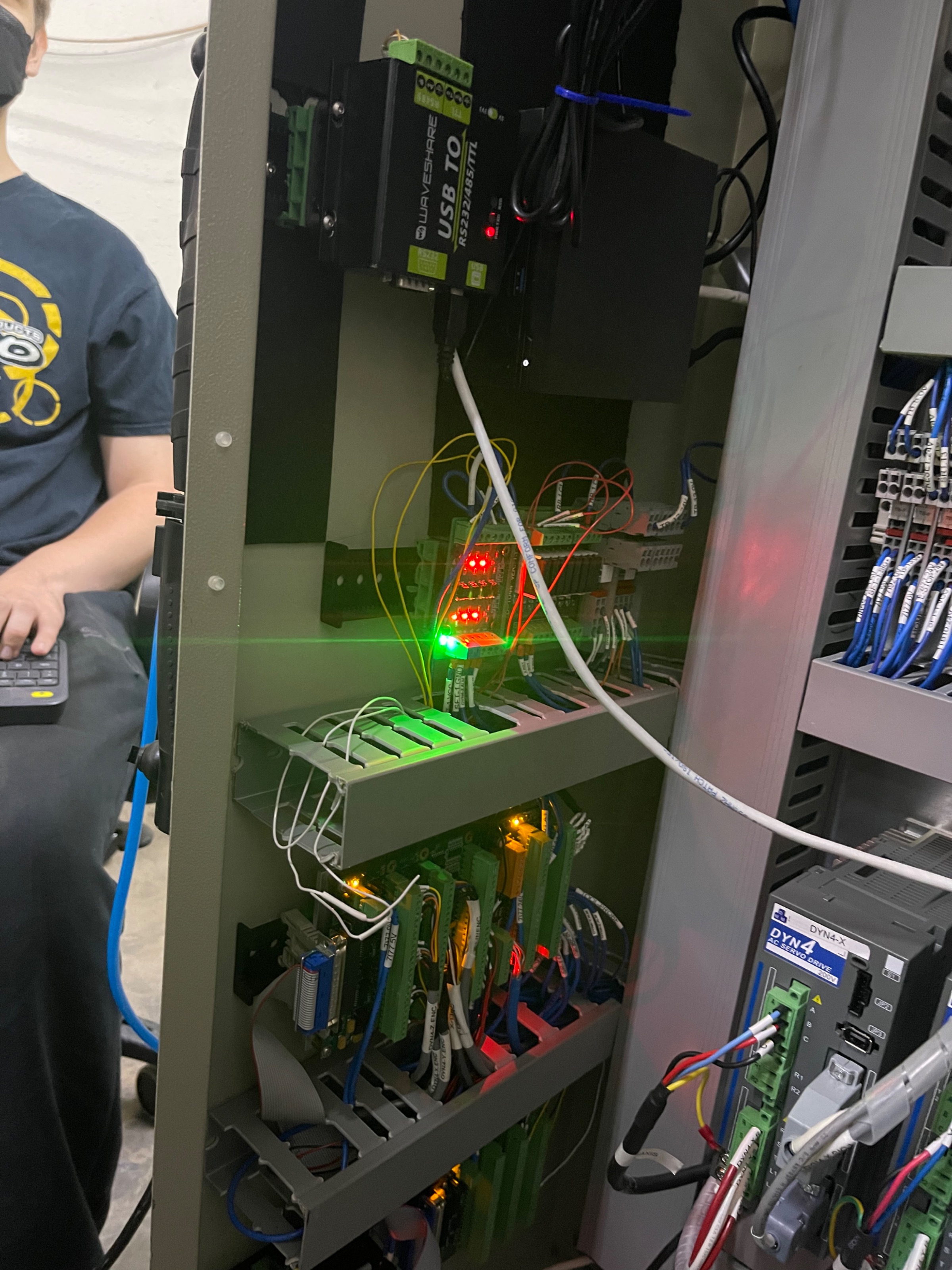

Hi all,
I just changed the computer on my machine to an Asus PN50 from a Intel NUC 10 due to graphics issues.
While the graphics issues are gone, and the overall latencies look phenomenal, I am now getting the "Error Finishing Read", usually after less than 1 minute of running.
When it first ran, I checked the read and write latencies, which came out at around 10000 (without errors).
I already tried changing the Ethernet cable (currently a shielded CAT6), and the power supply should also not be any issue.
I have an Mesa 7i92 attached to a 7i77, 7i85s, and 7i73.
Also, I am running a custom lubuntu install with linux kernel version 5.18 with the RT patch applied and configured.
Thank you for reading.

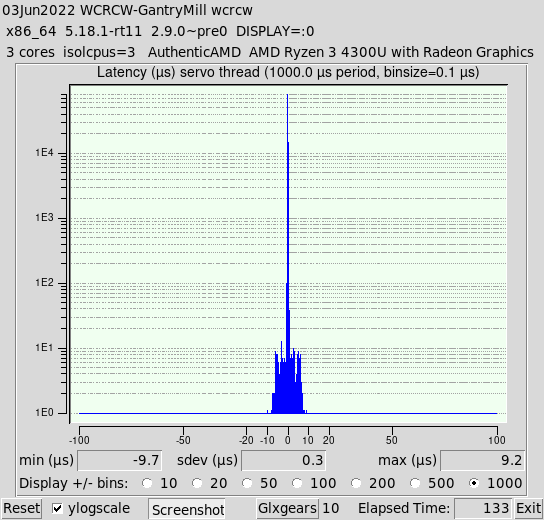

Looking at the histogram, it does look that you have done that, so do a ping to Mesa 7i92 and check the reply times, and post them here.

Do run several glxgears and resize their windows while that is running.
Ping looks fine, so power supply or interference, if there are no excursions on the above test.
Replied by tommylight on topic Mesa 7i92 Read Errors
latency-histogram --nobase --sbinsize 1000 --showPing looks fine, so power supply or interference, if there are no excursions on the above test.

Hi timmylight,
Thank you for the suggestions, we already ran the latency histogram with 10 glxgears, for a longer period than the screenshot above showed.
We will run it again tomorrow because we decided to rebuild the kernel to install the latest RealTek Ethernet driver.

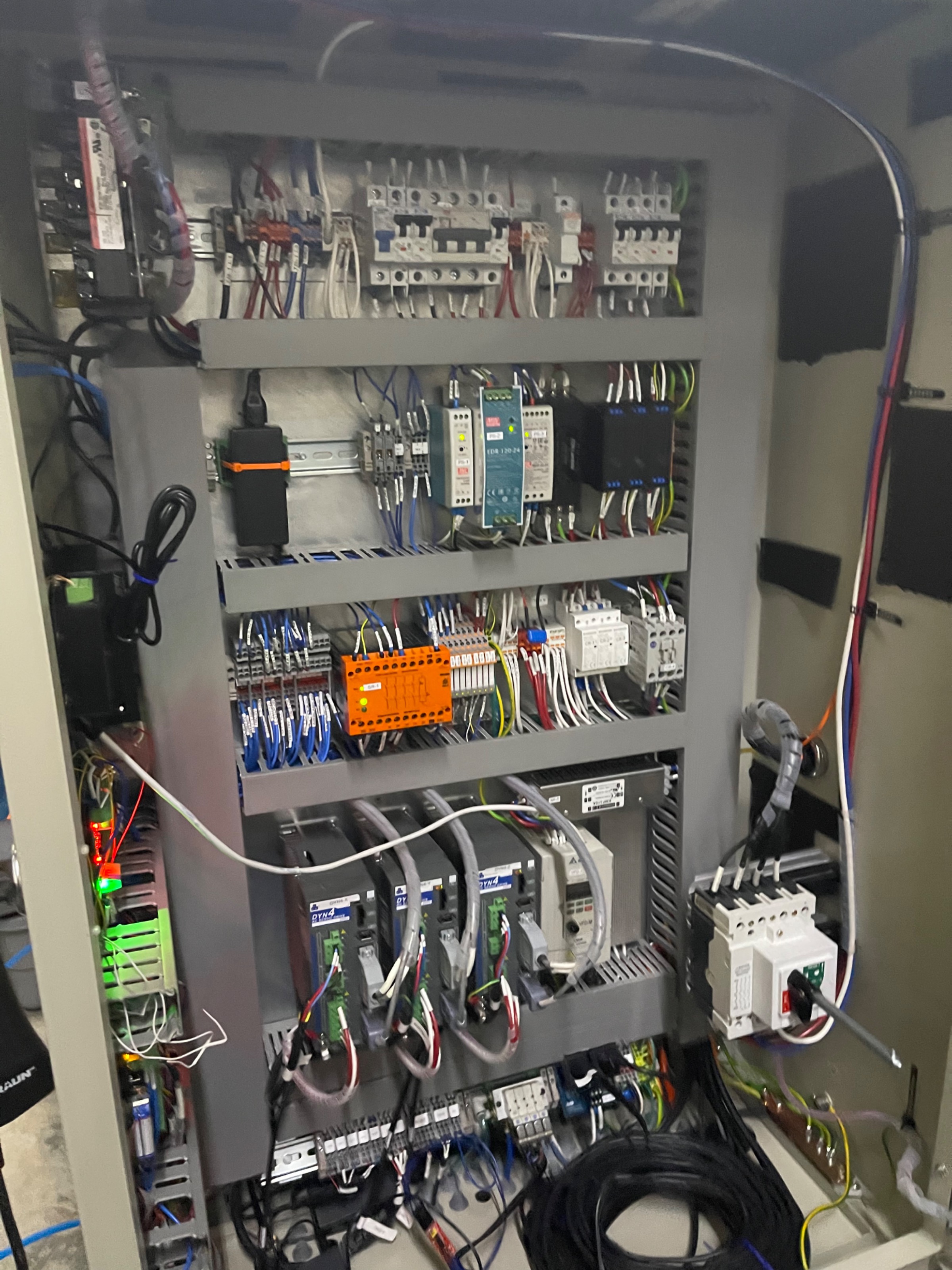

By any chance, does the error occur when you enable the servo drives?
I would have not installed the Mesa stuff that close to servo and VFD drives, it would be much better near 220V stuff if there is no other choice.
If it is a Mesa 7i92M, attach it directly to Mesa 7i77 and remove the ribbon cable, less interference.
And since i am on a roll, if that is a Mesa 7i77, i would venture a guess that those DMM drives are set to velocity mode, but since i see another Mesa card below i might be wrong.

Hi tommylight,
The issue happens with and without the drives are energized.
Furthermore, I already disconnected both cards from the 7i92 and the issue persisted.
And while you are correct in the DYN-4 being connected to an analog signal from the 7i77 with velocity mode since I have linear scales on 2 axes, with the 3rd axes being controlled via Step/Direction from the 7i85, the drives are not enabled due to the mesa card losing communication well before I enable them.
