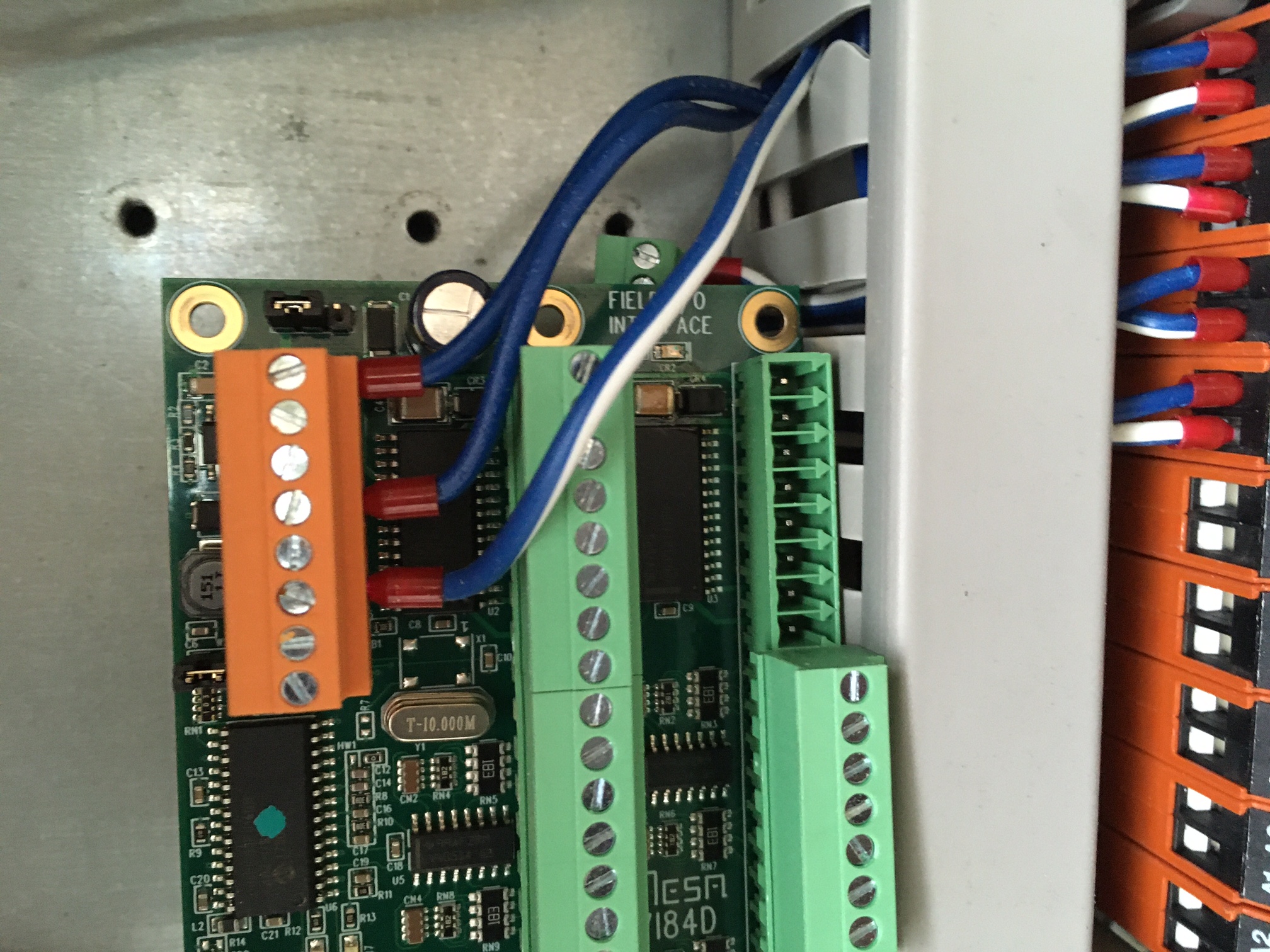

It looks like you have used the top pin as pin 1 . I think pin 1 is at the bottom
www.mesanet.com/pdf/parallel/7i84man.pdf
Replied by Clive S on topic 7I84D and smoke
I just plugged in my 7I84D and it smoked terribly !!!
The smoke came from below the red plug.
Unfortunately I do not know why .....
Attached is a photo of how I connected the 24V!
Can anyone tell me what I did wrong?
blue white = GND
blue = +24V
- Posts: 21980
- Thank you received: 7480
14 Oct 2022 16:17 #254120
Replied by tommylight on topic 7I84D and smoke
Yeah that is reversed and a short!
From down to up (or from left to right on your picture:
1,2,3,4,5 are +24V
6,7,8 are -24V
Chances are the board is burned beneath or under the connector and the rest is still ok.
Wire it correctly and power it again.
Beware that plugging and unplugging the power connector while powered will destroy the board. Also do not switch on and off the DC side or the two wires powering the board, switch the power supply input.
1,2,3,4,5 are +24V
6,7,8 are -24V

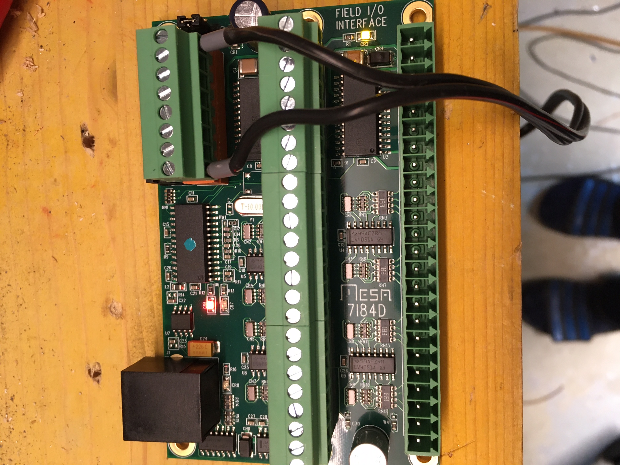

14 Oct 2022 17:41 #254127
by mgm
Replied by mgm on topic 7I84D and smoke
- Posts: 21980
14 Oct 2022 21:27 #254136
Nice, that should be OK for now.
