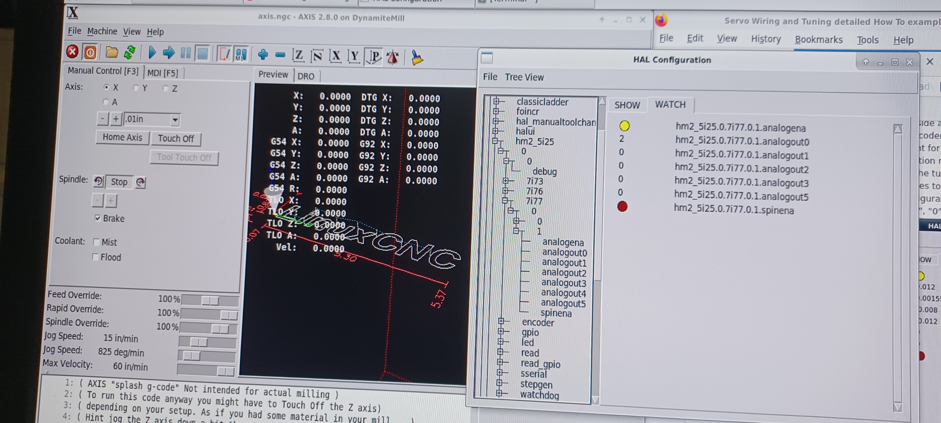

Replied by mloser on topic Mesa 7i77 No encoder activity. No analogout to servo
I attached a screen print,
analogout0 shows a value of "2" during jog,
but volt meter on actual 7i77 pins shows 0 volts.
Mike
Mike

Looking at that, I now wonder if he is looking at the right 7i77, there seem to be two available.
The home switches are on 7i77.0.0 and the axes seem to be on 7i77.0.1
