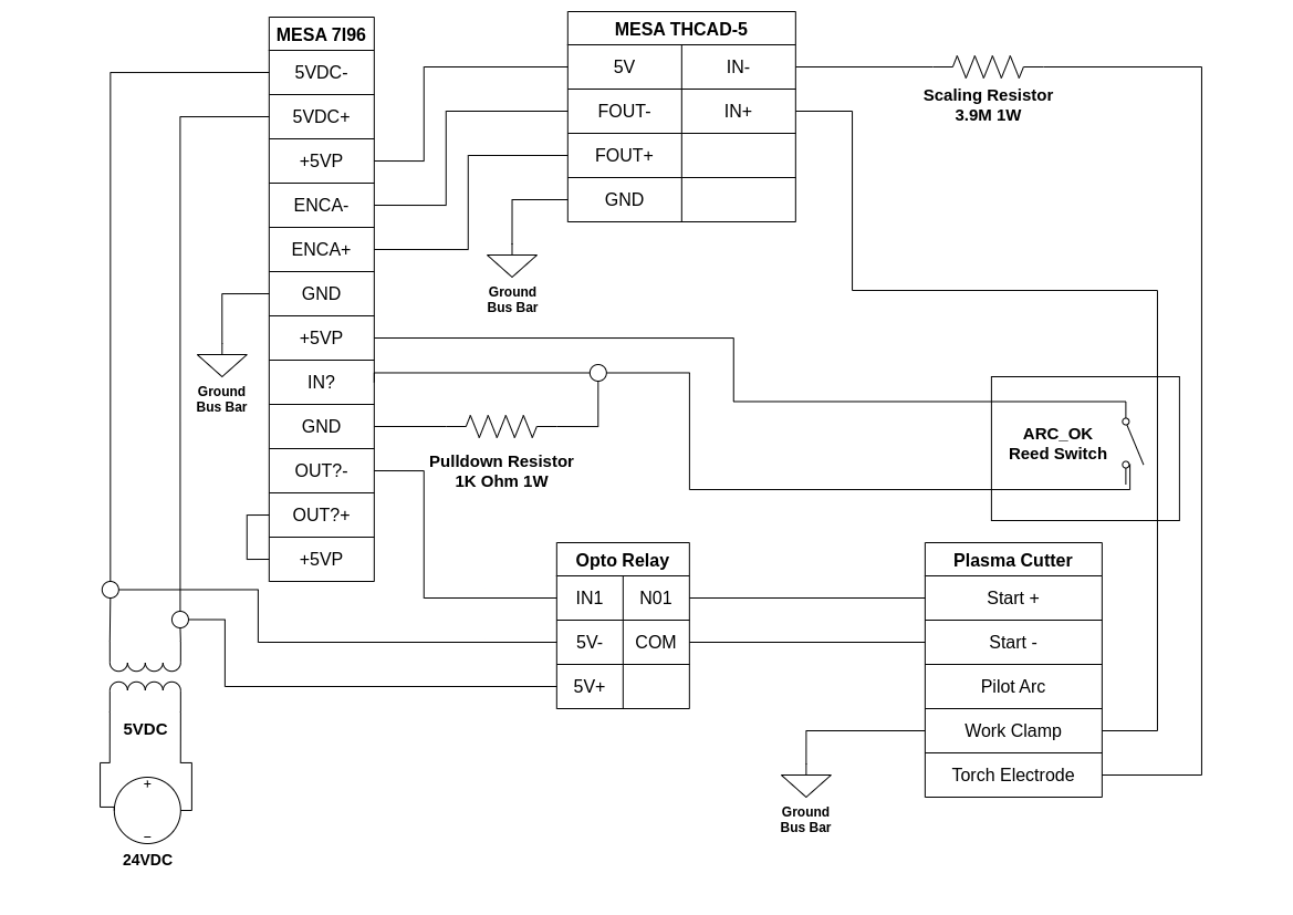

Hello all,
I'm putting together a plan to wire up a 7i96 and a THCAD-5 to my cheapo HF start pilot arc plasma cutter. I would appreciate it if you guys would call out my errors in the attached diagram before I let the smoke out of some hardware.
Plasma cutter: www.stahlwerk-schweissgeraete.de/Plasma-...er-CUT-40-Pilot-IGBT
Voltage divider: proma-elektronika.com/product/plasma-voltage-divider/
Opto isolated relay: www.amazon.com/HiLetgo-Channel-optocoupl...rigger/dp/B00LW15A4W
5V transformer: www.amazon.com/BANKEE-Converter-Voltage-...former/dp/B08NZV88MC

There may not be any need to add the Proma in the equation. Have a look in the thcad manual on how to scale the input.
Also the shield probably should not be connected to the thcad as it can introduce noise into the signal due to AC ripple
Normally, we use a THCAD-10 (to get a 0-10 volt fullscale) but using a THCAD-5 is OK if you already have ordered it.
Then add a scaling resistor to the THCAD to scale the raw voltage so 200 volts will give you a THCAD full scale reading.

Thanks for the response rodw.
I would have preferred the THCAD-10, but I couldn't locate any here in Europe.
I find myself wishing I hadn't bought the Proma PVD. In my case it's just acting like a big, expensive scaling resistor.
Following the THCAD manual, I should need a 3.9M Ohm resistor. Can I assume there are no special power requrements since it's not mentioned in the manual?
Are you referring to the connection between the THCAD-5 SHIELD terminal and the Proma PVD Ground terminal? My intention there was to have a star ground layout with a common bus bar connected to the table frame.

Shield wires are always only connected on one end otherwise your create a ground loop which can interfere with the signal.
JT

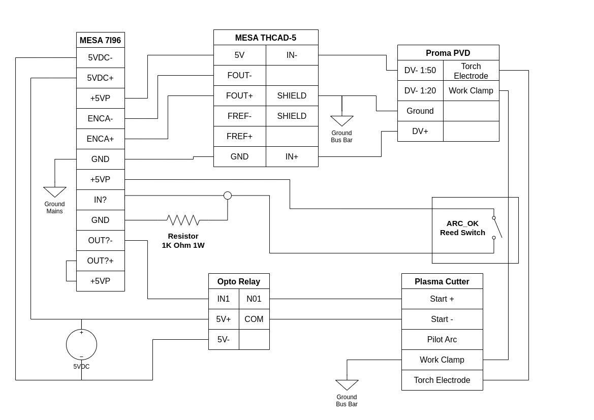

Seeing you have the proma divider, you might as well use it on the 50:1 and no further scaling resistors will be required.
This will give you 250 volts full scale which is fine!
When cutting, it will never go over that. It may do so when percing very briefly when we don't care about the voltage then and it can handle 500 v overvoltage any way.
The THCAD does not seem as simple as that. In many countries, the electrical earth is bonded to the neutral in the meter box. If you connect the THCAD ground to the star ground (which is connected to the mains power electrical ground), you end up with a 50 or 60 Hz ripple introduced to the THCAD signal.
There are some threads on this somewhere.
Whether you shield the interconnect cable or not, its best not to ground the THCAD to the frame.
JT

THCAD high voltage side = no grounding.
THCAD low voltage/signal side grounded at the control box, not connencted to anything on the THCAD side.
On 12 or more machines in daily use, no issues, ever.
I mount THCAD on the back of the plasma source, always, in a plastic box.
I've got another project that could probably use the Proma PVD, so I'm going to try to eliminate it from this circuit.
If I'm reading everyone correctly, the attached diagram should then work.

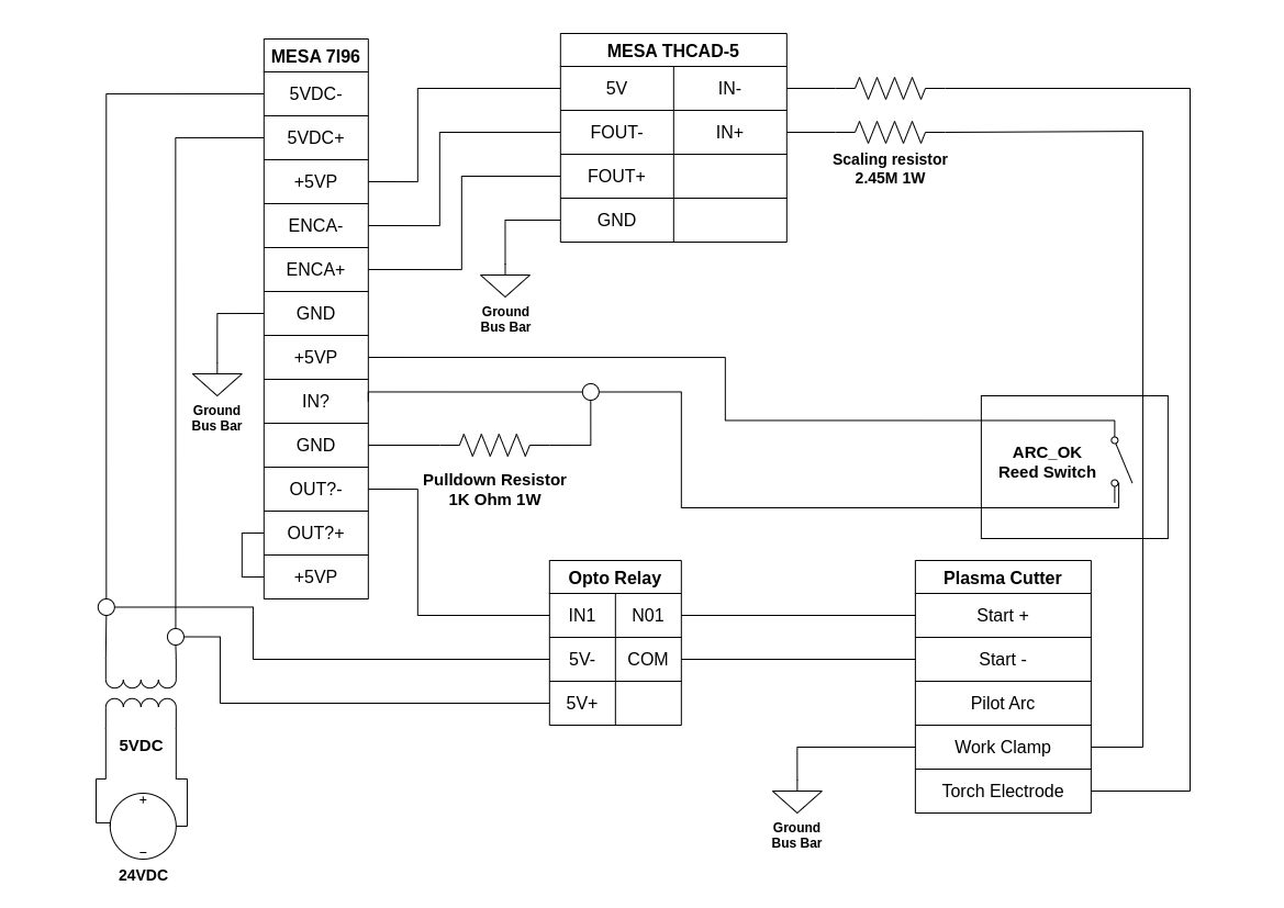

I make it 4.9 M for a 250 volt full scale
Split this in half and put half on each IN terminal
Also, you should be adding a seperate 24 V power supply for the 7i96 field power so the logic power and field power are isolated.
But there is a big problem with you plasma cutter! It is HF start! This is unsuited for the THCAD-5 directly ad it can catch fire from the 25k volts plus on starting. (Has happened here!)
It can only be used if you connect it internally in front of the HF starter. The proma manual shows this too. Tommy is the expoert here, So I'll let him guide you further.

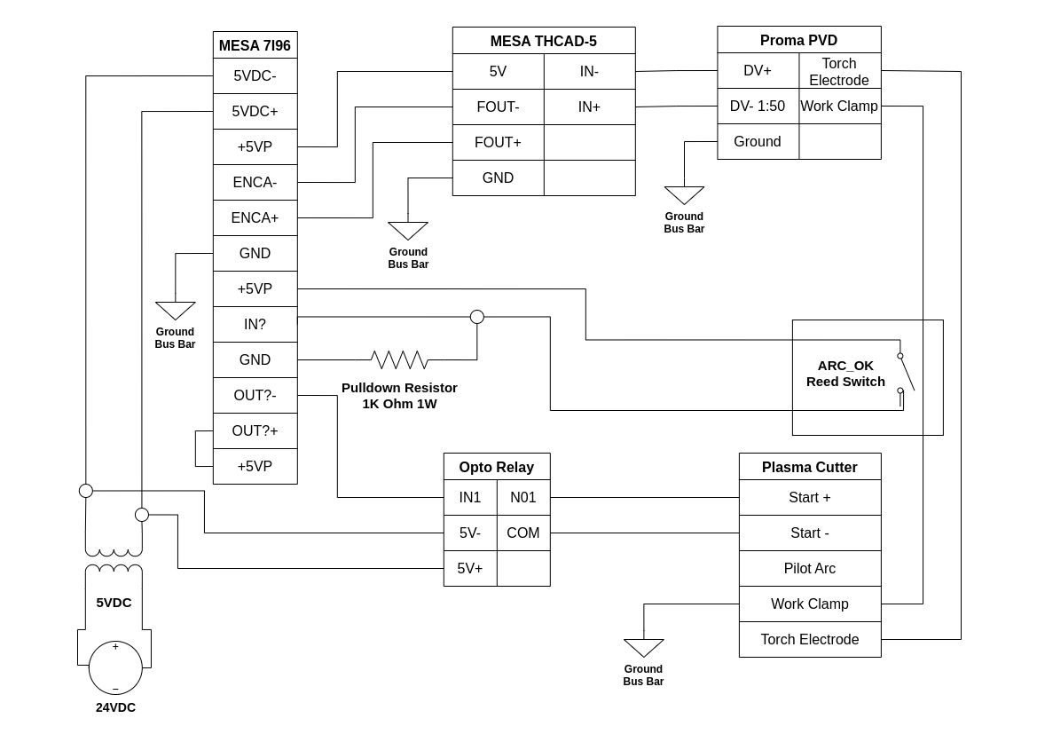

Ah, right. I had forgotten that this is the reason I added the Proma PVD in the first place. Their manual explicitly says that it's OK to connect it after the HF coil, though before is preferable. Maximum output voltage is 36V according to the specs.
My original plan was to have the THCAD and PVD external in a housing so that I could easy move it to another plasma cutter if I upgrade. I realize I might be getting too fancy here though.
That would leave me with the attached diagram (minus one extra power supply).
