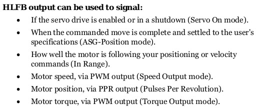

Do people use any of the items from the High Level Feedback in LinuxCNC for "close looping" the system? Are there any advantages?

On step/dir systems it can be of advantage to feedback position from
linear encoders to LinuxCNC if those are present, to increase accuracy.

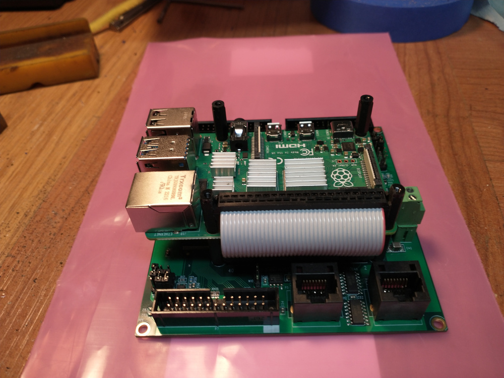

18 Feb 2023 00:44 #264734
by cakeslob
Replied by cakeslob on topic Mesa 7C81 Questions
common gene, show us the money shot
can you post a pic of the other side? i am curious to see how other people are doing the board to board connection

22 May 2023 22:56 #271978
by gene_weber
Replied by gene_weber on topic Mesa 7C81 Questions
- cakeslob
- Posts: 927
- Thank you received: 280
27 May 2023 17:41 #272274
by cakeslob
I see, so mesa has a secret cable that fits in between the standoffs

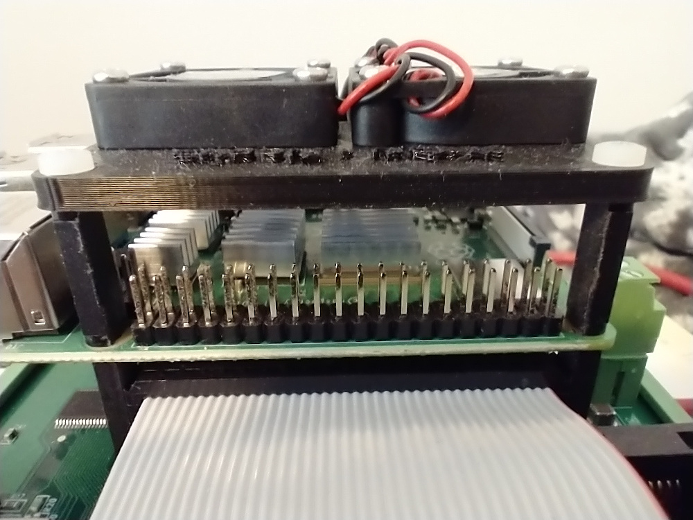

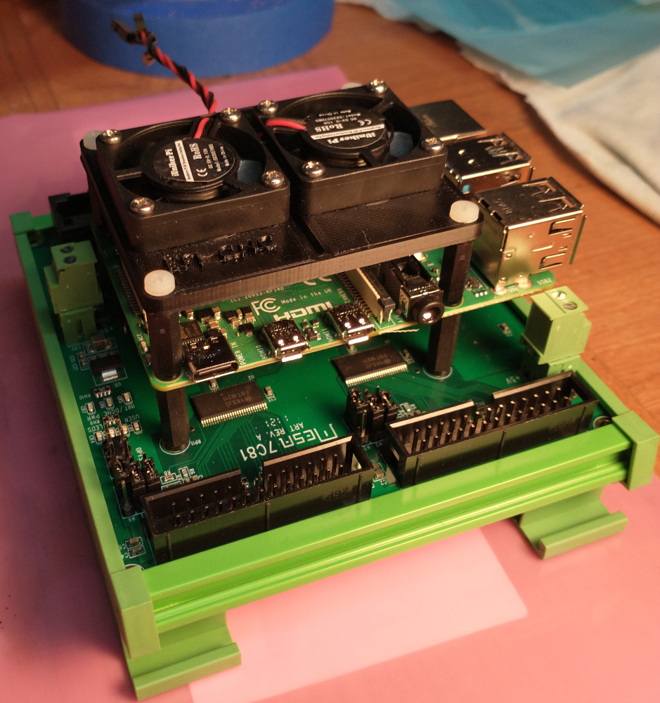

- gene_weber
- Posts: 49
- Thank you received: 19
28 May 2023 22:43 #272371
by gene_weber
Oh, it's top top secret. You have to be an inner circle member to buy it.
I didn't realize what you were specifically interested in. Yeah, the spacing of the holes in relationship to the header on the Raspberry Pi boards does seem like a design oversight. I mounted the stand-offs on the board and tried to plug the cable in and said "what the $@%!#^?". The Stand-offs I bought are plastic, so i put them in a vice and filed them as close to the center hole as possible. If you look closely at the attached photos you'll see that the sides facing the connector are flat. It just fits. I created the "top hat" that the fans are mounted on in SOLIDWORKS, and 3D printed it. So I needed to flat file four stand-offs. Here are the stand-offs and screws I used.

- Stef
- Posts: 31
30 May 2023 16:48 #272506
by Stef
Replied by Stef on topic Mesa 7C81 Questions
Hi Gene,
The 3D printed part looks nice!
I am wondering if you already succeeded in establashing a connection between the RPi and the Mesa 7C81.
As I am having huge difficulties with that for over a month already, I would be very interested to hear how others did this.
Although there are some explanations available on the internet, those all use the "LinuxCNC 2.8.1 Raspberry Pi OS based on Debian 10 Buster" from the LinuxCNC frontpage, but this file is not working for recently manufactured RPi's.
Did you perhaps find installation instructions that are usable for new RPi's?

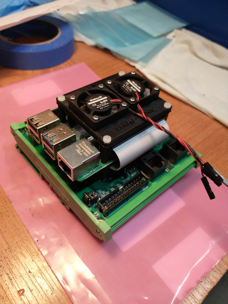

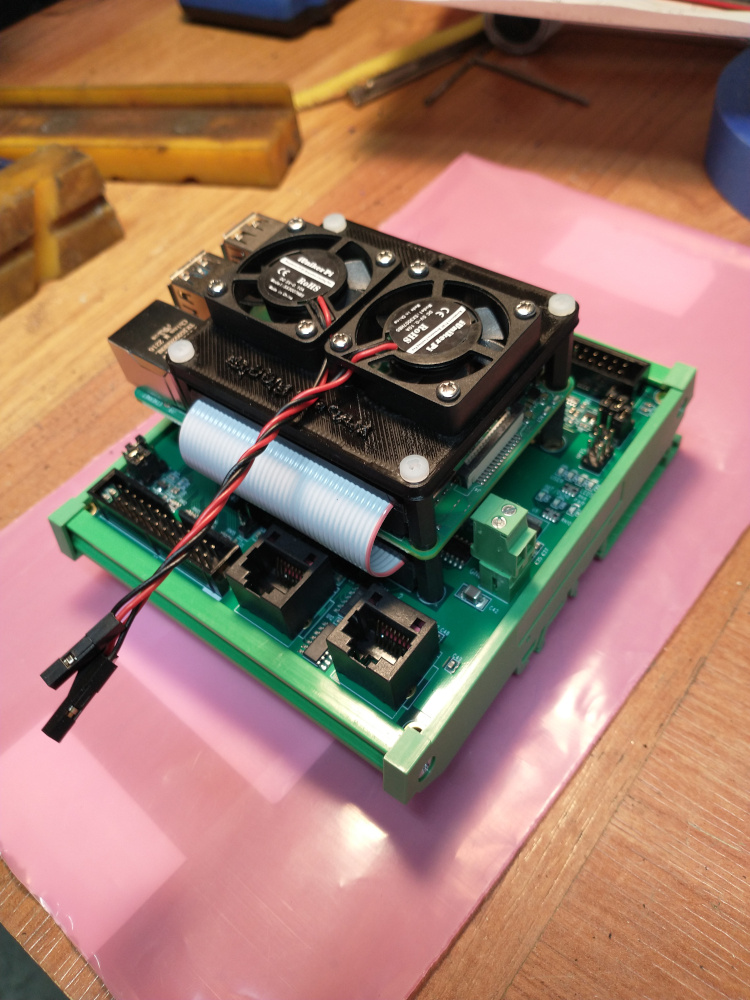

- gene_weber
- Posts: 49
31 May 2023 00:31 #272532
by gene_weber
Hi Stef,
Thanks you.
Powering up the Mesa 7C81 is next. I'm moving at a glacial pace, but life has just been beyond busy lately. My 18 month old grandson gets priority over all. Spent the past weekend working on my car, and it's still not right, but that's another story.
I pretty much followed this thread for the Preempt-RT kernel installation . My setup is only slightly different in that I'm ssh -X ing into the R-Pi from a Linux laptop, so I'm using the laptop for keyboard and display. The Pi's desktop environment is never started. Perhaps if I have some luck I'll get some time to try it this weekend. When I make some progress I'll post it.
