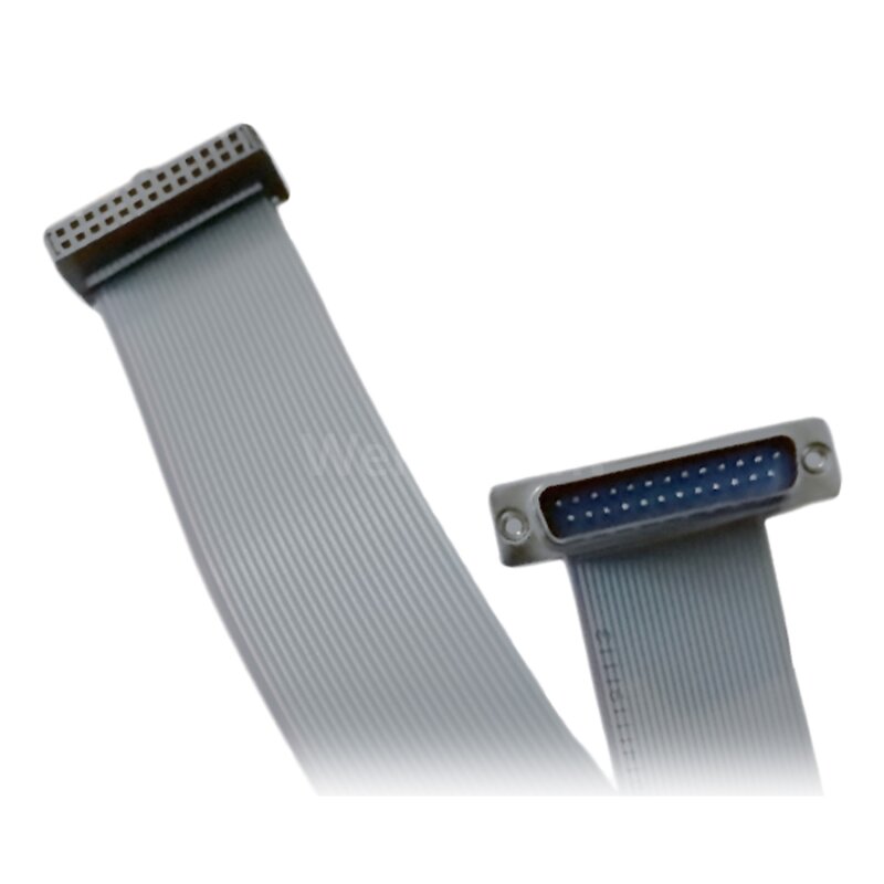

One more pinout related question before I get myself lost in the HAL file -
Does this type of ribbon-cable provide the necessary DCI26-to-DB25 wiring?:
I'm not familiar with the numbering convention for standard headers...

Replied by PCW on topic 7C81 - It appears that I have the wrong BOB, what now?
Yes, that cable is correct (as long as HDR pin1 --> DB25 pin1).
Note that you need to disable stepgen 4 to get access to the relays
on DB25 pins 2,3: num_stepgens=4 or num_stepgens=3 if you only need 3 axis.

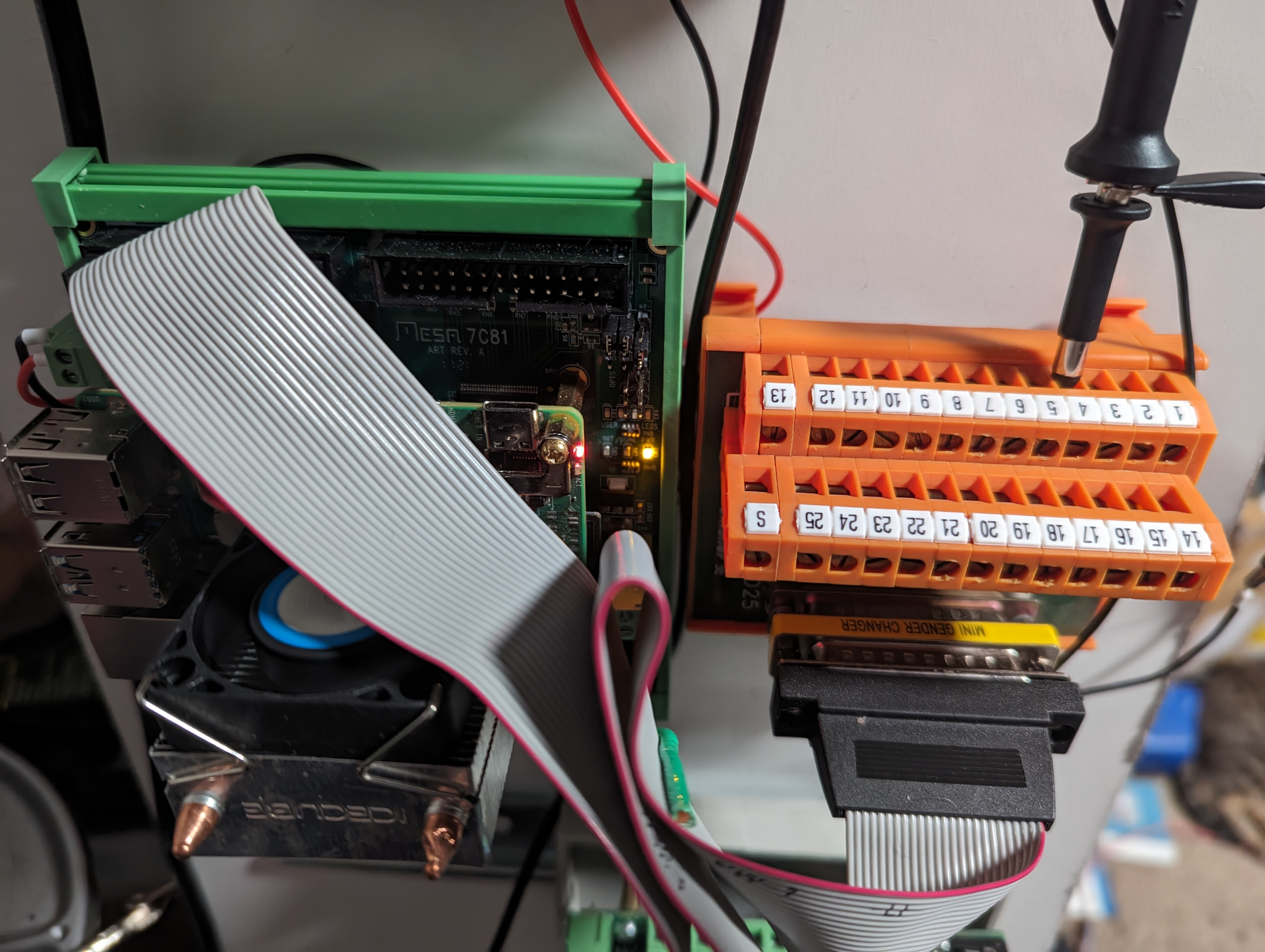

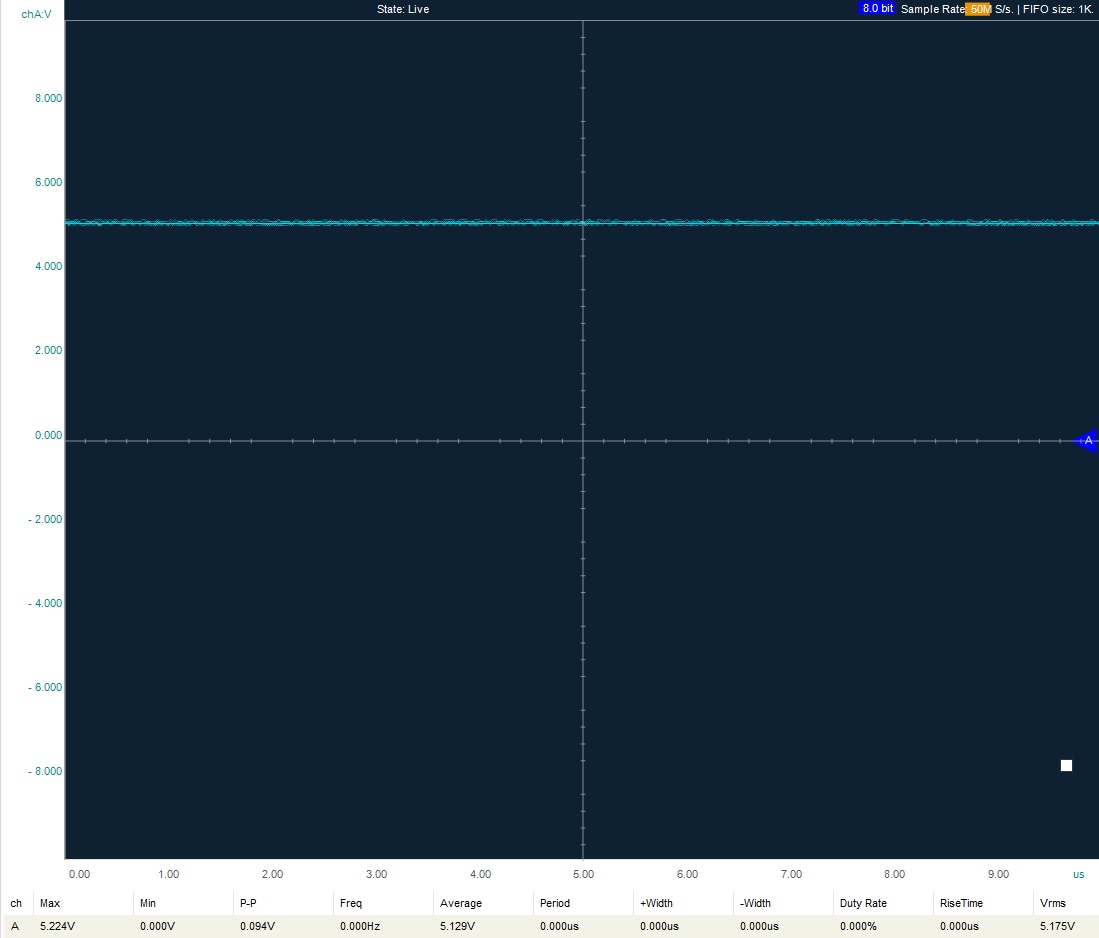

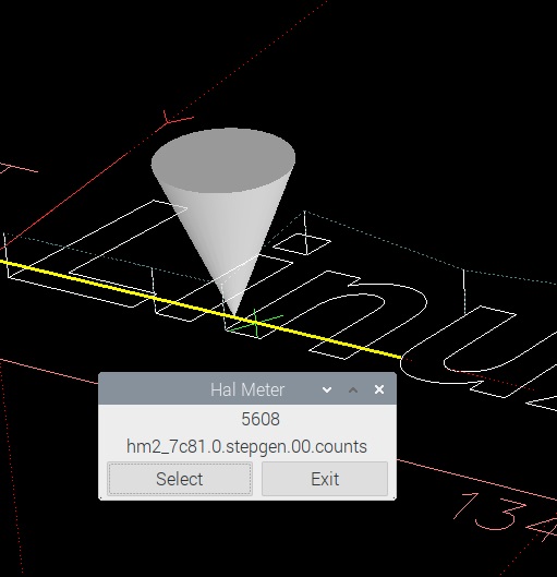

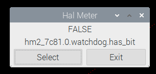

I'm looking for signs of life in the I/O and haven't been able to find any -
(If I should open a new thread for this, please let me know...)
I ran:... and rebooted.
Then I ran:which gave meLooking in the PIN_ file, I see:
(just showing P1; simplified for clairity)And I ran the Pncconf Wizard with as many of the default settings as possible for a 3-step/dir and 1-PWM machine. I used INI substitution, unchecked any options under "Defaults and Options", and configured temporarily for "5i25-Internal Data" with "G540x2" almost identically to how it was done in this video (except for XYZ and not just XY):
I then adjusted the card name in the INI from "hm2_5i25" to "hm2_7c81", and updated the HAL file with "loadrt hm2_rpspi ..." to account for being on a RapsberryPi.
I then pulled out my oscilloscope to check for signs of life on the x-axis' step pin, as below:
I then proceeded to manually jog along the x-axis and looked to see if the oscilloscope saw anything as I did.
All it saw, at any resolution, was a solid 5.129 volts; no waveform at all...
I check other pins in this manner, and it's all more-or-less the same story at 5 volts or 0 volts.
What am I doing wrong?

...I then adjusted the card name in the INI from "hm2_5i25" to "hm2_7c81", and updated the HAL file with "loadrt hm2_rpspi ..." to account for being on a RapsberryPi.

If if the watchdog was triggered, how do I check?
I assume that it would keep me from moving anything, but Hal Meter says steps are still being sent:
- edit -
Doesn't seem to be the watchdog...
