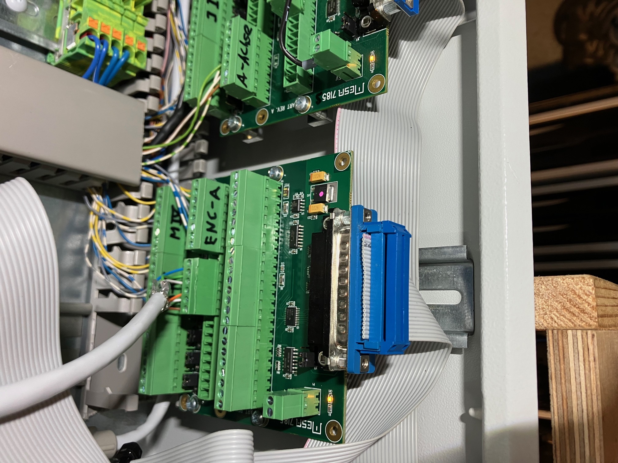

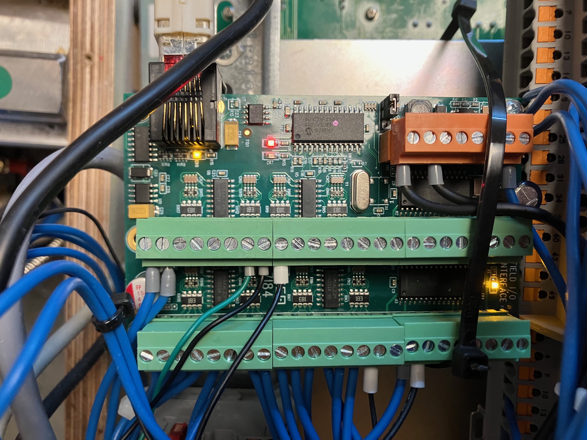

My machine setup is 7i76e+7i85+7i85s+7i84.
I tried to connect the 7i84 card to my 7i85 card but without success. It's necessary to open a second sserial port in bit file? I see only one on startup on the 7i76e card.

You likely need to edit the sserial_port_0=something
line in your hal file

The linuxCNC startup message only shows active sserial ports
Does the 7I84 work in the 7I76's expansion port?
What does mesaflash --device 7i76e --addr [ipaddr] --readhmid report?

No, the 7i84 not work on the 7i76e expansion port. That was the reason to change.

If it doesn't work on either, that suggests a wiring or power issue
Does the 7I84 have field power?

Yes, it works on my other 7i76e properly. I guess there is something broken.
So i had the idea to add a second smart serial port on the 7i85 card. Is this possible?

Not sure what you mean, the 7I85 and that firmware have 8 channels
7I76E 0,1
7I85 2..6
7I85S 7
Does the 7I85 have power? Do the 7I76E and 7I85 cable power jumpers match?
Note that older 7I76E firmware will not enable the 7I76E sserial port on newer
(> RevA ) 7I76E's
Also the 7I85 sserial ports have 8 pins instead of 6 (you plug a 6 pin connector in the middle of the 8 pin section)
Does CR8 (RS-422 power) illuminate on the 7I84?
7I76E 0,1
7I85 2..6
7I85S 7
(> RevA ) 7I76E's

I plug the socket one pin more and now the card will show. But linuxcnc not start.
config in hal is "sserial_port_0=202xxxxx"
Do i need to config some more?
