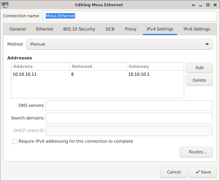

Did the ultimate bonehead and reversed the 5v input polarity.
What did I damage?
My confusion comes from never ever getting a confirmed working setup previously.
I don't seem to be able communicate with the board now, The power light is orange, none of the user lights are on but they do cycle through on startup.
What did I damage?

Can you ping the card?
ping 10.10.10.10
(if the card is set for 10.10.10.10 = W4 down W5 up and host PC setup properly)

I got this from the ping.
I am a classic rookie on all this and this connection problem has haunted me on two different PC's, I am not sure I ever got a working connection then or now. I do now have a workable PC and a 95% built controller cabinet to test the capability of the card.
I have noticed when I am connected to the "Mesa Ethernet" connection wifi no longer works, I would like to figure out how to fix that because that makes troubleshooting all this very cumbersome.
It is possible that I changed the EPROM IP last year when I was trying to set this up on the other PC.
Would it be smart in that case to try the dn/dn jumper setting and using 192.168.1.121?
I did try that already with the same results.
Replied by CarterKraft on topic Mesa 7i96s 5v supply reverse polarity damage
I followed this guide with the jumpers as described (w4 down w5 up).Can you ping the card?
ping 10.10.10.10
This is the screenshot of the Ethernet setting page.
Last edit: 04 Sep 2023 16:44 by CarterKraft.

What does the command
ip a
return?

Two things I would try:
Disable ipv6
set the netmask to /24
Disable ipv6

the results, still no device reachable via ping
root@CKCPlasma:/home/weldon# ip a

IPV6 is still enabled and the netmask is still /8
