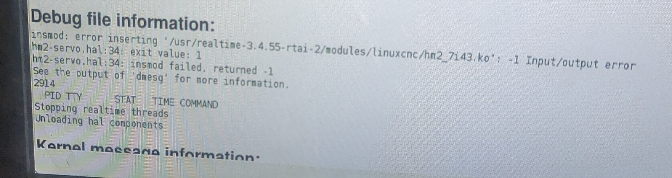

I am getting an error code when loading up LinuxCNC. I have the mesa boards installed. Error code: ' /usr/realtime-3.4.55-rtai-2/modules/linuxcnc/hm2_7i43.ko' : -1 Input/output error. could someone help me troubleshoot the error?

Error report, especially the debug part.

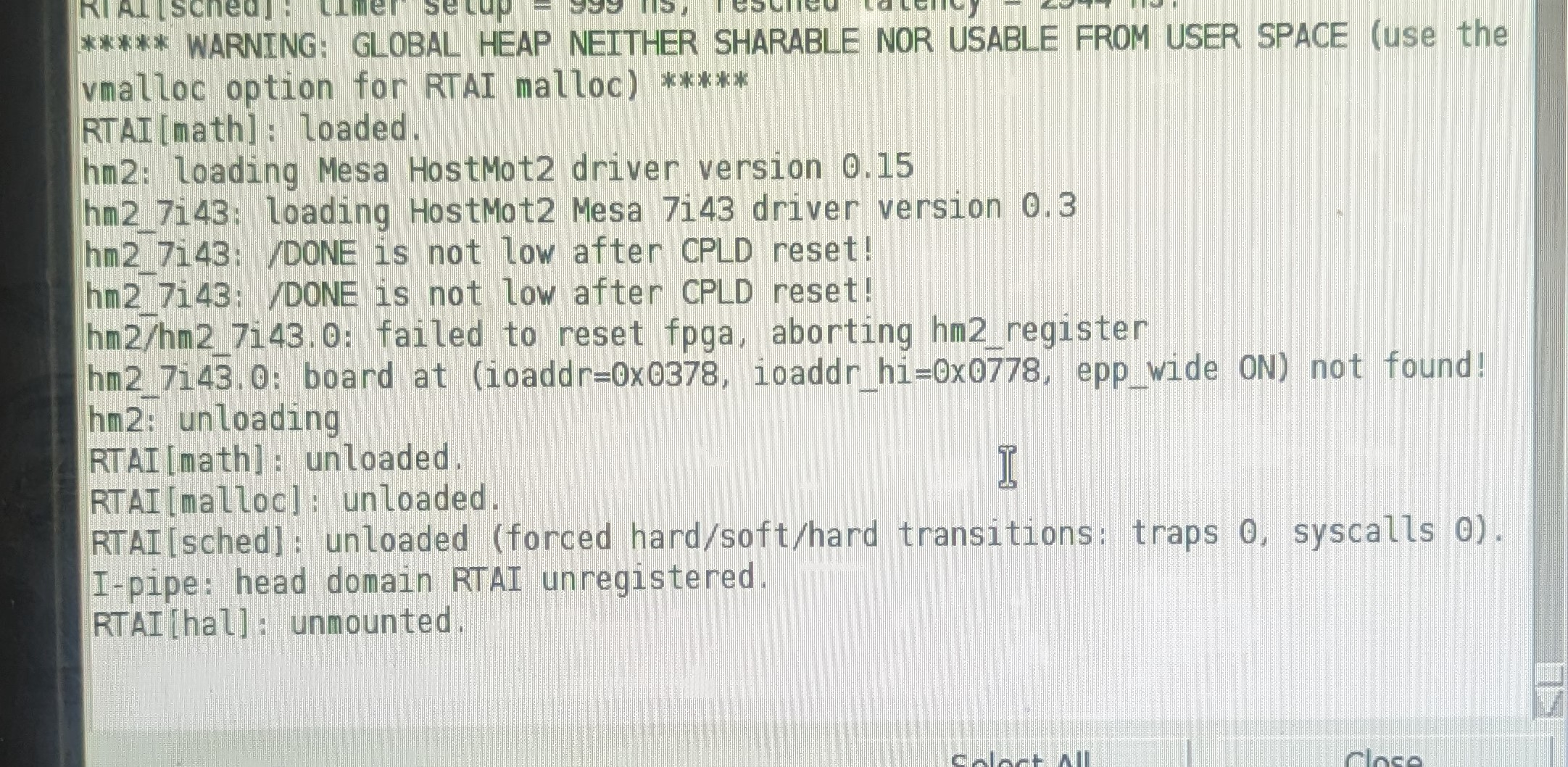

01 Nov 2023 11:30 #284246
by tda2261
Replied by tda2261 on topic LinuxCNC error

LinuxCNC did not find the 7I43 card.
some possible causes are:
7I43 not in EPP mode (7I43 jumper setting)
No 5V power to 7I43
Bad 7I43
Bad parallel cable or 7I43 not connected
Parallel port not in EPP 1.9 mode (BIOS setting)
Bad parallel port

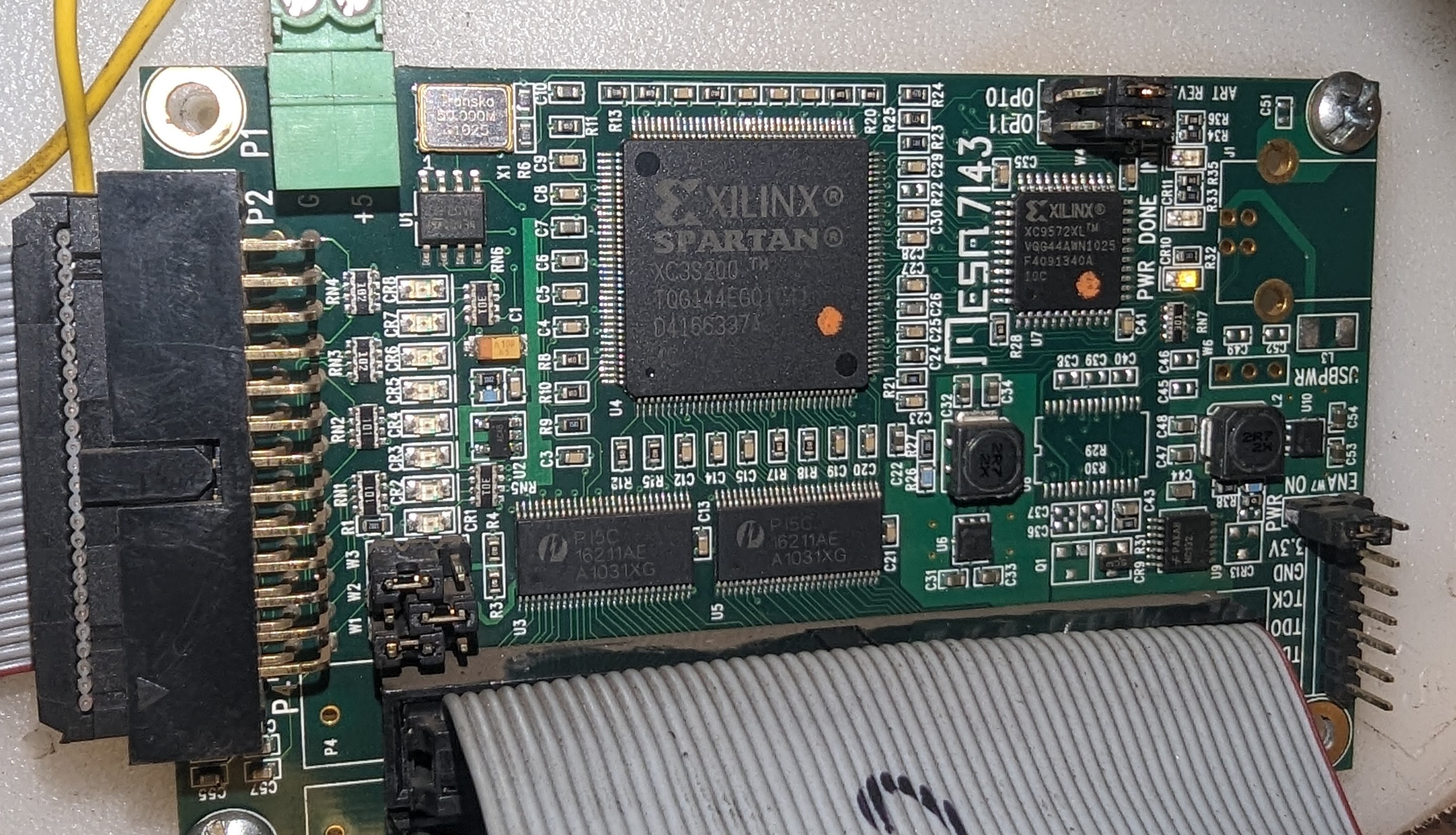

On the 7I43, W4 and W5 down,How do I check or change it into EPP mode?
On the BIOS it depends but there is usually an I/O setup section
and you can select the parallel port address and operational mode.
Is the 7I43 connected to a motherboard parallel port connector?

The board looks correct, do i need to change anything?

i am still getting an error after
