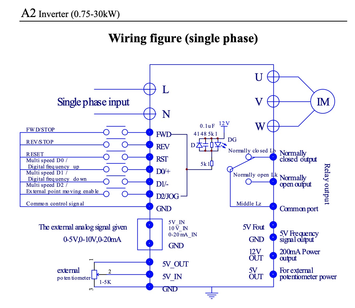

Hi, we're 2 students from Belgium and our final project is to make a retrofit for a milling machine.
The 3 axes work fine, but we're having trouble with the spindle, the mesa card doesn't deliver any signal to the spindle drive.
We're using gmoccapy ver. 3.1.3.8 with Linux ver. 2.8.4 we're also using A2 Series VFD.
We can activate "left" and "right" on the gmoccapy UI.
How can we check what we've done wrong.
Thank you in advance for a response.

When LinuxCNC is running and you expect the
spindle to be running, type this in a terminal:
halcmd show all | grep spindle
and post the results here
Also measure the voltage between 7I76E TB4 pins 1 and TB4 pin 3

Hi sorry for our late reply, this is what showed up when we typed in the command in terminal.
We also measured 0V between pin 1 and pin 3 when the spindle was supposed to be running.

Did you wire it correctly? Can you share your wiring diagram?
The Mesa 7i76e doesn't provide 0-10V by itself. You need to provide 0 - 15V (max) to SPINDLE- / SPINDLE+. The SPINDLE OUT needs to be scaled in your INI based on that voltage.
Example with 12V to create a 0-10V output
[SPINDLE_0]
# 0-10V output based on 12V input
MAX_OUTPUT = 24000
# 12V = 28800 rpm / 10V = 24000
OUTPUT_SCALE = 28800
Wiring:
Mesa 7i76e:
SPINDLE- <-> VFD GND
SPINDLE OUT <-> 10V_IN
SPINDLE+ <-> VFD 12V OUT
SPINDLE ENA- <-> VFD GND
SPINDLE ENA+ <-> VFD FWD/RUN
Optional:
SPINDLE DIR- <-> VFD GND
SPINDLE DIR+ <-> VFD REV
[SPINDLE_0]
MAX_OUTPUT = 24000
Wiring:
Mesa 7i76e:
Optional:

the wiring is was given on "
forum.linuxcnc.org/27-driver-boards/3537...mesa-7i76e#gallery-4
if i understend it correkt the vfd give power to the mesa card for the spindle output
on tb4 pin1 and pin 3 are the powersuply for the analoge out of the mesa card and the vfd provide these power
while pin 2 is the real voltage output
the mesa card act as an potentiometer ?
pin 6 and 8 had also 12 / 24 v this is also power deliverd from the vfd
this is very confiusing witch pin is input and witch is output on the mesa card and on the vfd
same problem for the dir and enable pin here the vfd give power and the mesa card act like a switch ?
Last edit: 2 years 9 months ago by fons.

Andy also explains it here:
forum.linuxcnc.org/27-driver-boards/3537...to-mesa-7i76e#119013
The VFD provides an isolated GND (ACM = analog common) and 10V output (preferred) to the Mesa card (Spindle- / Spindle+). Spindle out is a potentiometer, like you said.
In this case the input voltage is 12V and that needs to be scaled down to 0-10V. This happens in your INI.
Take GND also from the analog section.
Enable and direction are isolated outputs allow sinking, sourcing combinations of both. Most chinese vfd are NPN inputs - you need to provide GND (DCM = digital common) to their input to close the circuit.
You take the GND from the vfd and connect it to SPINDLE ENA- and from SPINDLE ENA+ back to your VFD (input). That way you are providing GND to the VFD input, when the relay is on. Same for the direction.
Most VFD's have ACM (analog common) and DCM (digital common) but I couldn't see that in the A2 manual.
Say your inputs are PNP (24v)...this would require a 24V signal. You would take 24V from the VFD to Spindle ENA+ and back to the VFD on SPINDLE ENA- to your input.
Last edit: 2 years 9 months ago by 0x2102.

We've re-adjusted our wiring as you showed in your previous message but we still don't understand how you got to the 24000 for the MaxOutput and 28800 for your output scale, is this a set value or is there a way to calculate the 24000.
In the Pncconf we're also clueless as to what the value should be for "encoder scale" .
The spindle can't spin in reverse, and the "rev" light on the VFD doesn't light up either when we put it in reverse, do you think this has something to do with the configuration of the VFD or is it something we have to resolve through the INI file.
Thanks in advance.

Since you didn't specify the spindle you are using, I assumed a standard 2.2kW / 24000 rpm spindle. I think in order to better help you here you need to share way more details about the hardware / machine you are using. You only need the "encoder scale" if your spindle actually has a physical encoder for feedback, connected. Typically you need to lookup the Lines per Revolution. I would ignore the encoder portion for the spindle and just run it with no encoder feedback 0-10V.
It all starts with how much voltage (0 - 15V is possible) you are connecting to your Mesa spindle TB. The Mesa acts as a potentiometer that can output 0 - 100% of the voltage you apply.
12V / 10V = 1.2
MAX_OUTPUT = actual drive speed in RPM
OUTPUT_SCALE = actual drive speed in RPM x 1.2
Example with 12V:
MESA PIN: SPINDLE- GND
MESA PIN: SPINDLE+ 12V
MESA PIN: SPINDLE OUT 0 - 12V
Your VFD wants 0-10V, so you need to scale it:
# Example for 24K rpm spindle
[SPINDLE_0]
MAX_OUTPUT = 24000
# Example for 3000 rpm spindle (e.g. Lathe)
[SPINDLE_0]
MAX_OUTPUT = 3000
# 12V = 3600 rpm / 10V = 3000
OUTPUT_SCALE = 3600
12V / 10V = 1.2
Example with 12V:
[SPINDLE_0]
MAX_OUTPUT = 24000
[SPINDLE_0]
MAX_OUTPUT = 3000
OUTPUT_SCALE = 3600

We're having issues with TB4 on the mesa 7i76e, there is no relation between the output state and the command from the CNC.
How can we check what the problem is or why it could be that nothing is happening and how can we manually check the state of the outputs.
We already put a 24v signal over the outputs and measured them and they didn't work.
Thanks in advance

How is the 7I76E wired to the VFD?
