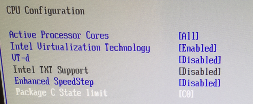

I read a lot of this issue so sorry for opening another topic but i don´t get it working.
- Using a mesa 7i76e
- Error occurs after 30 minutes to about 2 hours runtime.
- I allready disabled the CPU power safe options (i read in other topics here), see attached
- I allready increased the servo thread time to 2 ms - same issue
- My Ethernetcard is an Intel I219-LM
- CPU is i5 6500T
- Kernel version PREEMPT_RT Debian 6.1.55-1 (2023-09-23)
What I read in some other threads is that I have to disable something in IRQ coalsion Setting for an Intel network card. But I have absolutely no idea how I should do this? This seems to be the only thing I do not did for now. Can somebody introduce me step by step?

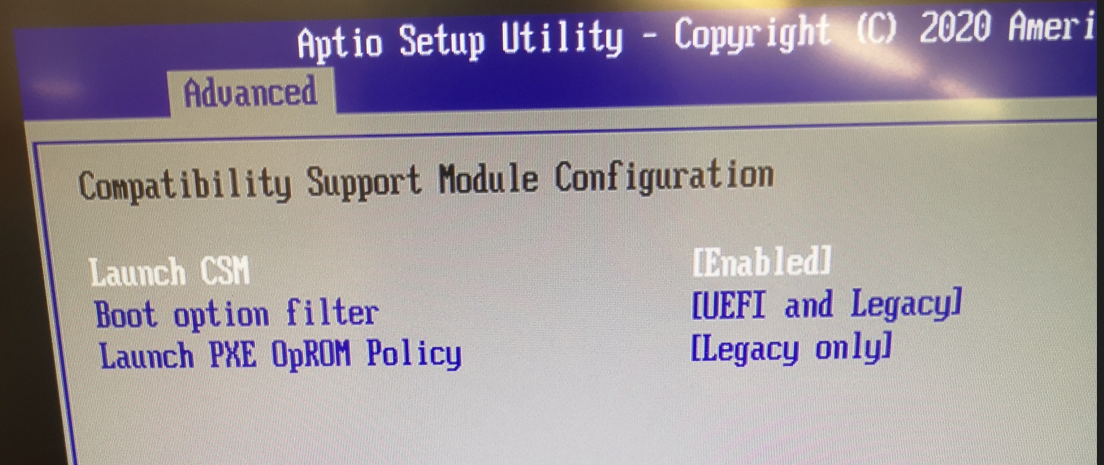

Is the computer setup for UEFI mode?
(there is another thread using a HP EliteDesk Mini G2 with a I5-6500T that had
network latency issues in legacy BIOS mode but was OK in UEFI mode)

Hard to find out the UEFI / Lagacy issue. In Bios both seems to be activiated, see attached. But I don´t know how the linuxcnc was installed. If computer choosed UEFI / Lagacy. Is there an information in Debian visible? For Windows I found a lot of informations in googel, but for Debian?!
ethtool is an unknown command. Before I wanted to install it (I am a bit afraid of chrashing my current installation because I don´t know what I am really doing in linux sometimes), I want to go on to modify the interface file hm2_eth. I read the docu, but there is no information how to it?

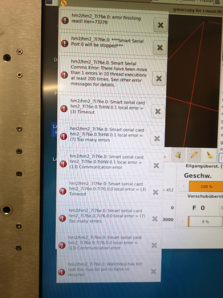

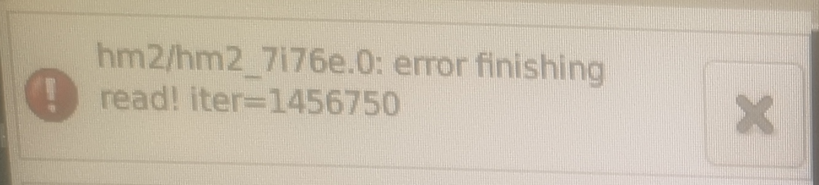

A long time ago the error was gone. Now on my final way to finish my mashine I am noticing this error again more and more. Because I am still setting setting up a lot of things I restarted linuxcnc and focusing on my work.
Today it happens 2 times in about 15minutes. It happened when I was playing / changing the speed of the spindle drive. So I thought it could be an emi issue. I changed my wiring of the ethernet cable straight from pc to Mesa. Before it was interrupted on the wall of the cabinet with a feed trough connector (this connector was in contact with the cabinet potential earth). Inside was a unscreened 20cm ethernet cable to Mesa. This is now replaced by one screened ethernet cable from pc to Mesa, without using a feed trough connector.
Few minutes later, after I did this. I got the next error "watchdog has bit" and a lot more faults, see attached. What is the initial fault? The packet loss on ethernet or has the watchdog trip something to do with the smartserial in this case? On smartserial is my handweel. Can I see somewhere on the pc how close I am for triggering one of these errors? If there is option, I will try to Analyse the emi noise and elite it. Spectrum Analyse and HF current probe is available, but I need an indicator when packages?! are lost or the delay increases.

The "Watchdog has bit" error typically indicates major latency issues on the host
What are your ping times if you ping the 7I76E?
ping -i .2 -c 4 10.10.10.10
sudo chrt 99 ping -i .001 -q 10.10.10.10
The first command populates the ARP cache so the ARP lookup doesn't add time to the first ping
The second command should be run for a few minutes (and the stopped with a control C)
