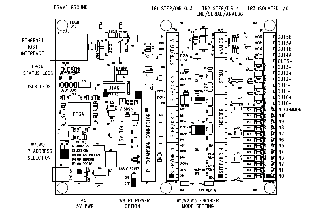

I have purchased 2x 7i96s Mesa cards. I have found the PDF documentation to be rather good except for the PCB overlay images which are unreadable when printed out

I don't see an issue with the pdf drawings (just printed both)

Try to read the USER LED designators on the attached pic. Or the W_ jumper designators. Perhaps it is my PDF viewer?

Replied by tommylight on topic Mesa firmware versions and updating
See above, right click and choose "save picture as"
It is huge...
You can use Inkscape
sudo apt install inkscape
to open Mesa PDF files and resize/clean/print as they are easily converted to SVG (scalable vector graphics).
