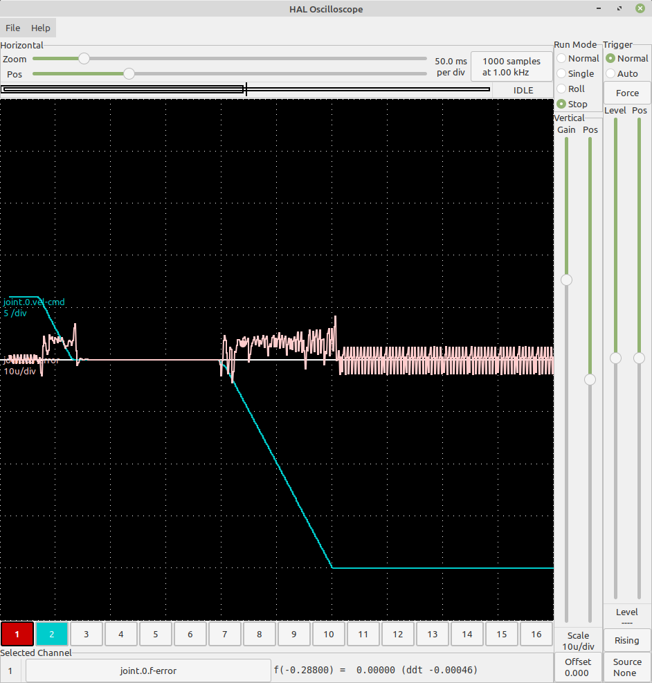

Hi, I'm running 2x lot port +bobs but add on lpt card died on me and I can't find a replacement.
I'm tempted by Mesa Io cards and anticipating my pc dying too(it's core duo lga775 dell antique) I'm considering thernet cards 7i96s to be specific.
I like all on one solution with one cable for pc and not having to deal with chinesiumn BOBs.
Now, I was running 10khz servo thread, but I read that 1khz is "standard for Mesa ethernet 2khz possible and 4khz extreme, reported by one user here.
I'm afraid that even at relatively slow feeds/rapids and accelerations I'll run into overshooting problems, in the end 1khz servo thread and 100mm/s rapid moves 0.1mm between updates.
It's been a while since I went through the set up, so probably I'm mixing something important here but wouldt 6i25 be better at that respect?

You were probably running base period at 10kHz, not servo period, although it might be, there is no need for it.
I have big industrial machines running 1kHz servo periods with Mesa hardware, never had a single issue in probably more than 10 or 15 years (getting old...).
A single Mesa 5i25 (PCI) or 6i25 (PCI-E) or 7i92T (ETH) can replace both prallel ports, and can do steps at MHz rates on any of 34 pins, while parallel is limited to 5-20KHz.
A Mesa 7i96S would be a better choice, much simpler wiring, and if you do need more I/O, you can use one of the old BOB with it, just needs an IDC26-DB25 adapter cable.
