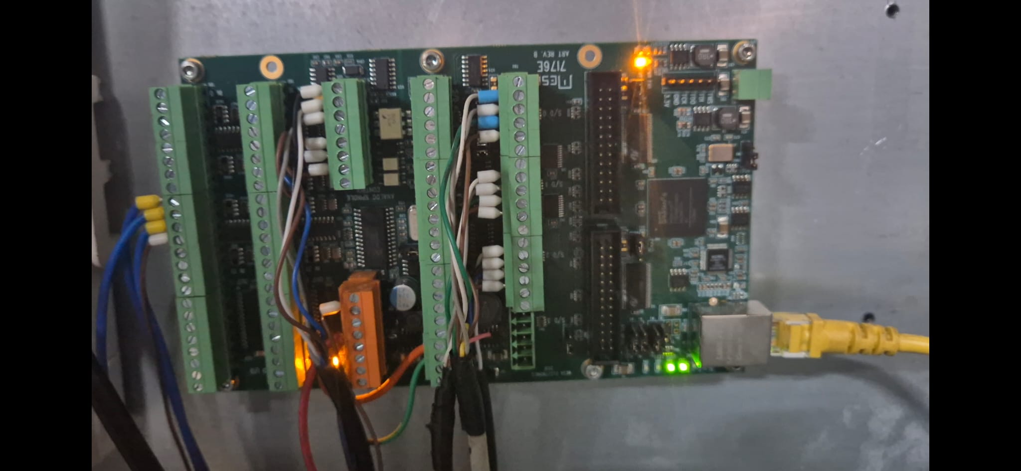

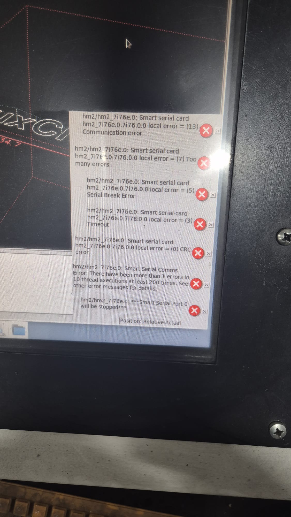

by SertanATL
7i76e I/O Input Field Stopped Working was created by SertanATL
I am running 7i76e with linuxcnc 2.8.4 for a engraving router for a year now and today it started to give a fault while machining(file attached). After 5 minutes it stopped working entirely and gave me a warning at the start saying input-08 is not plugged in. I removed the number 8 from Pncconf and tried again but then it was input-09. I removed all of them it was the spindle, after the spindle machine turned on. XYZ axis work no problem but nothing else. I then swapped the 7i76e from a different machine that I have and problem was solved. Is my card dead or is there something that I can do?

Replied by PCW on topic 7i76e I/O Input Field Stopped Working
Those errors suggest a problem with either the 7I76E field I/O side power supply or
serial communications (not a specific issue of the inputs)
If you contact Mesa by email, they can issue a RMA for analysis/repair/replacement
of the card.
