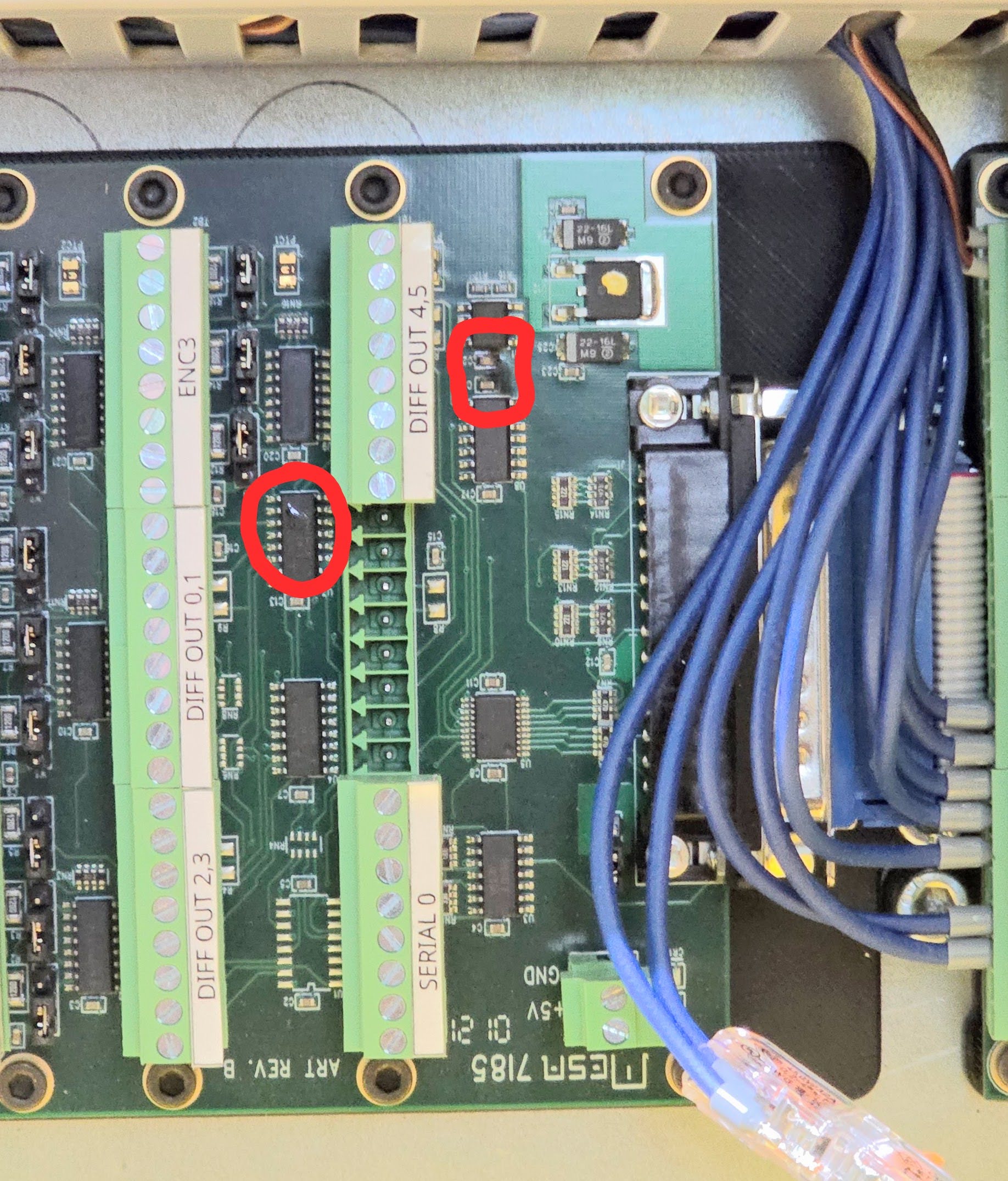

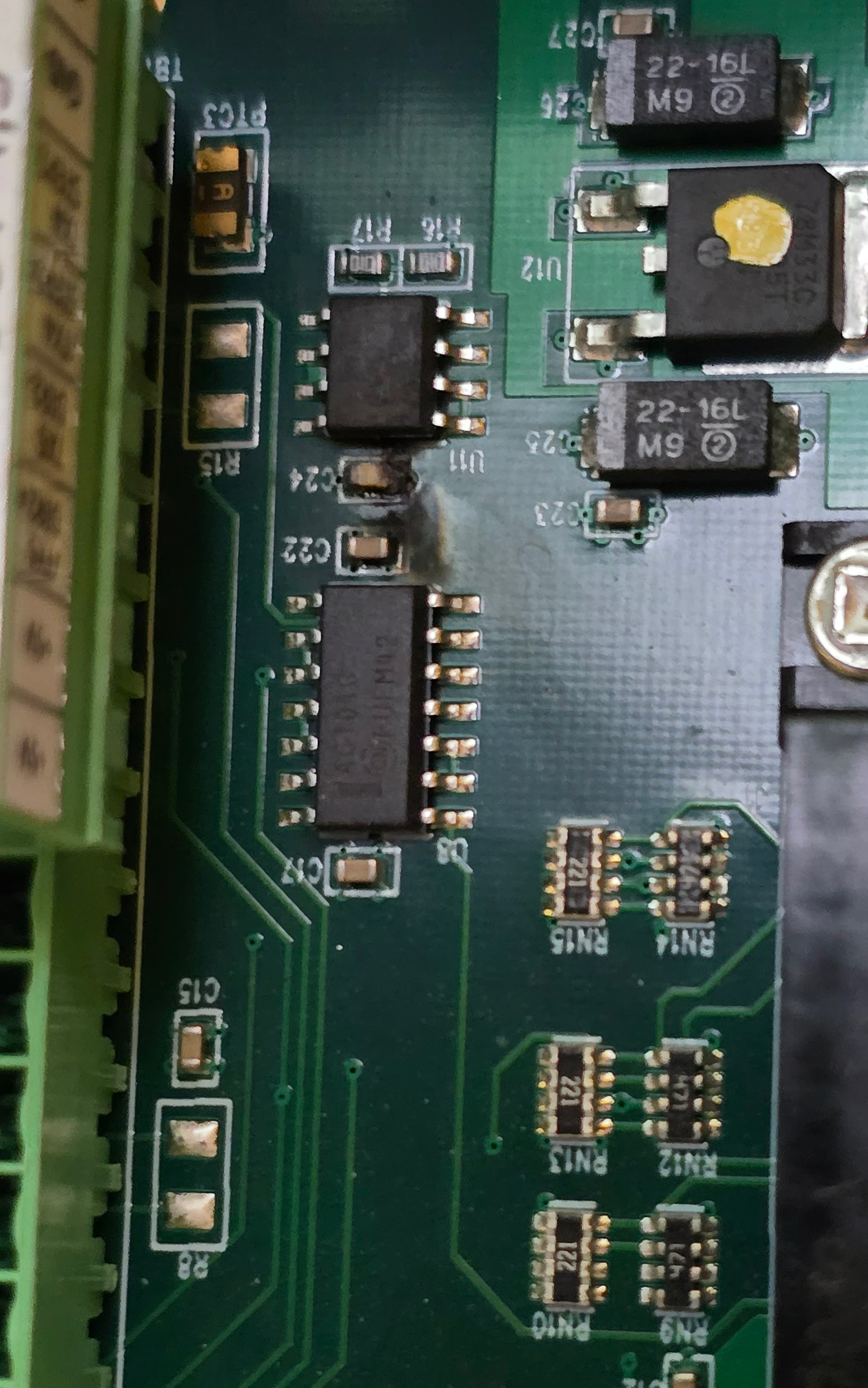

After powering down the machine and disconnecting the wire between the lubrication pump’s contactor and output 6, I turned the power back on. While sitting in front of the control cabinet and moving some wires around, I saw smoke coming from the 7i85S board next to the 7i76E. It appears that capacitors C22 and C24 have blown, and one IC also looks suspicious.
I’m only using the encoder inputs of the 7i85S, and those still seem to be functional. I suspect that one of the unconnected step/dir outputs may have been damaged.

Not sure about the 7I76E outputs, but the 7I85S seems to have been damaged by an overvoltage on the the 5V
supply, possible related to the original fault. It appears that both the IS32174 step/dir driver and U11, the LMV342
have been damaged.
7I85 U11 is part of the encoder circuitry when TTL mode is used, it will not affect differential mode encoders
so the 7I85s will probably continue to function for encoder inputs if they are differential, BUT the 5V situation
needs to be checked.
On the 7I76E, the damaged driver chip (NCV7608) should be replaced as it may fail further and perhaps cause
further damage.

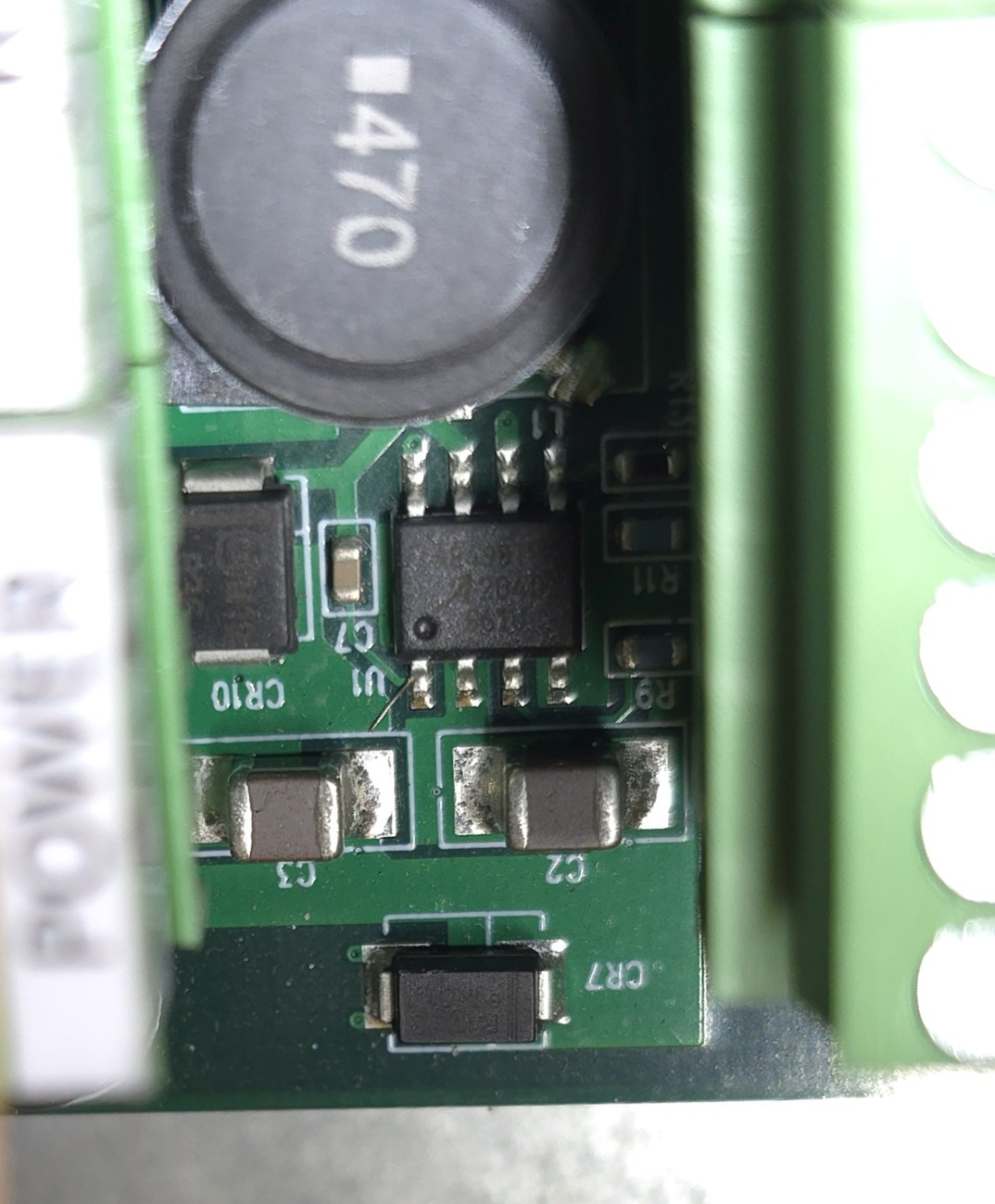

While taking a closer look at the board, I found a small piece of cut wire lying around in that area:
Could this have caused the issue?If not, what else could I check to resolve the 5V overvoltage?

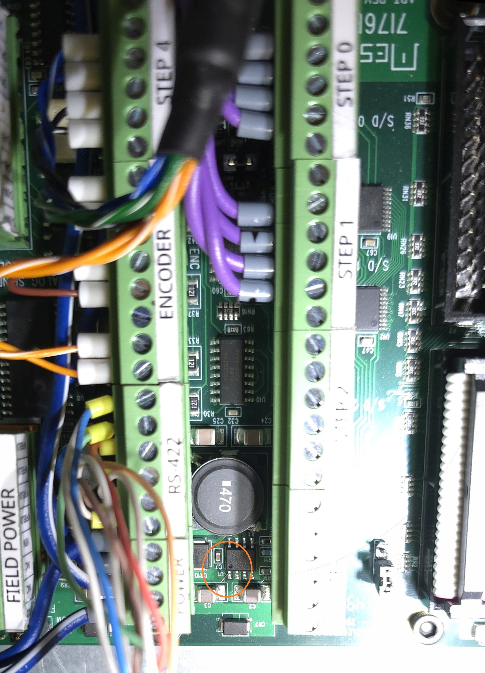

Picture 2, that looks like arcing across those two parts, moisture can do that, but the rest of the boards look like there is no moisture in quantities to cause that.

The shop is heated and very dry, especially during the German winter, so moisture is probably not the issue.

That wire is on a 5V regulator pin, so maybe related, hard to tell.
