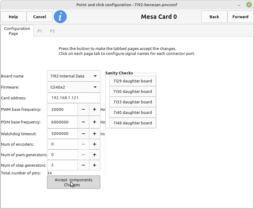

To setup pin 16 for spindle control you need to set the number of stepgens to
3 or 2 in pncconf to free up pin 16 as GPIO 5. I would also set the number of pwmgens
and encoders to 0, then hit "Accept components changes" to free up all GPIO
for any other outputs or inputs you need:
GPIO outputs need to be set to "GPIO Output" in the pin type menu:

I think there's a misunderstanding...
You don't need to change any pins.
If you use 7i92t_benezanx2d.bin firmware, the pins are
already correct:
already correct:
