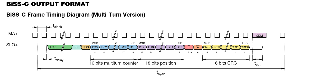

21 Jan 2026 02:50 - 21 Jan 2026 03:32 #341632
by sataran
Replied by sataran on topic Bitfile or help – Mesa 6i25 + 7i74 (BiSS-C) + 8i20 + 7i70/7i87
Ok so i progressed a bit But my raik060( biss-c/ssi signal) need a master clock in order to operate
(BiSS-C / SSI): DESCRIPTION: WIRE
VCC Power supply input Power Red
MA+ / CLK+ Positive clock input Orange
MA- / CLK- Negative clock input Yellow
SLO- / DATA- Negative data output White
SLO+ / DATA+ Positive data output Green
GND Ground Power Black
and i get some contradictory information. i read somewhere that only a 7i85 card could generate a clock and not other card like 7i76 or 7i74 ? if it is true that mean i have to rethink ma configuration.
For now i have added this to my main hal and it seams to be good, at least it don't crash
loadrt hm2_pci config="num_encoders=0 num_pwmgens=1 num_stepgens=2 sserial_port_0=0XXX biss_chan_0=start%1bCDS%1bmulti-turn%16sposition%18uerror%1bwarning%1bcrc%6u"
setp hm2_5i25.0.watchdog.timeout_ns 5000000
# Paramètres BiSS-C
# clock max : 10 MHz (10000 kHz)
setp hm2_5i25.0.biss.00.frequency-khz 8000
# Configuration pins
# Pins contrôle and diagnostic
net biss-start hm2_5i25.0.biss.00.start net biss-CDS hm2_5i25.0.biss.00.CDS
# Pins position
# Multi-turn (16 bits signed)
net biss-multi-turn hm2_5i25.0.biss.00.multi-turn
# Position principale (18 bits non signé)
net biss-position hm2_5i25.0.biss.00.position
net biss-error hm2_5i25.0.biss.00.error
net biss-warning hm2_5i25.0.biss.00.warning
net biss-crc hm2_5i25.0.biss.00.crcAttachments:

- sataran
- Posts: 11
21 Jan 2026 10:45 #341655
by sataran
Update, i just received the (almost) final plan for this project.
mesa part:
6i25 => 7i76 -> spindle = 1 motor
- >field output 1 = motor on/off
- >field output 2 = motor on/off
? -> encodeur biss-c ?
=> 7i74 ? 0 => encodeur biss-c (RAIK060 by vishay) ?
1 => 7i87 -> 6 temperatures captors
-> 1 pressure captor
2 => 8i20 -> main motor
Encodeur:
- i use an encoder raik060 from vishay (doc bellow) it seem to need a clock from the master card and maybe a signal? start?? in order to operate.
Project non mesa part.
This project is not a cnc but a system to test pieces it is composed of 2 part:
- The first part is 1 motor cyclic powered by 8i20 in team with the biss-c encoder and a pressure captor in team with the motor controlled by 7i76 spindle
- The second part is the cooling system that will work in continue.
this is 2 motor that will run full time en 4 temp captors for security
QUESTIONS:
-Concerning the signal biss i am flexible on what part to use, ether the 7i76 or the 7i74 depending on what may be possible or the easiest and i saws where was an encoder part on the 7i76U was curious if it was possible to use that?.
-If we keep the signal biss-c on the 7i74 it is important to note that i need to have most of the 7i74 port to work normally and only the port 0 has a biss-c socket. If it is not possible i can use a second 6i25 and 7i74 dedicated to handling the signal biss.
- i still dont have any signal from or to my encoder, is their something to do in order to generate the clock signal or to make it react? I cant seem to find details about this part in the forum (i still have a lot to read so i am not loosing hope) and chatgpt or other ai keep telling me that it is impossible or to use non existing driver like hm2_biss.
I added the doc of the encoder i am using, it is the Multi turn version, information about the signal are page 15 and 16.
Lastly is there any doc about how to configure a framework? Even if i cant do one myself, knowing what is happening would help me to know what information i need to give in order to get a bitfile adapted to my configuration.
mesa part:
Encodeur:
QUESTIONS:
