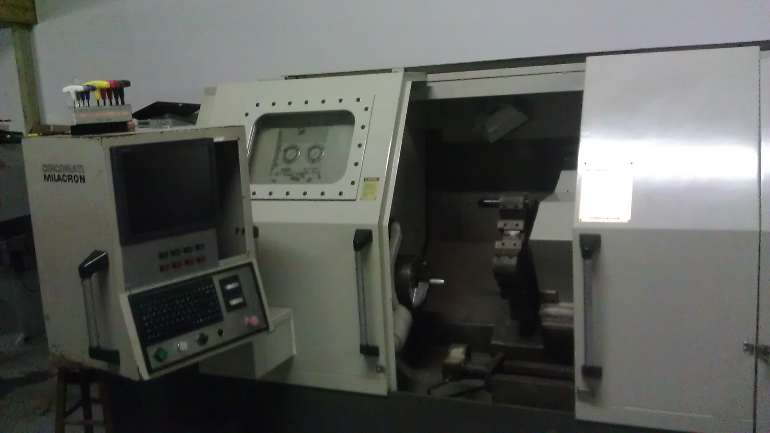

Ive had this Cincinnati for about 7 years,of which it ran for about 45 minutes!! A few years ago I put a Delta Tau windows control on it ,shortly thereafter the Siemens axis drive stating acting up.The machine was parked for two years.
I fixed the drives last week and decided the DT was more trouble then it was worth. The machine is very similar to another lathe I did with Emc,so I ordered a 5i25 and 7i77 and its gettn Emc'd. Its a modern machine so its really plug into the existing wiring.

Thank you,Ill post pics and some video as I get things up and run'n. I replaced the Siemens spindle drive awhile back and hopefully got the axis drive fixed.The machine uses 25 pin connectors for axis signals,so it is plug and go.The i/o was wired to opto racks(originally to the acramatic plc), it is being replaced with a 7i77 and a 16 space opto rack for out puts.The turret plc is already written,this machine is very similar to my Hardinge,so most of the work was done.
I ordered a 7i84 for the operator panel(which isnt in the pic). As soon as it does something ,Ill post it!!

On this lathe I used a Hitachi SJ300, 20 hp model. Hitachi doesnt make the SJ300 any more,they make an SJ700 (which can be run in vector flux mode)and a WJ200. The WJ is a neat drive,I recently put one in my Fadal with a permanent magnet Fanuc motor. It will run either induction or Pm motors. With the encoder card,you can have feedback to the drive( not on pm motors though). According to Hitachi,it has 150 % torque at 5 hz!!. I got it thru Ebay,7.5 hp model,about $700. I had to add an external braking resistor,as the regen from the motor gave me a MAJOR overvoltage alarm on decel. They are definately worth checking out. Your BP has a yaskawa drive? Check the caps in the DC link and on the main board,notorious trouble makers....

but if your friend andy is getting 6000rpm in Vector mode that sounds good option. as i know motor in CHNC 1 at least is 5.5KW and 6000rpm , (5000rpm max on head stock due to gearing)
