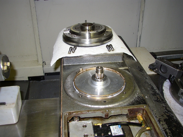

Rebuilding a Hardinge CHNC Turret

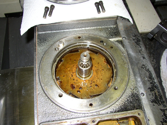

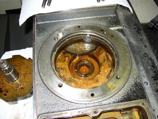

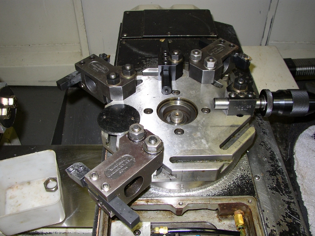

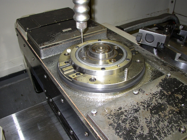

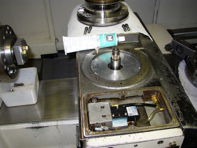

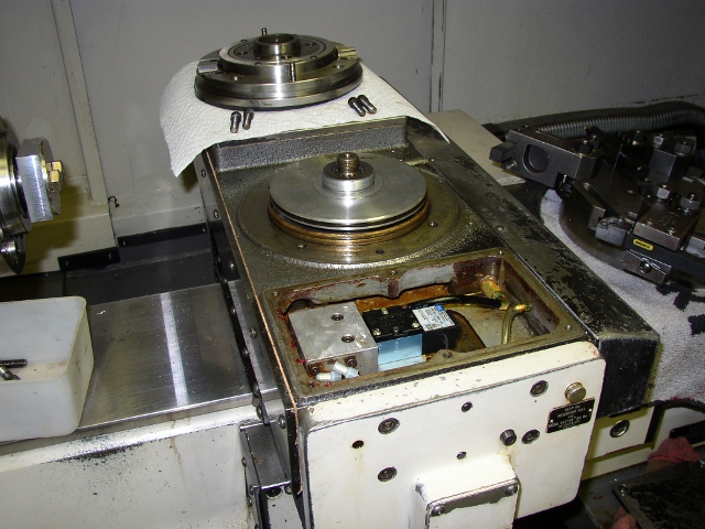

Hello John,
Great job, and great documentation of the work. With that step by step no one should by shy about tackling the job if need be. Of course it helps to know you are there if trouble shows up!
Rick G
Rick G
- BigJohnT
- Posts: 3981
- Thank you received: 994
26 Apr 2010 06:34 #2719
by BigJohnT
Replied by BigJohnT on topic Re:Rebuilding a Hardinge CHNC Turret
Hi Rick,
The only trouble I ran into taking it that far apart was getting the ratchet timed. What I had to do was assemble all but the tool plate then fire the lock then the lift and rotate to bring it into alignment. Release the air from the lift and rotate then install the tool plate. This got me into mechanical alignment. Then I just spun the magnet around the encoder till the correct number showed up in my HAL watch window and locked it down.
John
John

30 Mar 2024 21:34 #297258
by lavrgs
Replied by lavrgs on topic Re:Rebuilding a Hardinge CHNC Turret
I am at the point where I need to do this mechanical alignment. I am not sure exactly what needs to get aligned. I am able to raise the piston but it will not spin. Sounds like I need to unlock the stop and bring the turret around so the stop aligns...?
