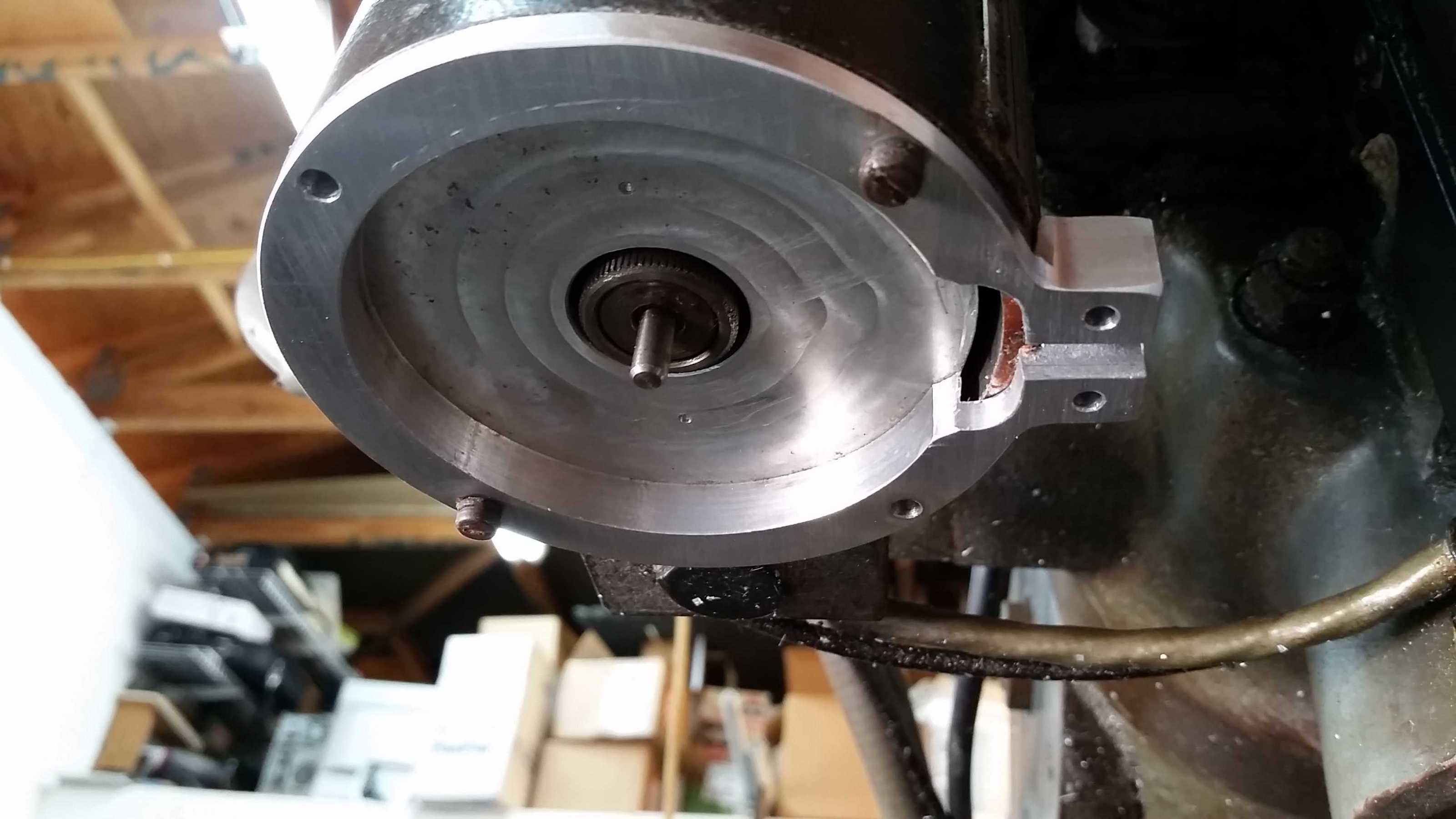

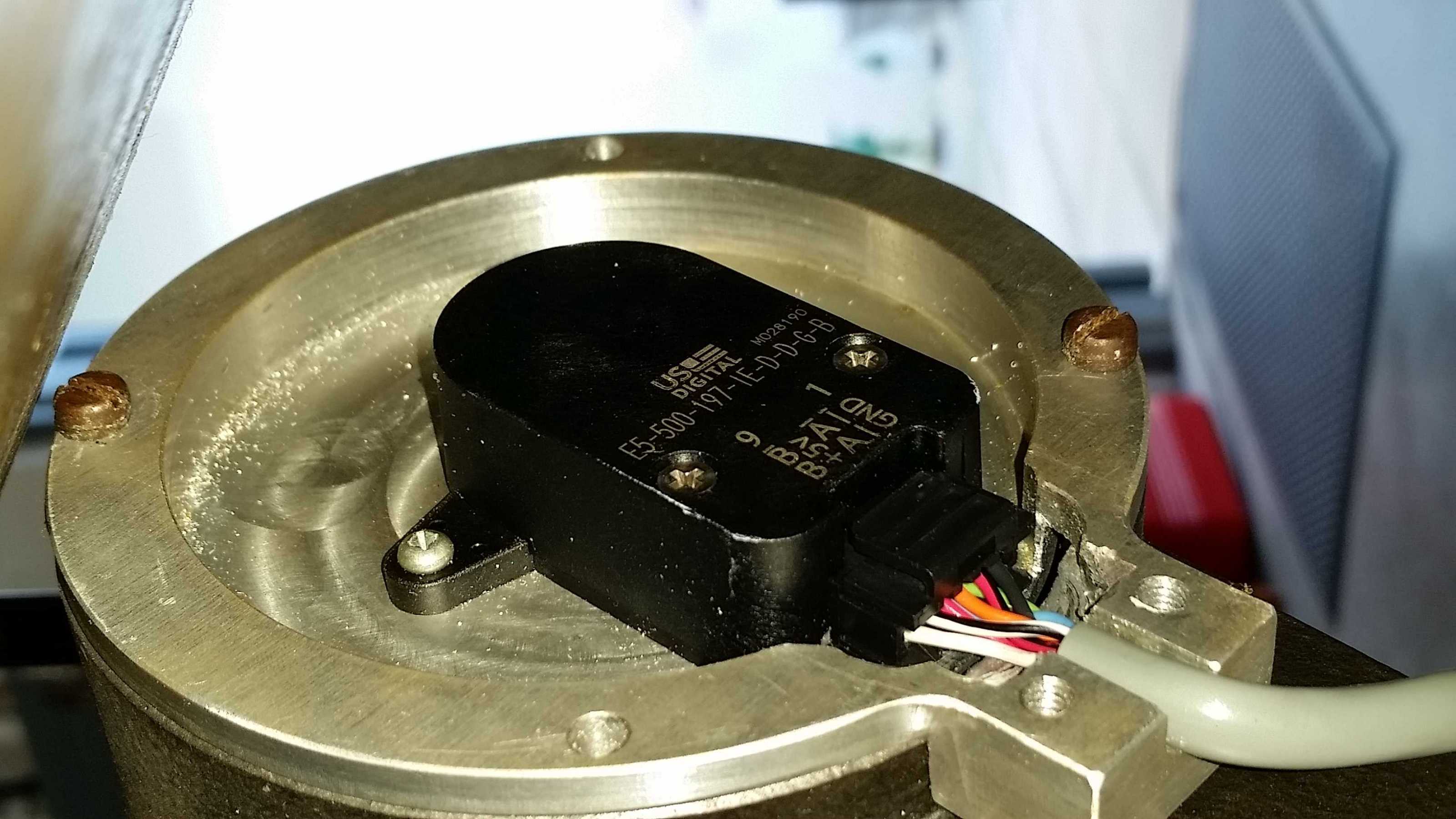

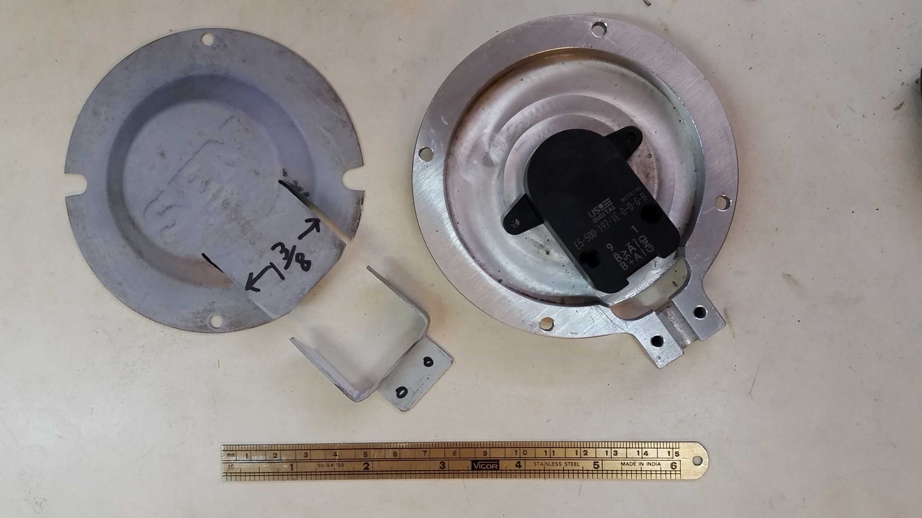

19 Dec 2015 23:58 #67164
by joekline9
Replied by joekline9 on topic Anilam Crusader linear scales
I ditched the Glenteks and use AMC 20a14. I kept the tack feedback and used the original Anilam glass scales (.01mm res. Approx .004 inch)
I could not get the servos to completely stop. They had a very slow drift do to no dead zone in the amps. It was very usable but I wanted it better.
I have recently added U.S. Digital rotary encoders to get higher res. I made adapters for the SEM servo motors so I could keep the tacks.
I bored a relief in the back of the encoder base to clear the tack armature. My SEM motors have a 5mm shaft extending past the tack.
Encoders: U.S. Digital E5-500-197-D-D-G-B
