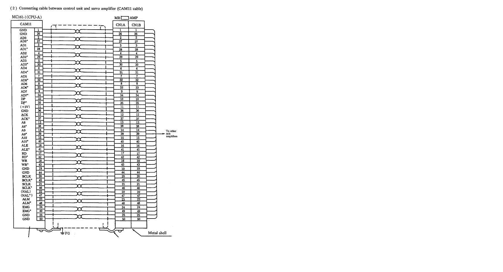

Hi everyone,
The task is to upgrade a Mazak VQC 15-40 to LinuxCNC and I did get to a interesting problem.
The machine use MR-S amplifiers witch seems not to have any analog input. It only has has a BUS-LINK and a hex rotary switch to select the bus address.
Is three a way of interfacing this amplifier with LInuxCNC?

without obtaining the manual or finding more information, regarding the amps , it would be a needle in a haystack
lets see if anyone knows more , although with some information it would probably be a requirement to write a driver
does this link match the servos , as it does seem to have analog capability at first look
cncmanual.com/mazak-mrs-mrs1-troubleshooting-guide/

J7-pin 6 AN: Analog input terminal (used only for testing).
I will test it to see if it moves . As far as I remember it does require the initialization from NC to start.
Razvan

- Posts: 18111
- Thank you received: 5330
15 Apr 2016 16:54 #73351
Replied by PCW on topic Mazak VQC, MR-S amplifiers LinuxCnc interfacing?
Ha, that's a whole 8085/8086 like bus with differential signalling
probably possible to interface if you had a technical manual (with register map etc)
whether its worth the effort is debatable

I have two options it seems.
Use the Argon driver with the actual HC83S permanent magnet AC motors if they tune normaly or change the motors and the drivers with MR-J2S series , 750W type servo/amplifier pair.
The MR-J2S, 750W motors have the same flange and are half in length.
I have both options in the workshop , I am unhapy trowing away three pairs of MR-S 1kW motor/amplifier that are dual closed loop with addon card for 5 micron resolution. Both motors and ballscrews have 5000ppr encoders .
